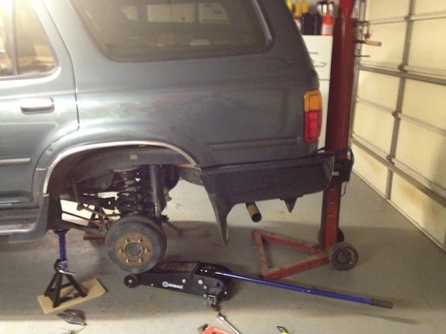

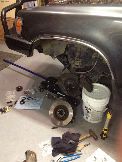

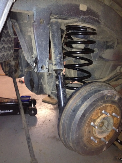

U can definitely tell why i decided to get this done. I was pretty slammed in the rear and towing my duck boat around is about the max load this thing will do without riding on bumpstops. I also decided to change brake rotors in the front, talk about a pain. While i was in there i replaced bearings and pads. If you guys have any questions, feel free to ask.
its a long process just to change a rotor, and i feel like the fsm torque values are off. there is way too much preload at those values and i feel like that could actually affect mpg and bearing life. I went with what i felt was tight but still able to actually turn the wheel.
