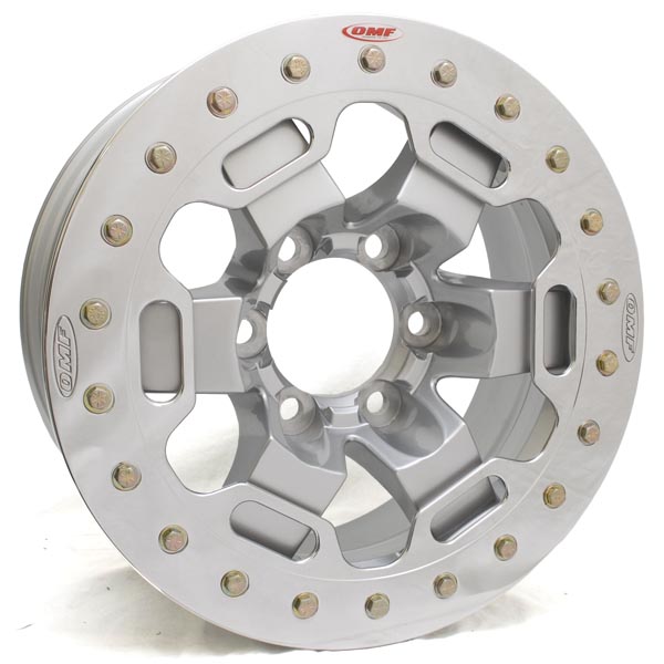

You know when you convert a "standard wheel" to a beadlock you add 1" - 1.5" to the over all width of the rim..... As the "lock ring" gets milled and welded onto the outer lip of the wheel, so your tire now sits outboard of the old bead location.... At least that's how it's done on a steel wheel.
OMF Performance Products | Beadlock Conversions
That would put you right where you need to be.... And you'd be rocking a custom real TRD one of a kind wheel....
Just something to consider. Here is an FJ wheel converted.
-A

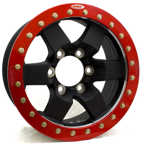

Here is another FJ wheel, this is from the first company I found with a Google search BTW.
First. It wouldn't be street legal. Secondly it wouldn't solve the back spacing issue that exists with what we would need the rim to do.
Street legal.... Well that's a "grey area" for sure... Most think BL's are not street legal unless stamped with a DOT stamp....
However, I have quite a few close buddies in various LEO, and from what I've researched and read in the code books there isn't anything that specifically says you can't run BL's on the street. Most LEO who hand out those tickets aren't familiar with the specifics around the infraction. And when and if you took it to court it's been dropped. This could of course vary from state to state...
The safe bet is to get one with a DOT stamp, no road side question there when stopped....
The BS.... Ya.... Ya got me there aside from running wheel spacers. And personally I'm not a fan. Even tho I have them on my 5th gen.
