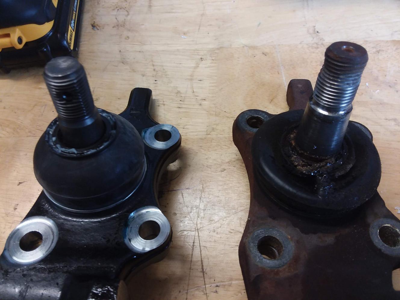

Just do it. Don’t become one of those photos.
The ball joint on the right is an AC Delco 555 branded ball joint. Note the differences in the bolt mating surfaces. This ball joint had 40k miles and the only off-road action it saw was about 100 miles of beach driving and NEVER in the water. This ball joint was LOOOSEY GOOSEY. I could move it around with light pressure from my pinky.....
The ball joint on the left is a Toyota Genuine Balljoint. Stark differences. I was too stupid to know better when I first got this rig.

There is a TON of very detailed information on this very forum about WHY they are a failure item in this particular application. It has to do with design of the system. But failures come from the bolts as often as not (though, this seems to be mostly attributed to reusing them).
I replaced mine at 190k (when I bought the 4r form the original owner, non-lifted, most off-road was a gravel driveway), "felt" fine with the FSM test... boots looked fine when installed.... both were torn and holding water once removed with a lot of rust and movement evident. 200k miles is the outside limit for a Street-only, non-lifted truck (or rather, 200k miles/20 years... if you do 200k miles in 10 years, you might be fine).
At this point, any original-installed ball joints should be replaced simply due to AGE. Past that, it's a study in use-case. I'll probably stick to 15 years/150k miles myself for a 99% street/non-lifted use (and since I've only put ~5k miles on it in the past year, that'll be a time-related replacement).
