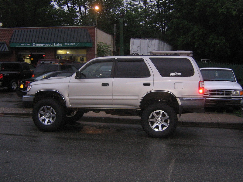

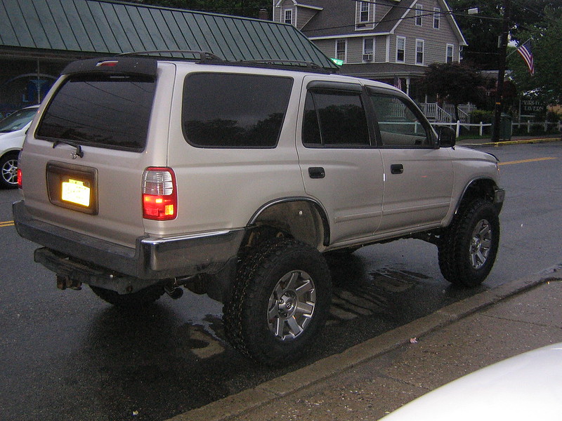

Fresh install:
IMG_0912 by Mike Campbell, on Flickr
IMG_0914 by Mike Campbell, on Flickr

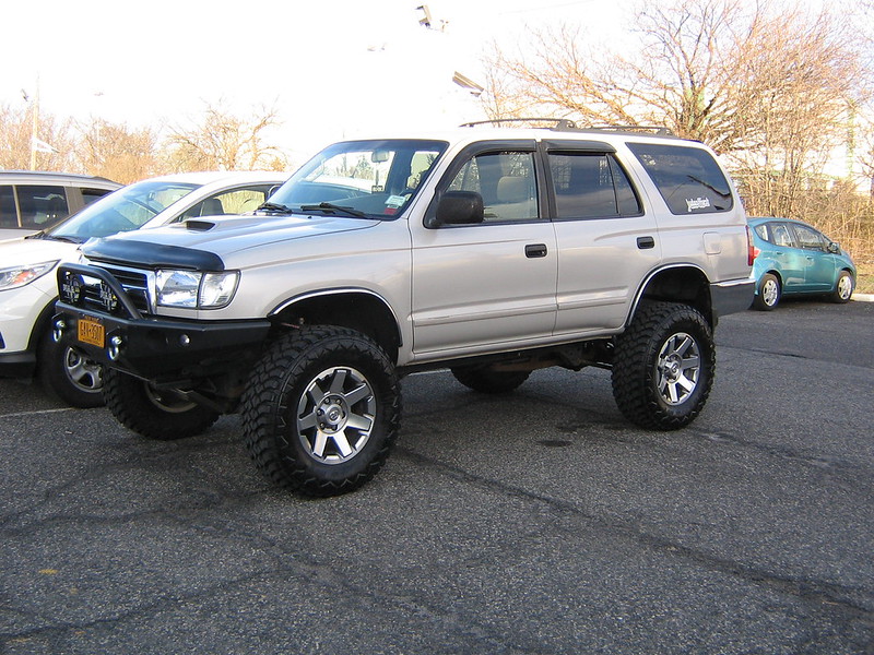

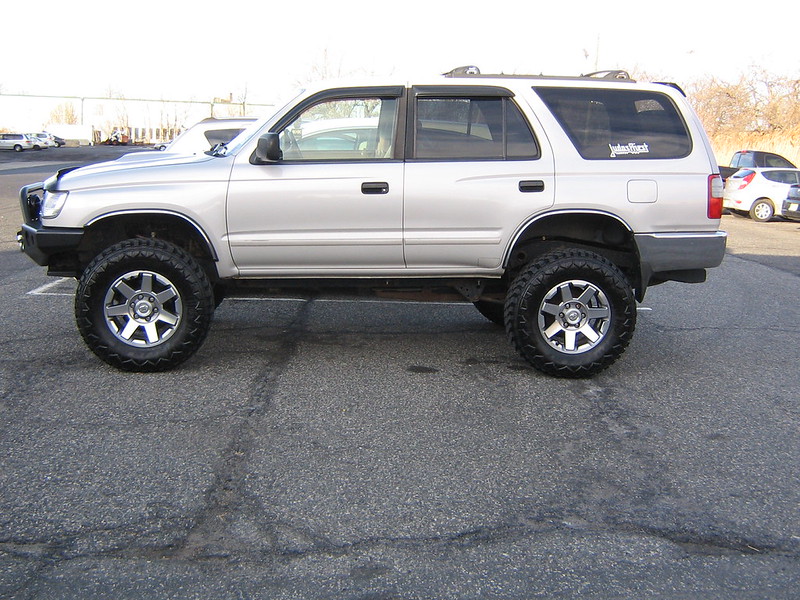

Maybe 6 months to a year later:
4Runner Car Wash 021 by Mike Campbell, on Flickr
4Runner Car Wash 020 by Mike Campbell, on Flickr
