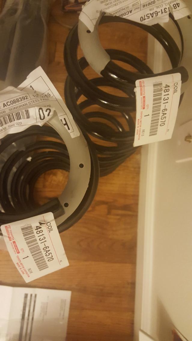

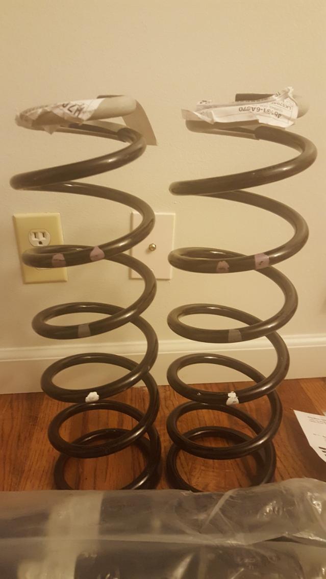

I just got my Sanoran Steel 1.2 Rear only lift last week. Both of my coils are color coded:
Double Purple / Grey / White.
Both are the same part number: 48131-6A570.
Hope I don't lean. LOL.

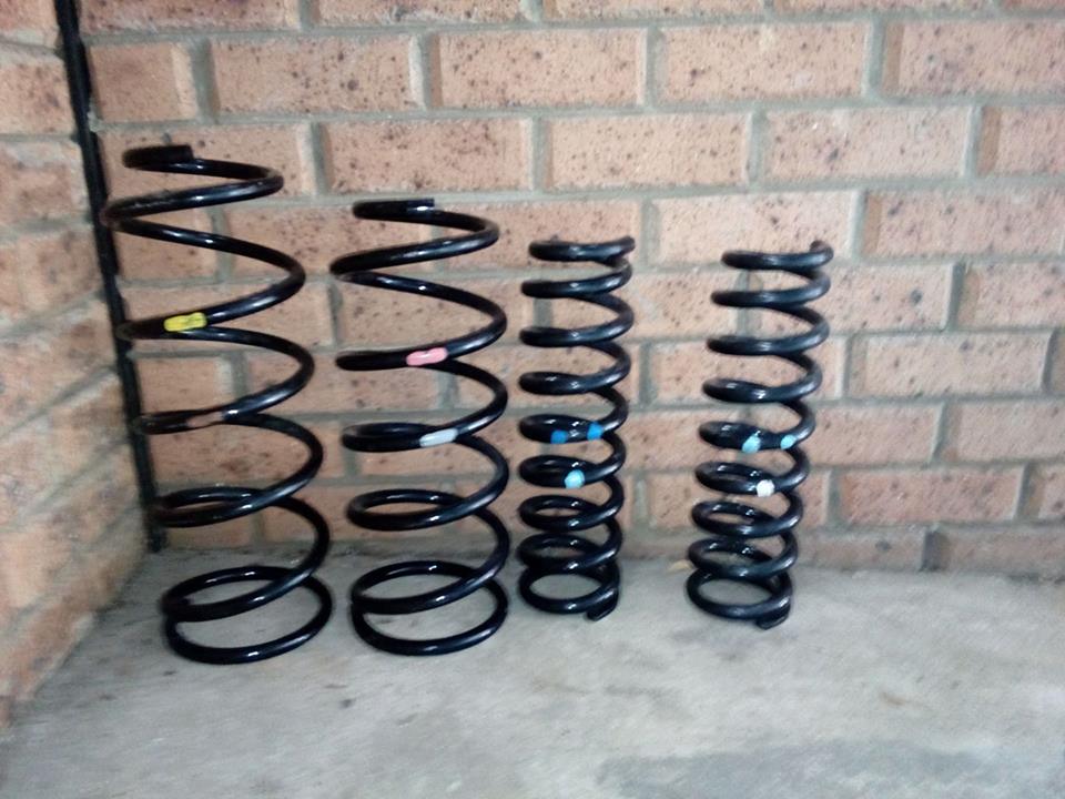

Can anyone point me in the right direction as to which springs these are? They don't appear to fit the color key legend that is passed around here. Local shop sold them to me and said to try them, currently waiting for my 5100s to arrive.
Mine are posted below and have heights of 20.5" and 20.75"". They both appear to count around 8.75 wraps but the colours don't seem to correspond. Can anyone share any insight? My colours seem to be Orange Grey White and Orange Orange White. Assuming it is orange since red isn't on the key.

did you get them installed? Do you have lean?
I had them installed about a year before swapping them out for ARB OME 861's. Mine did not lean. I suspect that the year 4runner might have played some part in what color code LC coils gets when they order from SS. Their SS 1.2 rear lift is broken down by year pairings. 1996-2000 is one package, and 2001-2002 is another. I know a few others had to use trim spacers to level things out. I was lucky and did not have to do that. If I would have stayed with 265/75/16's, I would have not changed a thing. Probably would have been easier too.. lol.
