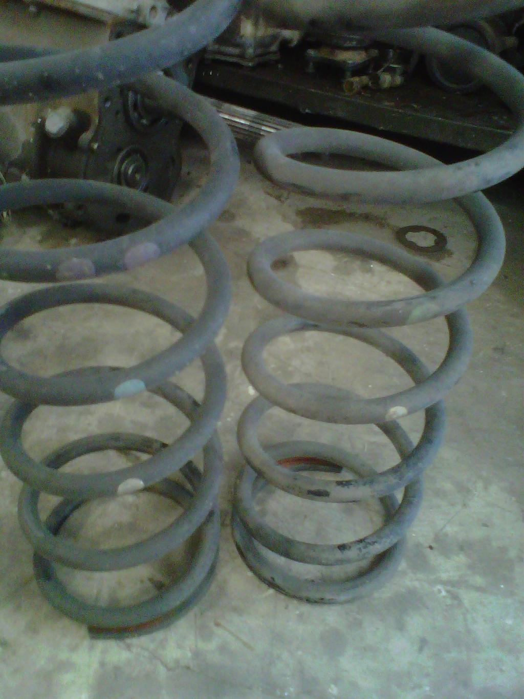

So I got some OME 60027 rear shocks, will these work with the LC coils? Also, I might get some LC coils from a 97 LC but the sizes are different on each side? The longer one is 19 1/4 inches, and has two purple dots a green dot then a white dot. the shorter one is 19 inches and has two purple dots a blue dot then a white dot. And on the front, I want to use some 2004 Tundra 4WD coilovers.
Any input? What else do I need? Thanks again!

No clue on the fronts but Im sure someone will be able to chime in there but can you tell us how many wraps the rears are? Can you take a picture that shows the whole springs? I would say thought that you hould run the taller spring on the drivers side. Are the front coils standard tundra or TRD? The nice thing about the TRD's is that they are a progressive spring and so ride a little nicer on the street. But honestly my buddies Tundra (nonTRD) rides great. You are getting everything together its gonna be sweet.

It looks like you have double pink, light blue, white 7.5 wrap and another with purple, green, white 8wraps
so the Purple, green, white would go on the driver side and you should be even...

Just put the longer on the driverside unless you like big women. lol
You're not gona notice a 1/4 difference
Thanks Sam. Those are 8 wrap LC coils. The guy selling them took those pics. I know, not very clear. But I'm still a bit concerned about them not sitting level. That 1/4 inch could make a huge difference once they are in. And those coilovers, the seller does not know if they are from a TRD Tundra, but they do have more coils than another set I was going to buy of the same year. Will I need spacers for the front? Thanks for all your help.

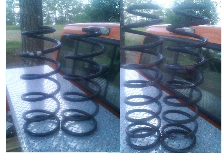

I found my pics that show the difference between front and rear LC coils.

I need to know your color coding, and maybe post your measurements too...

So in doing my research lately I've at least come up with the years that some of these coils come off of...
19.25” Dbl Purple, Dark Blue, White 7.5 wrap – 1994 LC (D side); 1997 LC (P side)
19” Dbl Purple, Light Blue, White 7.5 wrap – 1994 LC (P side)
19.5” Purple, Green, White – 1997 LC (D side)
And I'll actually have the info from another 97 & another 94 soon.
