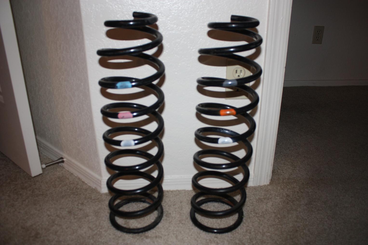

LC coil spring Color codes
9 Wraps: Both 21"
