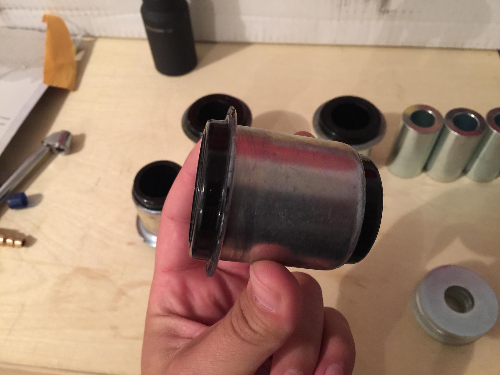

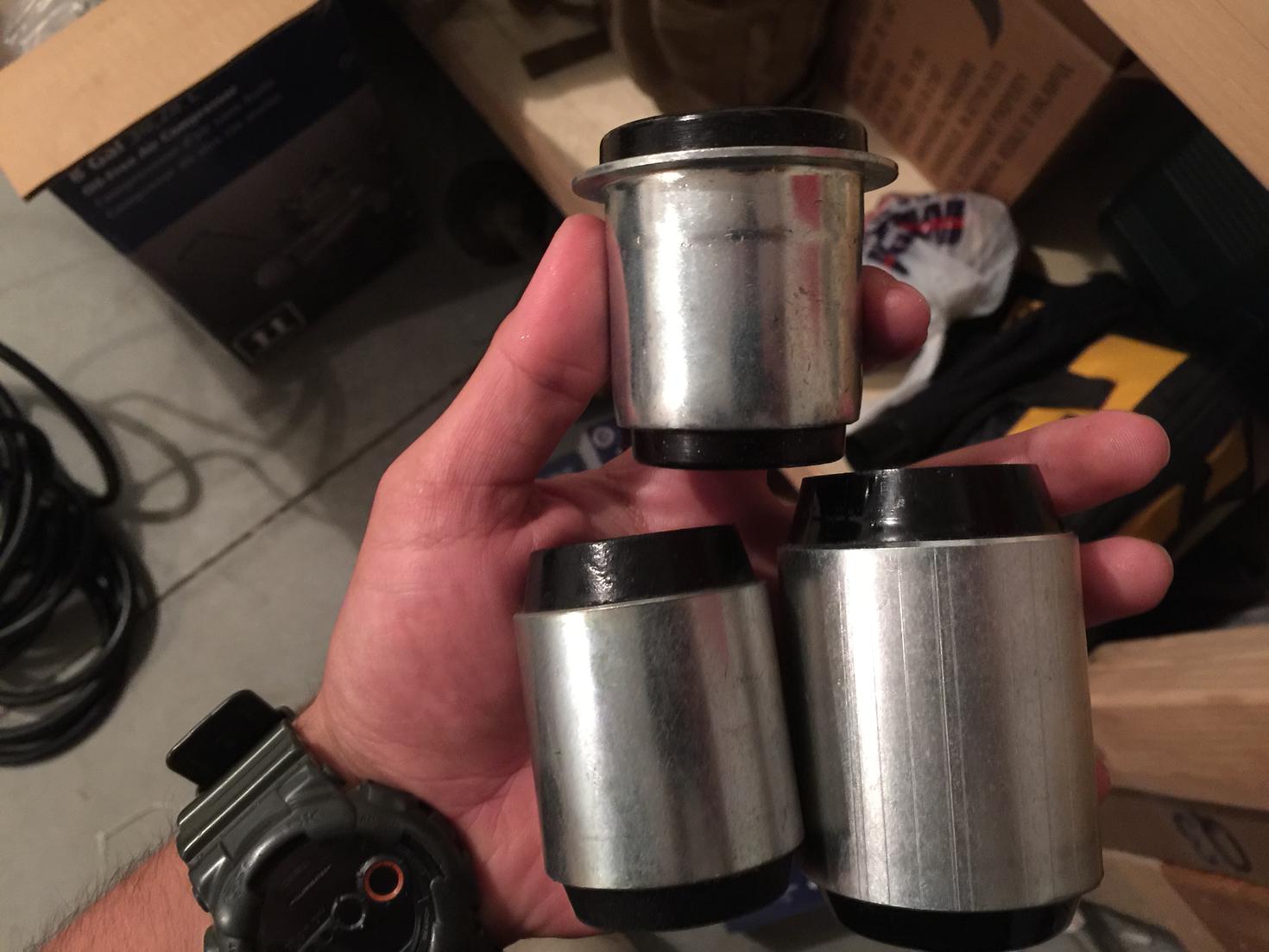

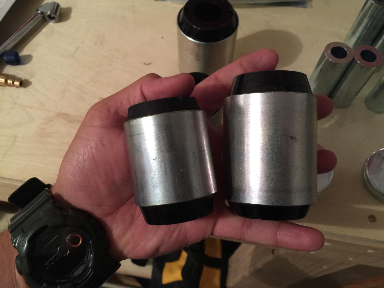

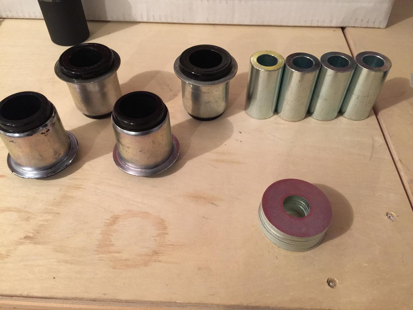

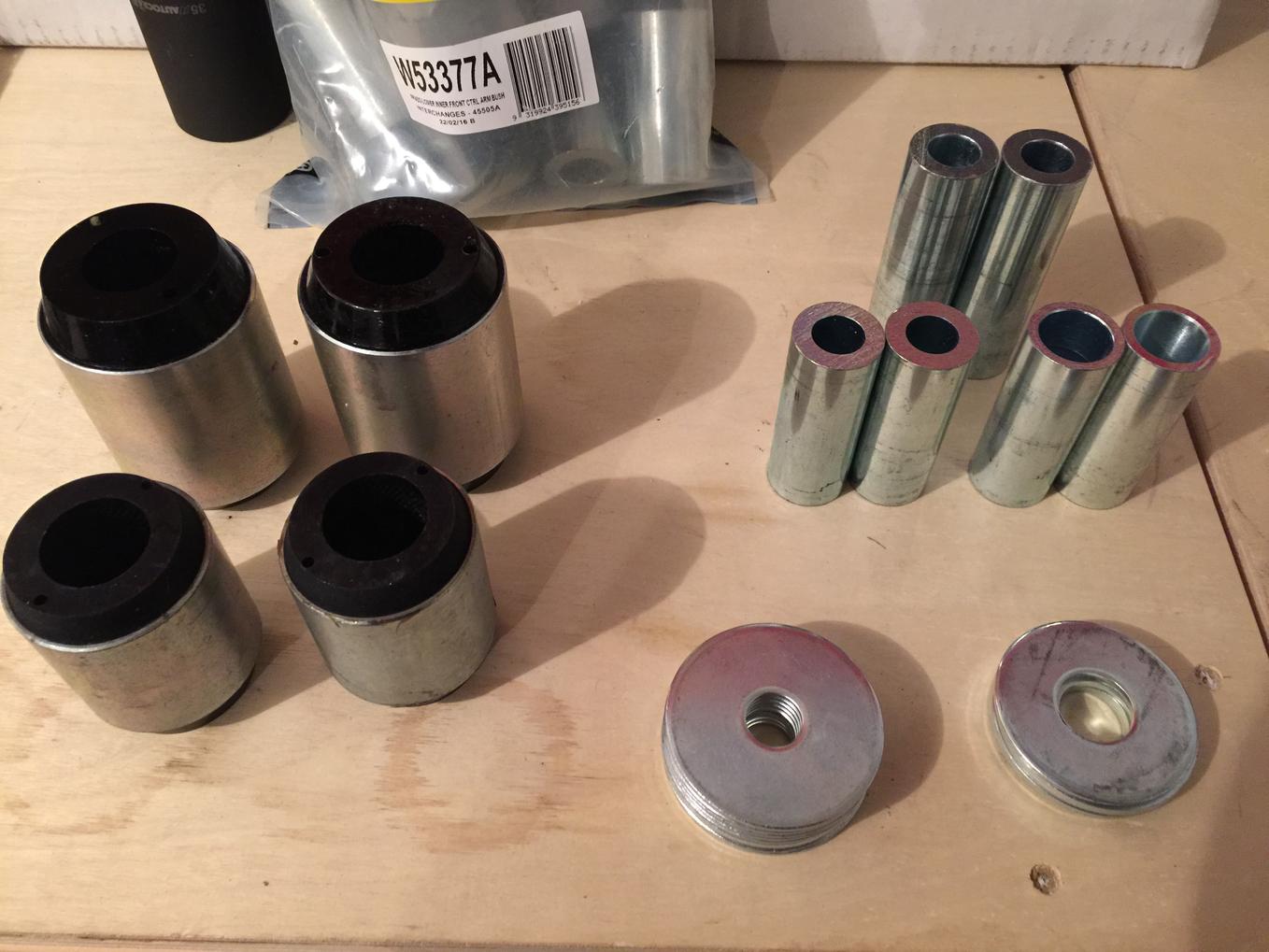

So... I got both sets in the mail the other day and they are literally two different types of bushings. They don't resemble each other at all. So I'm not sure which one to go with as I have not yet pulled my control arms off yet. One set has a lip to it on one side and the "complete" doesn't have any lips on the bushings. This is pretty confusing. :confused:
One set probably came with the cups and one without. Can you post a couple pictures?
Yeah I can. They are still in the bags because I want to be able to return which ever one I don't need.
The forward and rearward bushings will be different. In the set, you should have two different types.
Some bushings, like the polyurethane ones require that you reuse the stock steel cups and washers, then reflare them on. However, some come as a whole drop in replacement.

Yeah so I have read some of those in the past and it seems like the cheaper set (W53377A) is the correct one. All four of those bushings are the same size where as the more expensive (W53312) set has two different size bushings, plus more inner sleeves.
