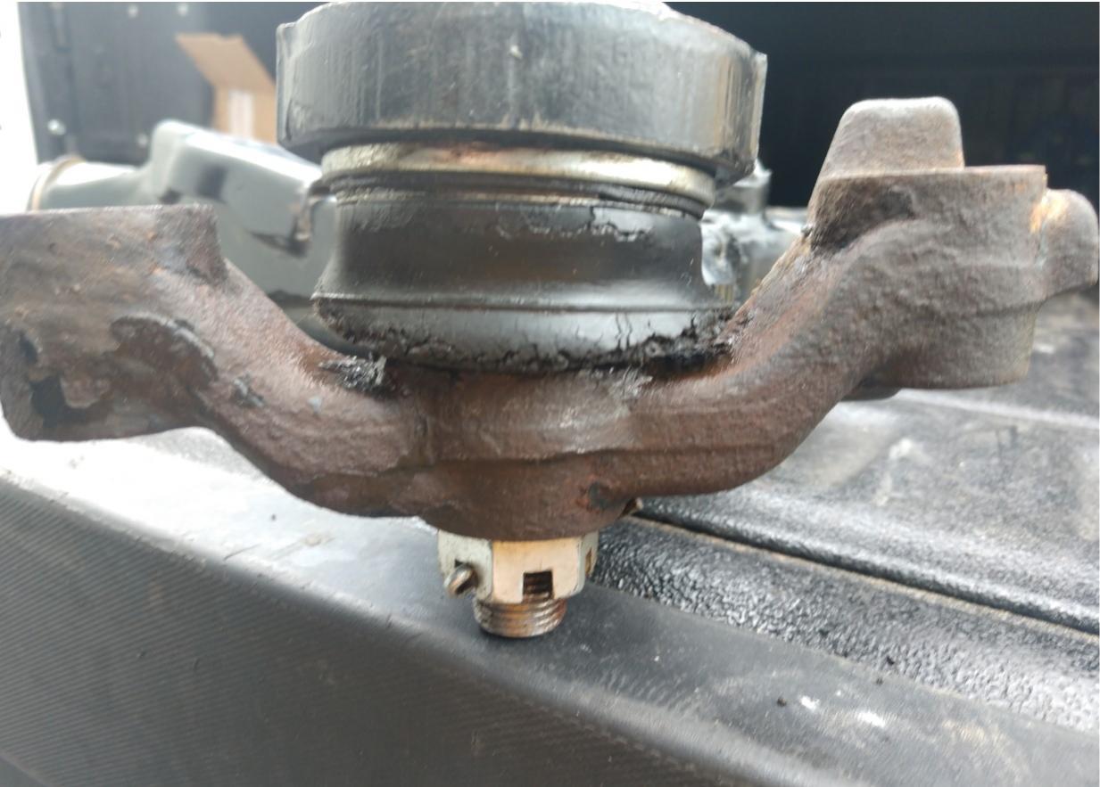

I was warned. This is the boot on a six month old LCA from NAPA.

One of the dust boots just failed, but they aren't made for any lift, and I have a daystar 2.5 level kit which destroyed my end links as well. I got a new boot at napa for $8 and I'll remove the daystar for better driveability since I'm 99.99% on road.
