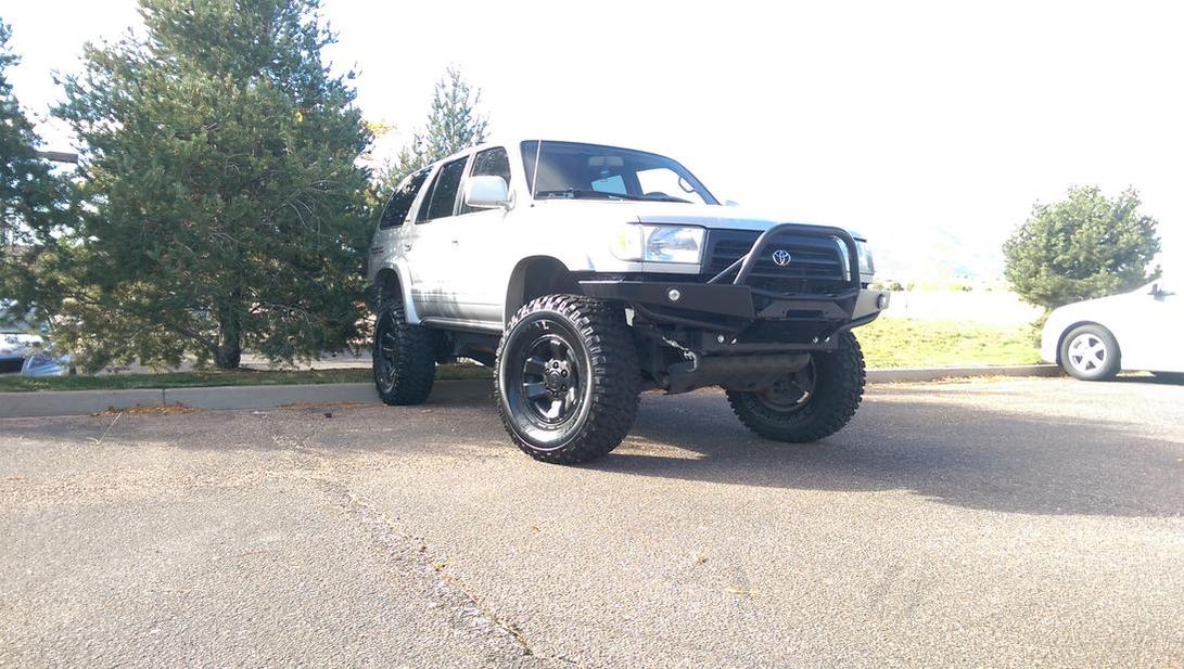

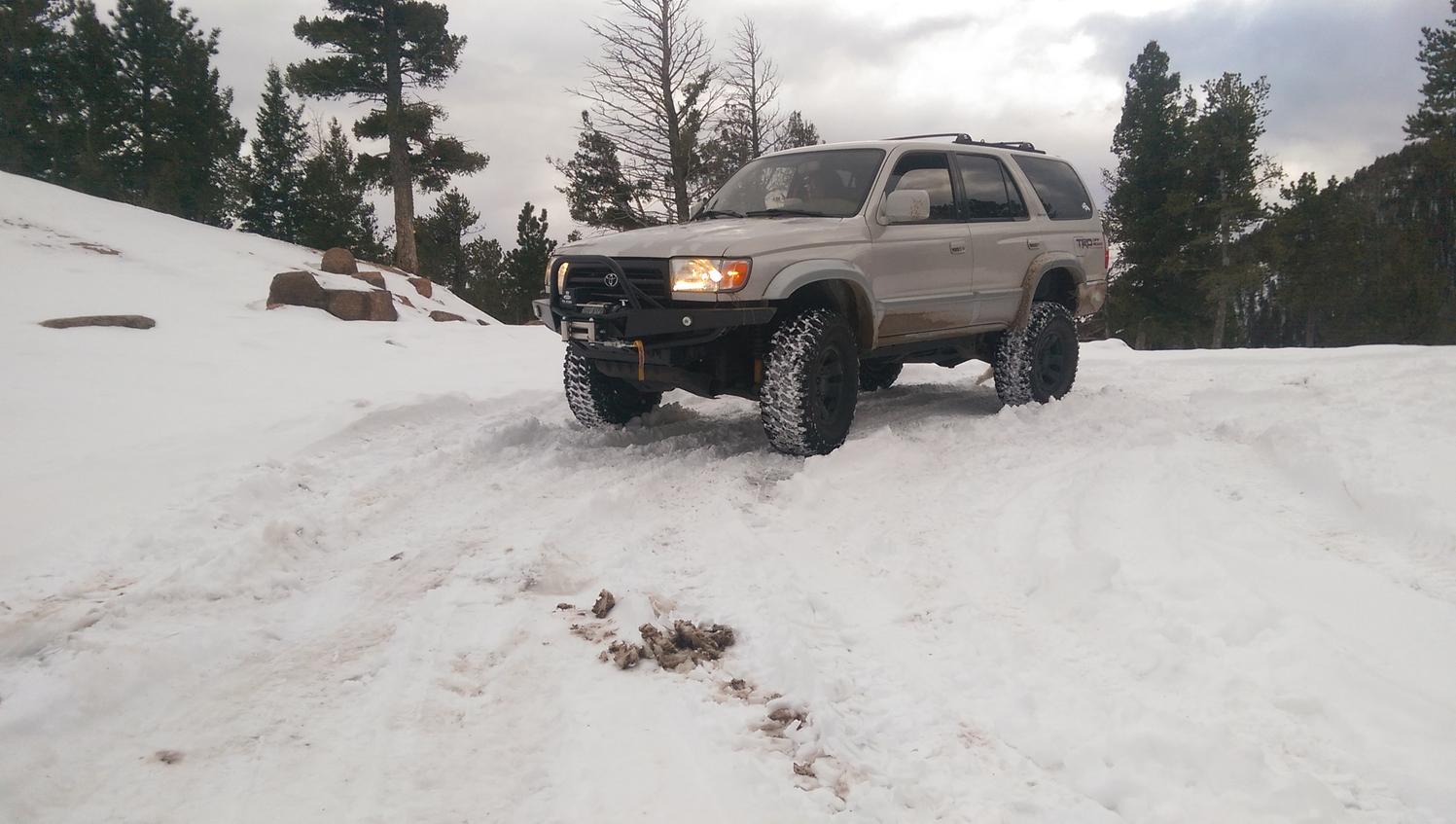

Well I sure hope this is the case for me. I thought about the polys but didn't pull the trigger. What kind of lift setup is on your rig? Got a pic?
Sent from my SM-G935V using Tapatalk
Its in my sig.
OME 881's w/1" lift sleeve (3" front lift sagged with bumper/winch)
New LC 7 wraps w/LC Tokico OEM shocks
