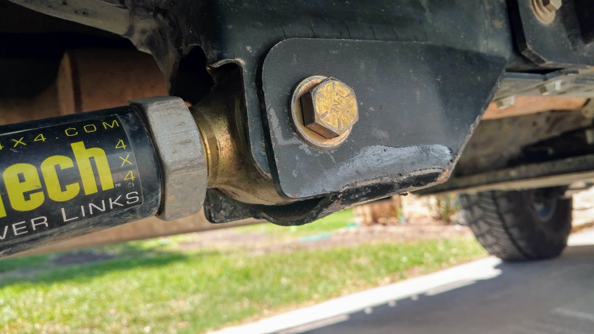

Hey which rear lca frame skids are you running? The Total Chaos skids look nice. I'll be installing metal tech offset rear lca's for more downtravel and would be interested to know if there are any clearance issues with the skids.
RCI with minor mods to clear the johnny joints. They are the best design but do require a tweak to clear the big joints. The TC ones are not very good at all.
You have to heat and arc the bottom section like I did in the pic..
