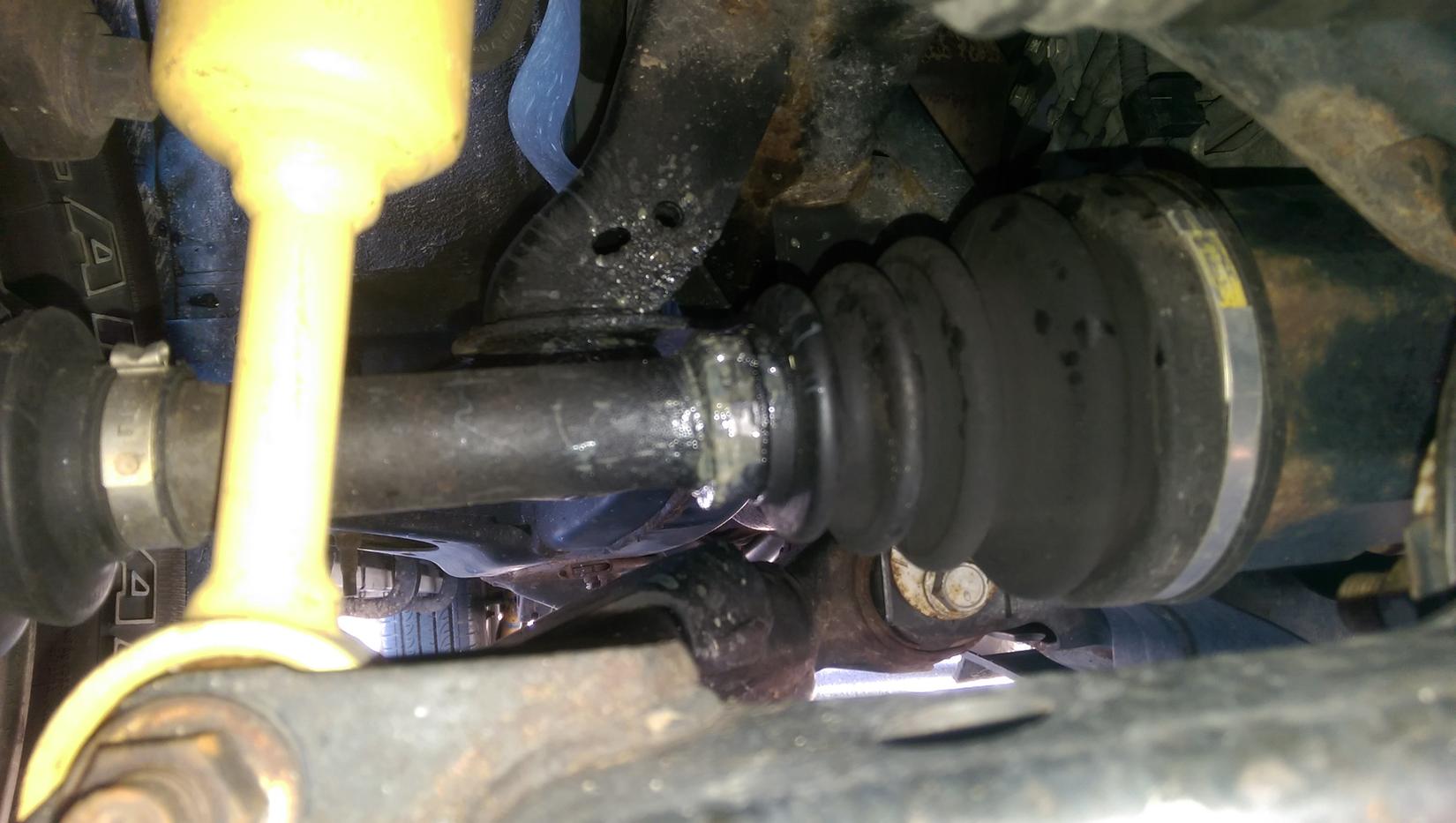

With 145K miles on the original boots, I'm starting to think the inner boot is starting to fail on both sides. Interestingly enough though, the small clamp is still tightly connected to the shaft, and isn't sliding back and forth. Am I to assume the grease has just disintegrated over the years/mileage and is seeping out?

I just did mine last week. Plenty of posts on the subject that you should search. Inside was a milkshake type mess. Certainly not a great situation for what should be properly greased. If your boots are ok, order the stainless clamp kit on eBay (that's how common this is), but some good cv grease, cut your old band carefully, clean out the old mess that looks contaminated by water (I used brake cleaner and an air compressor, let fully dry, repack with grease, seal the boots carefully with your new clamps, and clean up the mess. Took me about 4 hours because I tried to get every bit of the old grease out to avoid any possible incompatibility between old and new grease. I used Redline CV-2, and one jar was plenty for both inner joints. Good luck!

Thanks guys! I figured after lurking around these forums for a while and 140K miles, the leaking boots were somewhat a foregone conclusion I'd have to tackle at some point. The interesting thing is that all the clamps are tight on the shaft, so I can't imagine why I'm seeing this if the grease is in tact inside the boot.
That said, is this just normal deterioration of grease (in general) after years of use, condensation and temp variations? If it's a 'milkshake' inside the boot, it's not so hard to imagine some of it seeping out at this point, regardless of how tight the clamps are.

I think it's normal for a tiny bit of grease to seep out, and it might be greasy right next to the clamps. But if lots is coming out or if water is getting in, then that's a problem.
There is a lip on the inside of the boot that fits in a groove on the shaft. On mine the rubber lip somehow wore out, so the clamp was still tight, but the boot could slide/twist a little, and grease was coming out. I couldn't use an OEM clamp because it had no option to go any tighter. They only have one setting. Instead I used a hose clamp that I ground down to make it narrow enough to fit properly.

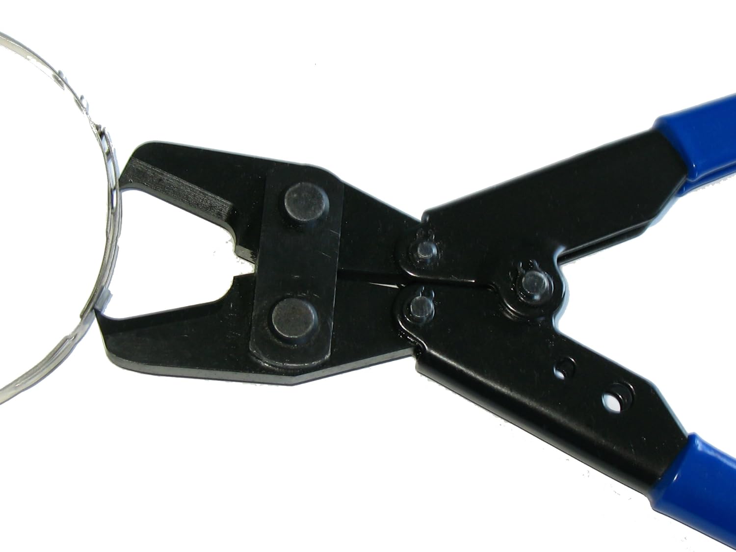

I bought 2 used OEM half shafts and all 4 boots need to be replaced. In addition to the Toyota 'Boot Kit', I bought the following supplies from amazon:
Clamp Pliers: http://www.amazon.com/gp/product/B0002SREPY?psc=1&redirect=true&ref_=oh_aui_detailpage_o09_s00
The Clamps: CTA Tools 4240 CV Joint Boot Clamp Set - Strap Clamps - Amazon.com
The Banding tool: Amazon.com: OTC 4623 CV Joint Banding Tool And Cutter: Automotive
I haven't used either of these yet but I'm told this is the trio I need to reband the boots without going the hose-clamp route.
