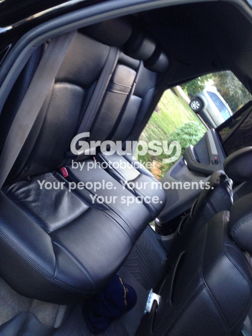

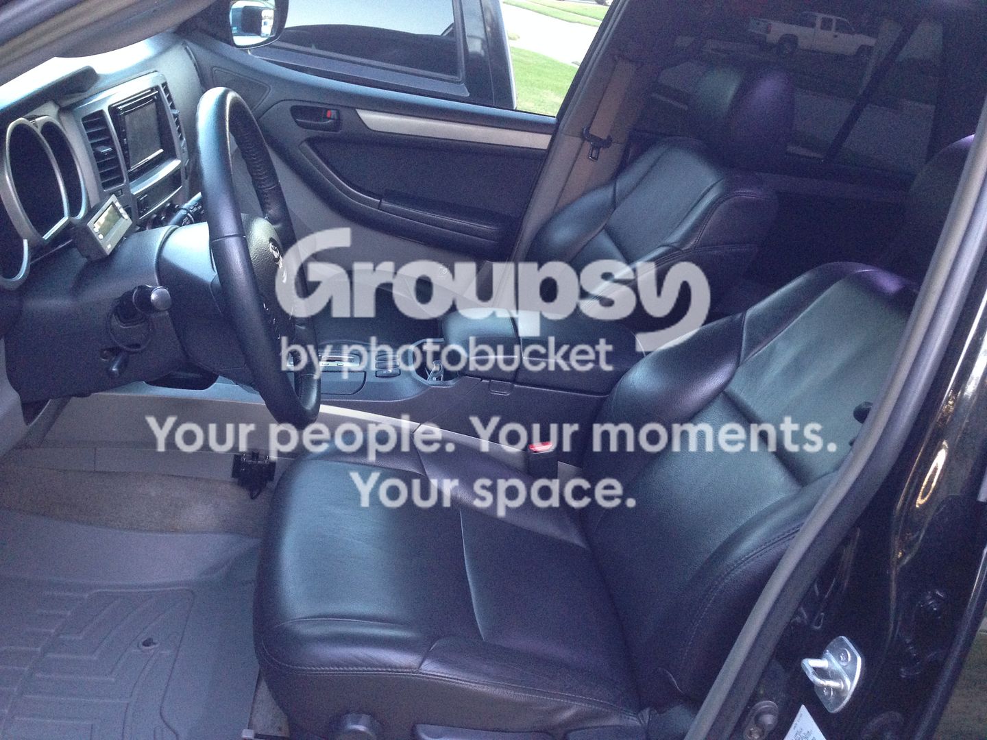

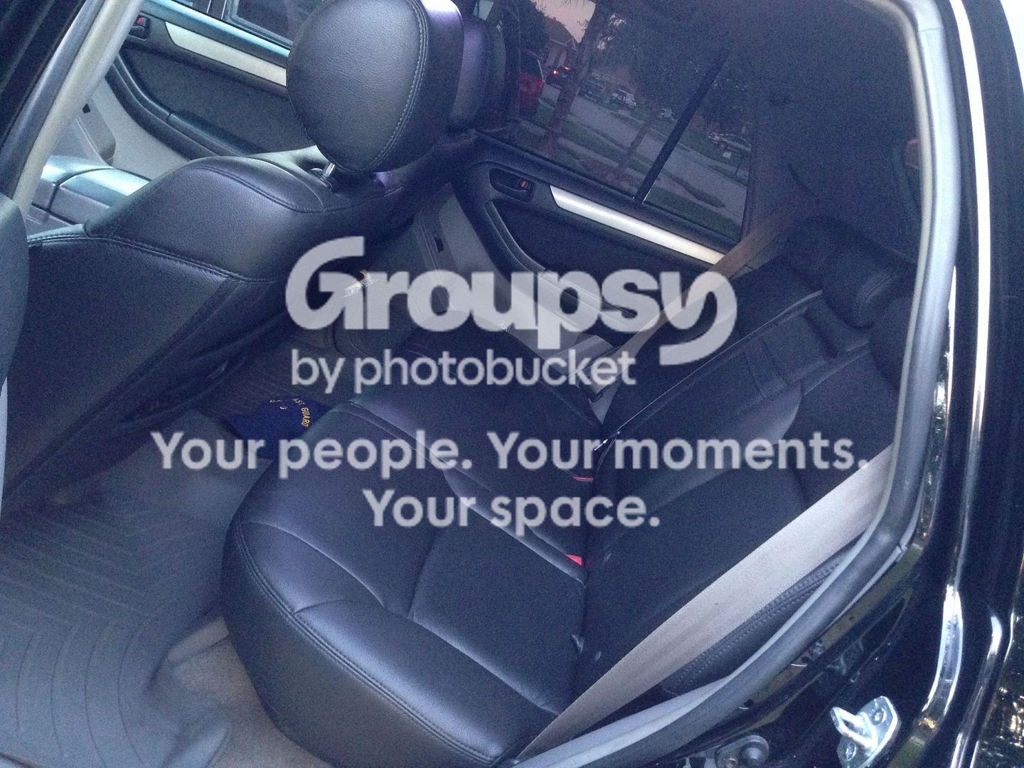

I noticed some of the pictures weren't working for whatever eason so I fixed those. Also I added some updates to show y'all how they have held up so far.
Its been just over 3 years since I did the install and just about 40k miles and they have held up GREAT! I do condition them about 3-4 times a year and I always do the quick leather wipes every time I clean the truck, so about every 2 weeks.

It took me a full day to complete the 2nd row. Started around 8am and finished up about 4pm. I took my time as I removed hog rings to ensure I put everything back together properly. Definitely want to do this with two people if at all possible. I did the passenger seat and drivers seat in about the same time period. Be aware the top and bottom piece have about 12-15 hog rings each. If you don't own a good pair of cable pliers (dikes) get some!
All I have left to do is 3rd row and head rests.
