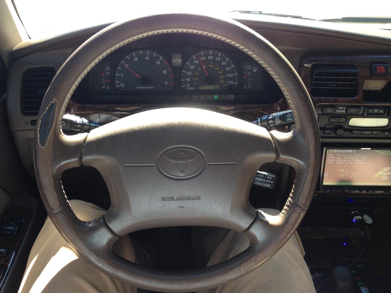

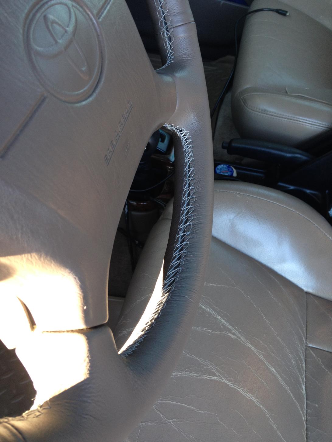

So my 15 year old factory leather steering wheel cover was shot. I found Alan Gun Leather Accessories on yotatech.com from about 5 year ago. He made a cover for a member and the member stitched it on him self. Despite the horrible reviews of this guy on the internet I gave it a shot. He said it would take 10 days to get my cover. It took about 30. I paid the extra $10 for the pre-stitched version for a total of $69.00.

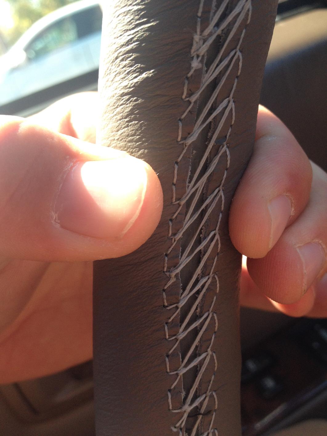

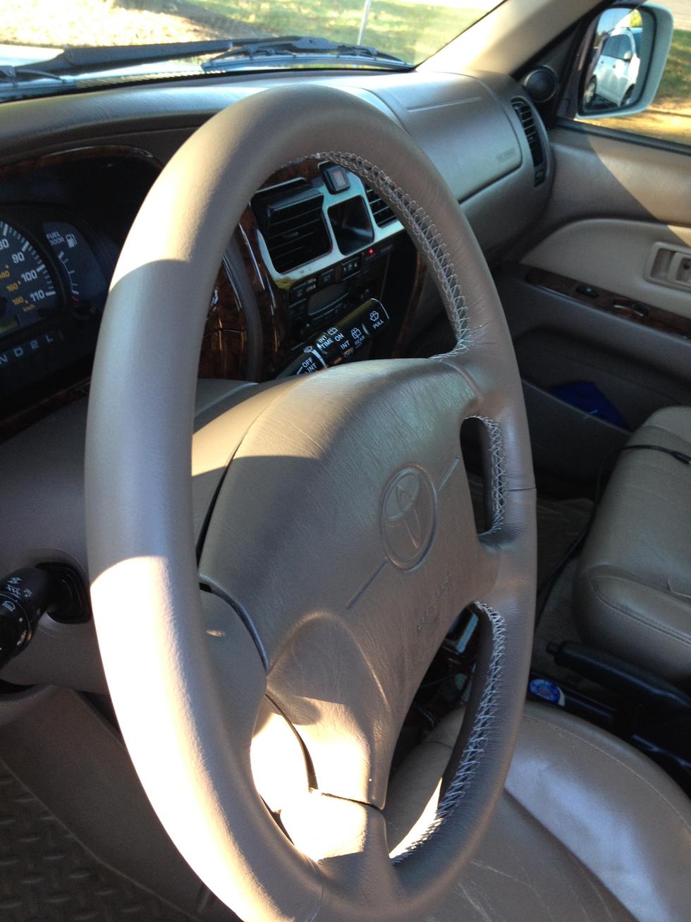

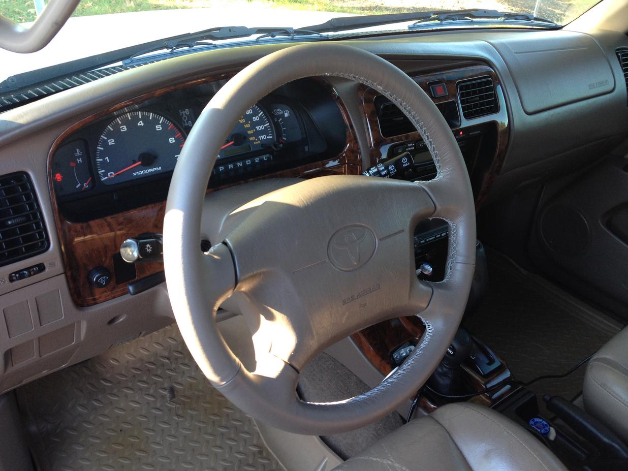

Upon receipt of the cover I had my doubts. It seem like the leather was cut very quickly and without care. I trimmed the flaws out and began the install. I removed my airbag and left the wheel on. It would have been easier and faster had I removed the wheel. I took a razor to my existing wheel cover stitching and peeled it off. The pre-stitched version allows you to simply thread the loops and not have to thread through the leather itself. Around the spokes I looped every stitch for about an inch onto the wheel. The rest of the way around I stitched every other loop. Once I was all stitched up I applied a little contact cement to the inner spoke and glued down the excess leather that goes under the airbag.
One thing I am not thrilled about is that the leather was too small to meet up under the stitching. Maybe it will stretch over time and I can re-stitch. My stitching would definitely look better a second time. Overall I am happy with it and for the money you can't beat it and it looks better than any other cover you can buy. I also believe he has the covers listed on ebay.
Here is 1 before and 3 after shots.

I think it looks good. I agree the stitching could be a little tighter but it is the best looking option I have seen without replacing the entire wheel. I have been looking for an option to do this on my 4runner. I may contact the guy and see what he says. I'll just remember that I'll have to be patient when waiting for it.

I just spoke with Alan and he said this must have been the end of this leather and it did not stretch as much as it should have. He said he would send me a revised cover under warranty.
He has the template for 2 & 4 spoke wheels so I immagine he would make it out of any color leather and stitching you want. I would defiantly order with the assumption it could take a month or two but it's worth it.
Would the leather rip if you pull the stitching a little tighter? Aside from the stitching that wheel looks great
There is just not enough material to make it all the way around the wheel. I pinched the leather as tight as I could together while i pulled the stitching as tight as possible and it is about 1/8" - 1/4" short.

IDK if its just me but that stitch pattern would drive me crazy!
did he supply and instructions with it or did you lace it up yourself from what ever worked?
It came with instructions. I dont think you have many stitch patterns available with the pre-stitched version. You simply hook every other loop together. If you want to lace through the leather you would have a factory stitch. And honestly I don't believe it would take much longer to lace up. I may go this route on the replacement cover. I believe it would hold up better.

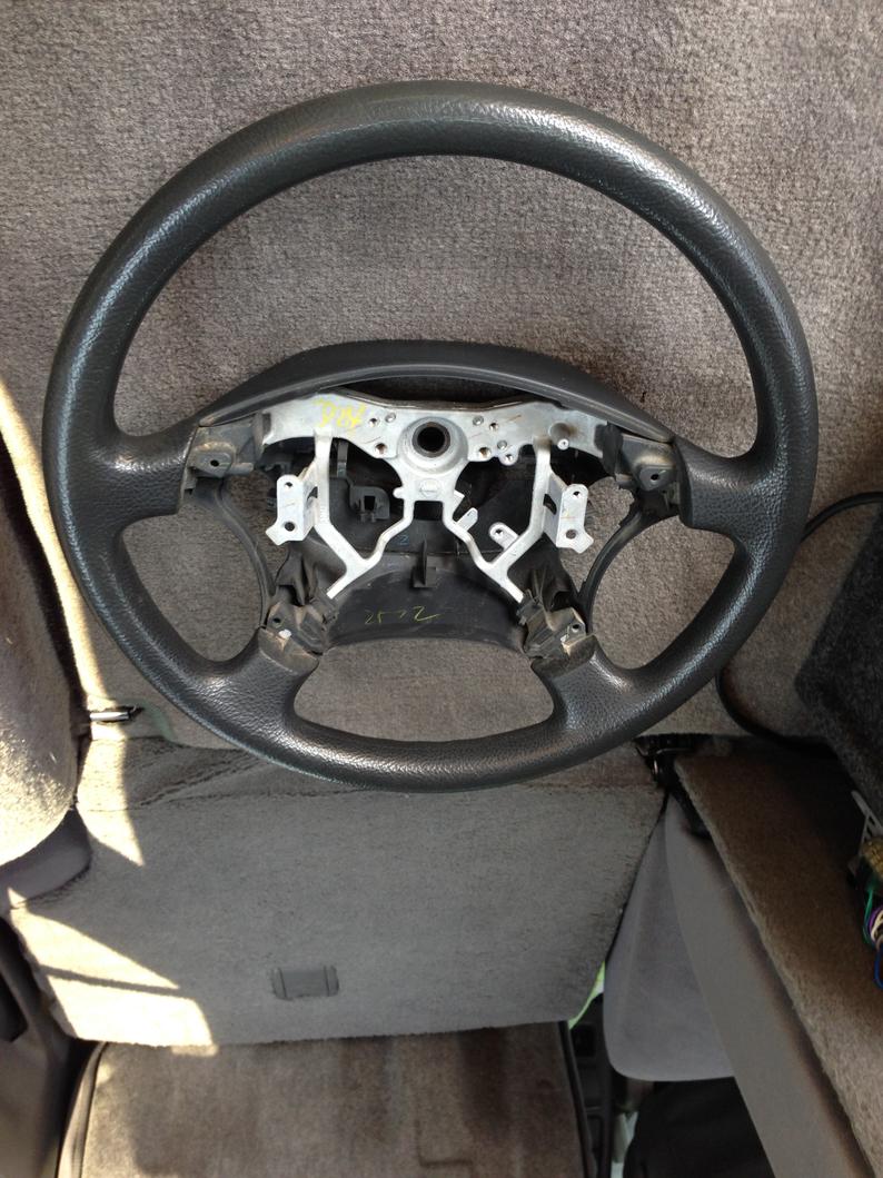

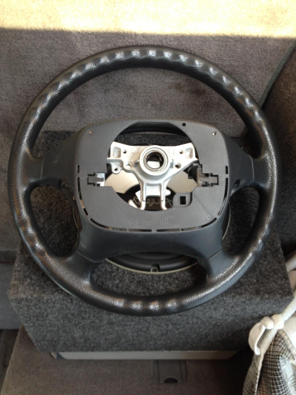

I have this one for $100.00 + shipping, It is out of an 04.
