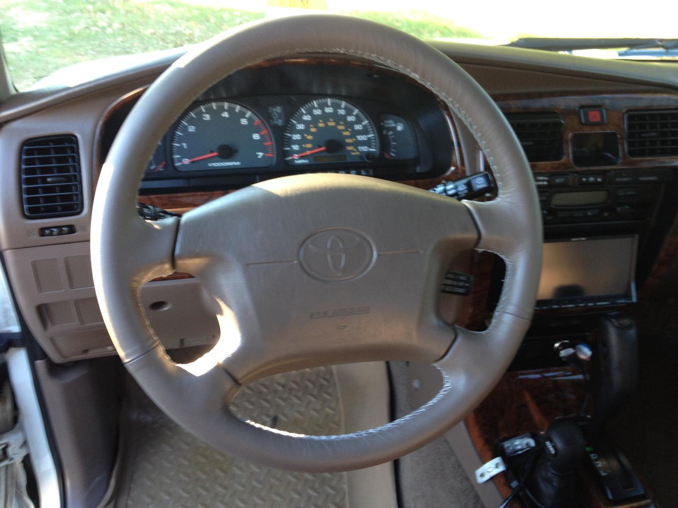

It's a 3 min video of Ishmael from west coast customs wrapping a wheel and stitching to look like factory. This is what I would do for you guys.
Like you I had a hard time getting my kit shipped. I paid for pre-stitching as well thinking it would make it much easier but looks like you had to take the airbag and stuff off anyway.

This stitching option is available. It's the non-pre-stitched version. It is more time consuming than the pre-stitched version I choose. If I were to do it over I believe I would go this route. The stitching looks better and I believe more durable since the stitch goes through the leather as apposed to looping another stitch.
Honestly when I am driving I don't really notice the stitching that much since it is inside the wheel diameter.

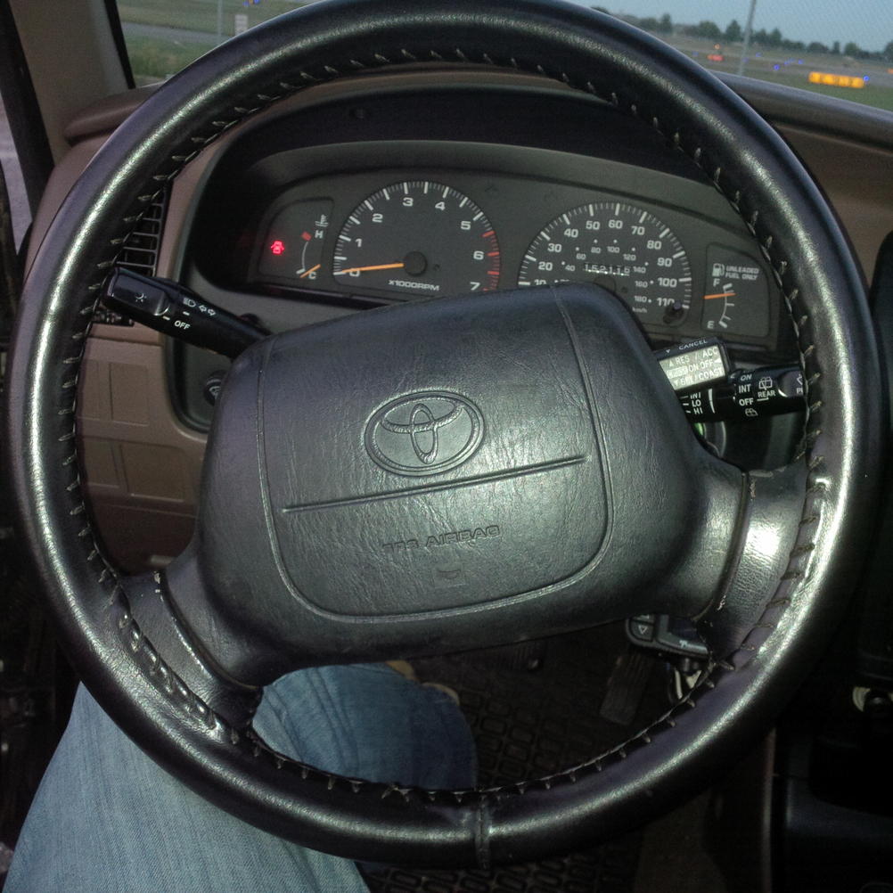

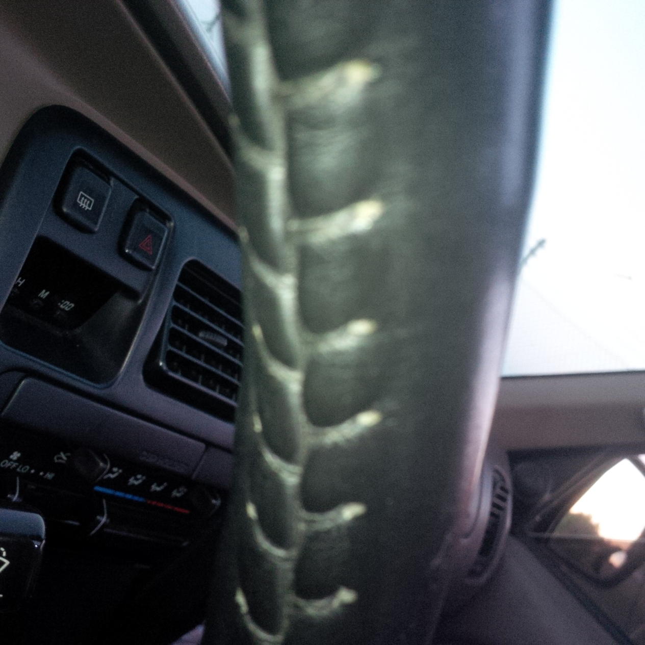

I purchased a cover for mine a few years back... I forget where i got it from. when i get home from work i'll shoot a picture and see if i can find a receipt.
It was a pretty good cover it stitched up pretty tight too.
here are some pics... sorry it took so long...
