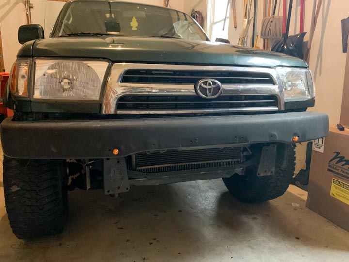

I know this has been asked a million times but I can’t find an answer right now and my car needs to pass inspection soon. How do you get LED blinkers not to hyper flash. I’m assuming it’s a resistance thing does anyone know if you can just put a resistor in the circuit to trick it what Ohm?

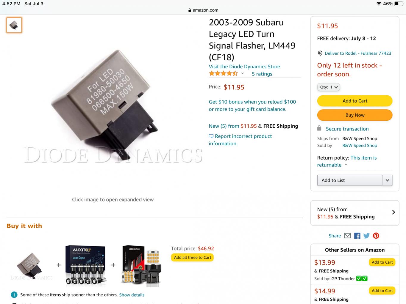

CF 18 flasher
Install a LED turn signal flasher (CF 18). The pic says Subaru but Toyota uses the same flasher / relay.

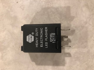

I used this relay from Napa when I installed LED blinkers and it does work. No more hyperflash.

Swap the relay, skip the resistors.
With bad luck, a hot resistor can start a fire... I've bought a bike that suffered that fate to use it as a track bike. Nevermind that it's just a sloppy way to fix the problem.

The other problem with most resistors is folks simply hack them into the wiring harness. Although it may cure the hyperflash issue, it opens the door to all sorts of (generally more serious) electrical issues down the road.
