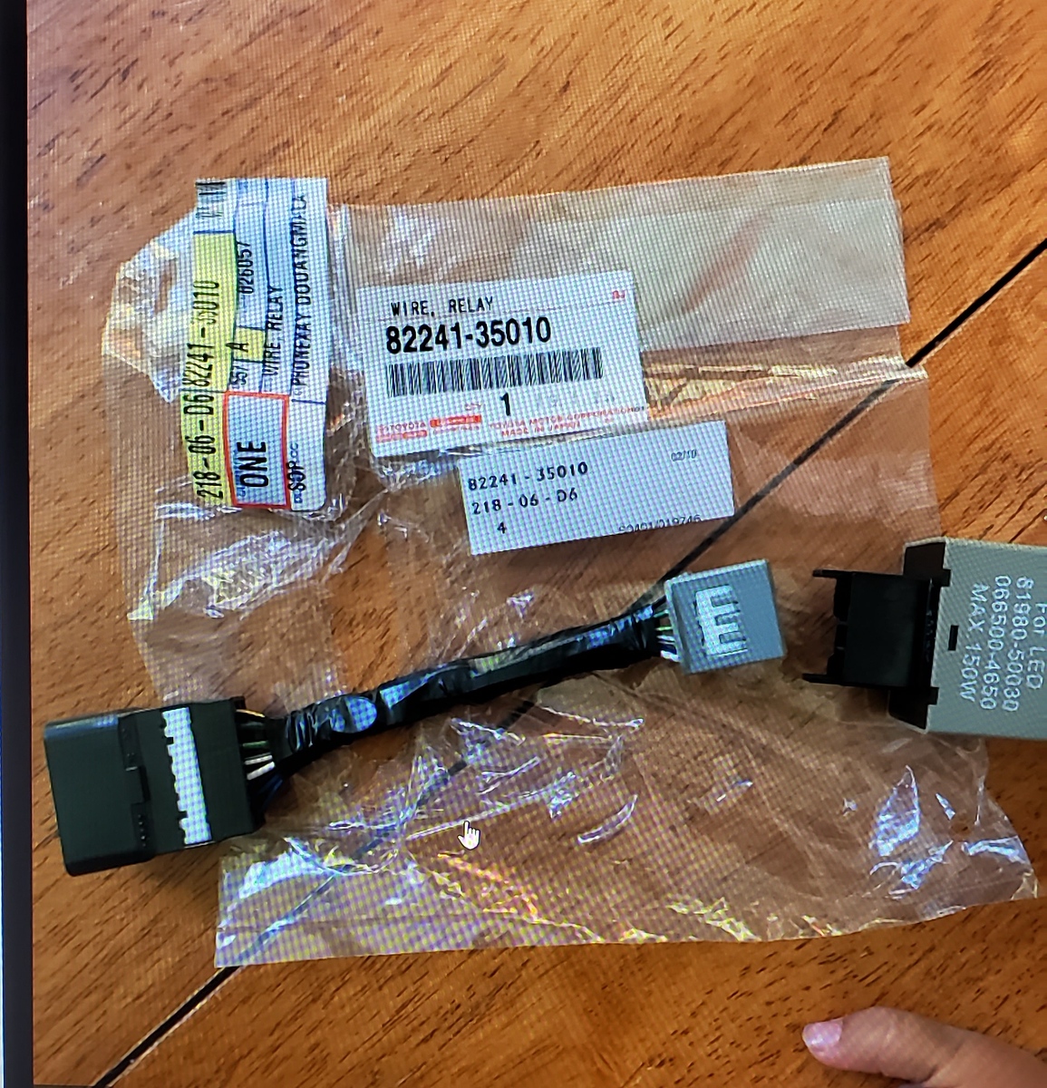

I used the Diode Dynamics Smart Tap since I'm running aftermarket LED turn signals in my Coastal front bumper. Plug and play for the most part. I had to get a new OEM short adapter harness for my Limited.
LED Flasher for 2003-2009 Toyota 4Runner (non-DTRL)
You only need this adapter if you have DRLs I believe. With DRLs, the flasher relay is different but this harnes resolves the issue.

I had to run the harness to use the smart tap since my truck had DRLs to start. I've disabled the DRLs completely using Techstream. I hate DRL, they are pointless IMO.

That's what that adapter cable resolves. Vehicles with DRL have the larger connector, not sure what the pin count is. The adapter harness goes from the larger connector to the non-DRL 8 pin connector.

Why not just do it the right way with the adapter harness? I'd rather do that then a hack job of grinding a resistor. Less chance of issues, especially since it's OEM and only costs $15-$20 from a dealer.
