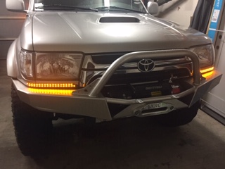

I'm getting a steel front bumper soon which means I'll also be using LED lights for my front turn signals. I know that I'll need to upgrade the flasher relay to one that is designed to work with LEDs (to avoid hyperflashing) but can anyone confirm that I'll also need to replace the rear turn signal bulbs with LEDs as well? Or will the new flasher relay work correctly with a combination of LED bulbs in front and traditional bulbs in the rear?
