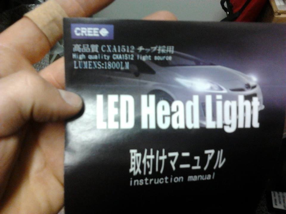

Bumping up an old thread.
How are you guys liking the LED's?
Im about to buy a set of Cree CXA1512 in H11 and 9005, and maybe another set of H11 for the fogs.
What temp ranges should I get? 3000k for fogs, 4300k for highs and 5000k for lows? Make sense? Or dumb question but do LED's even come in different temp ranges? I don't want white light in my fogs.
