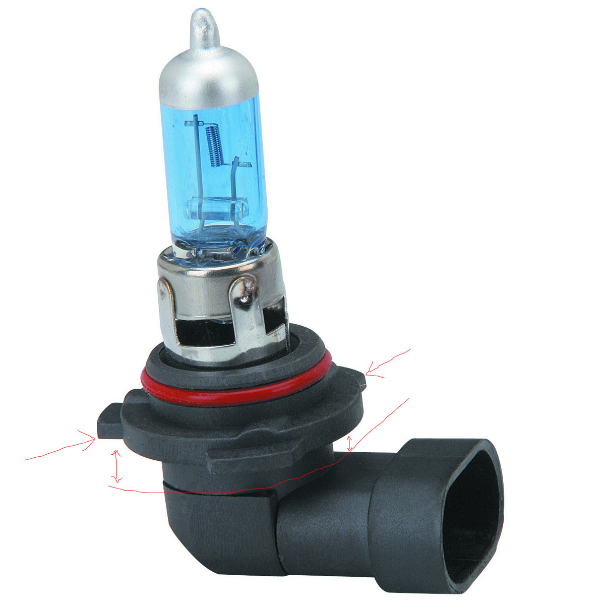

So to my disappointment, both the new H11 and 9005 CXA bulbs will not fit the 2010+ 4Runner. I lit them up and they looked nice, quality build, etc... but there are a few distinct issues with them:
1 - The H11 bulb will not fit the passenger side due to the limited space between the headlight housing and the chassis. The bulb is simply too long.
2 - This above issue isn't as much an issue on the driver's side, but the diameter of the tip of the bulb is slightly too large to fit through the opening of the headlight housing to install. I did everything I could to get it in without damaging the bulb but it simply would not fit. Given issue #1 above, I didn't want to have to pull the headlight housing to see if it works - too much effort for a bulb.
3 - The 9005 bulb fit into the stock opening no problem - there was also plenty of room to work with on both sides. The issue was in the design of the bulb. There is not enough space between the three nubs and the base of the bulb to allow it to turn in the housing and lock into place. When looking at the OEM bulb as a comparison it becomes very clear that this space has been reduced on the VLED bulb.
Anyway, I am returning them both. Unless VLED changes their design to emulate the "L" shape of the stock bulb or creates a reduced length design (as well as addressing the size issue of the tip) I don't see how this will ever fit the 2010+ T4R.
Pretty disappointing...

May I ask...exactly what do you mean by the redesigned 9005 bulb is shorter, and what prevents you from locking it in place? Any pictures? Thanks! :usa2:
I didn't take any pics...but you can see the light here
Now imagine this example below is the all aluminum - straight version like the pic above... Basically it is the combination of the space between the three nubs and the body as well as the thickness of the nubs...it would not allow me to turn and lock once inserted into the highbeam opening. I tried it straight on, at a slight angle, adding force...nothing would get it to bite in order to turn. I also didn't want to break it doing something that should be pretty simple.

Once you mention it, in hindsight the lack of clearance behind the low beam is real obvious, but I would've never thought about that either until it was too late also
I didn't even think about the clearance - even having a bulb die on that exact side this Monday. You sort of assume that the application will fit...unfortunately I was wrong. Yes - glad I can return.
