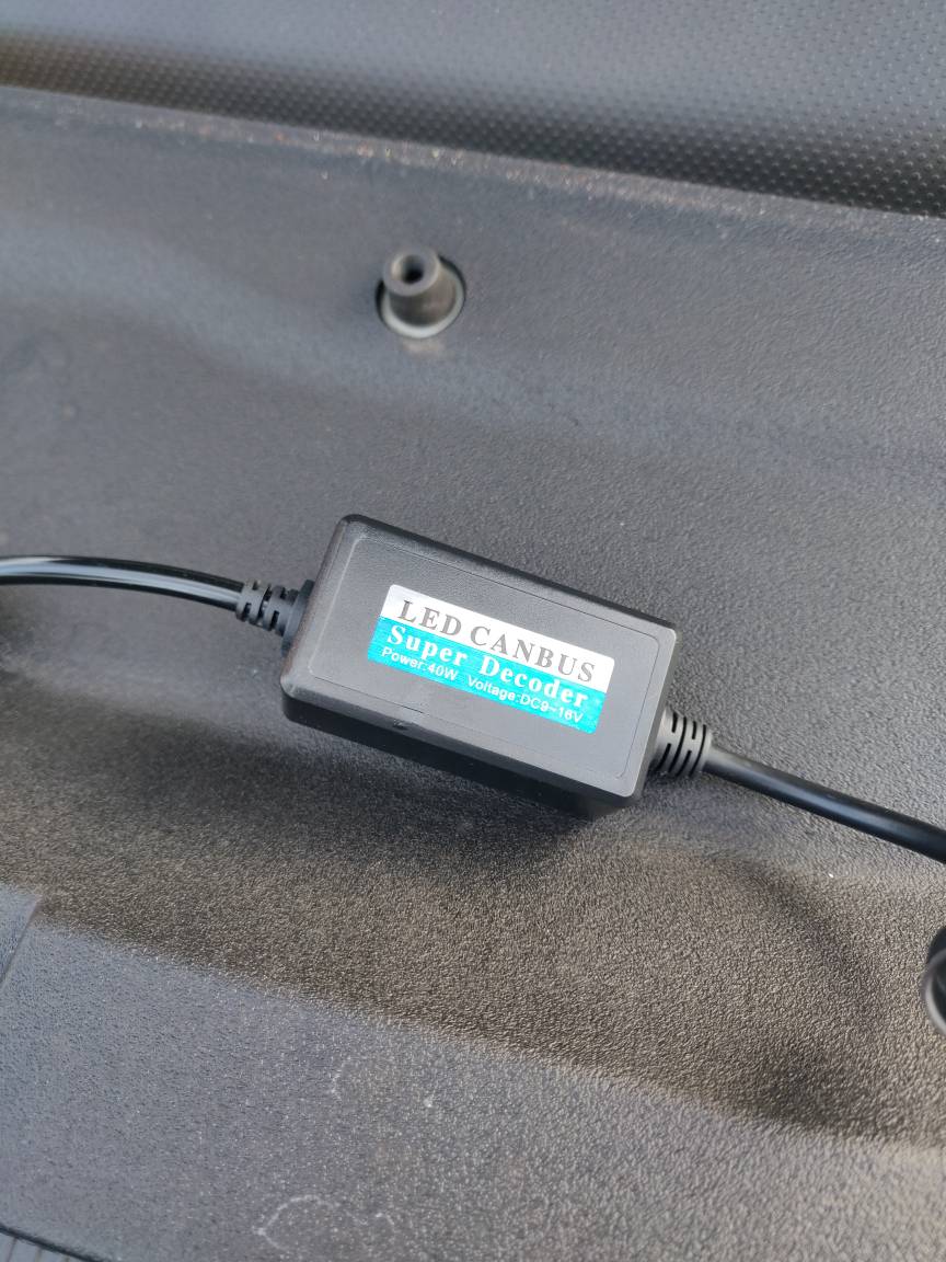

For about $13 works pretty well. Bought some amazon Aukee led 9005 highbeam and low and behold they have a high speed flicker as many others have said. Didn't was to spend $100+ for led drl with drivers so I bought this
XtremeVision LED Anti Flicker Capacitors - Error Code Canceller Capacitor (1 Pair) - 9006/9005 / 9012 / H10
For $12 they seem to do the trick. Haven't seen any write-ups on using these so I figure I'd put it out there as a cheap alternative. All in, probably spent like $35-40 with lights and capacitors
Edit: but they do run at full power all the time now
