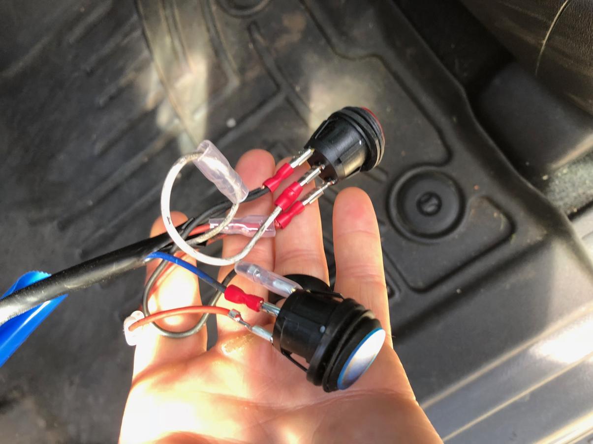

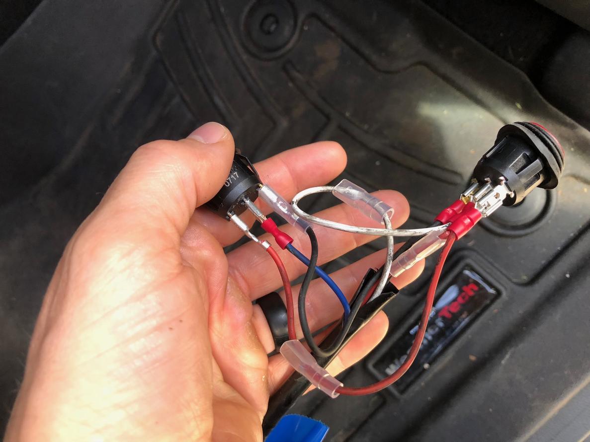

I purchased Rigid light bar (radiance +) installed behind the bumper and want to hook it up to the AOB switches however i can't find a wiring diagram which shows the AOB switch harness to rigid light wiring kit. Here are a few pics of what i'm dealing with, hope someone can help me out.
here are the two switches from rigid
one switch has a red, blk and blue wire
the other has a red, blk and white
you can see the red is connect to both switches

Now, you'll need to connect a wire from the high beam or fuse to the trigger wire on the switch to provide it with power. This is the questionable part. By connecting to a fuse, you'll have to hit the switch every time you want to turn the lights on.

If you have a switch, you have to have a trigger source (12V power) going thru the switch to provide a circuit to power the relay side that makes hot the connection between the battery and the light bar.
If your trigger wire is connected to the high beam, the only time the switch is made hot is when the switch is depressed and you turn on your high beams.
Now, if you have the trigger wire connected to a hot side fuse, then that trigger is continuously hot, so to turn on / off your light bar, you must depress the light bar switch each time.

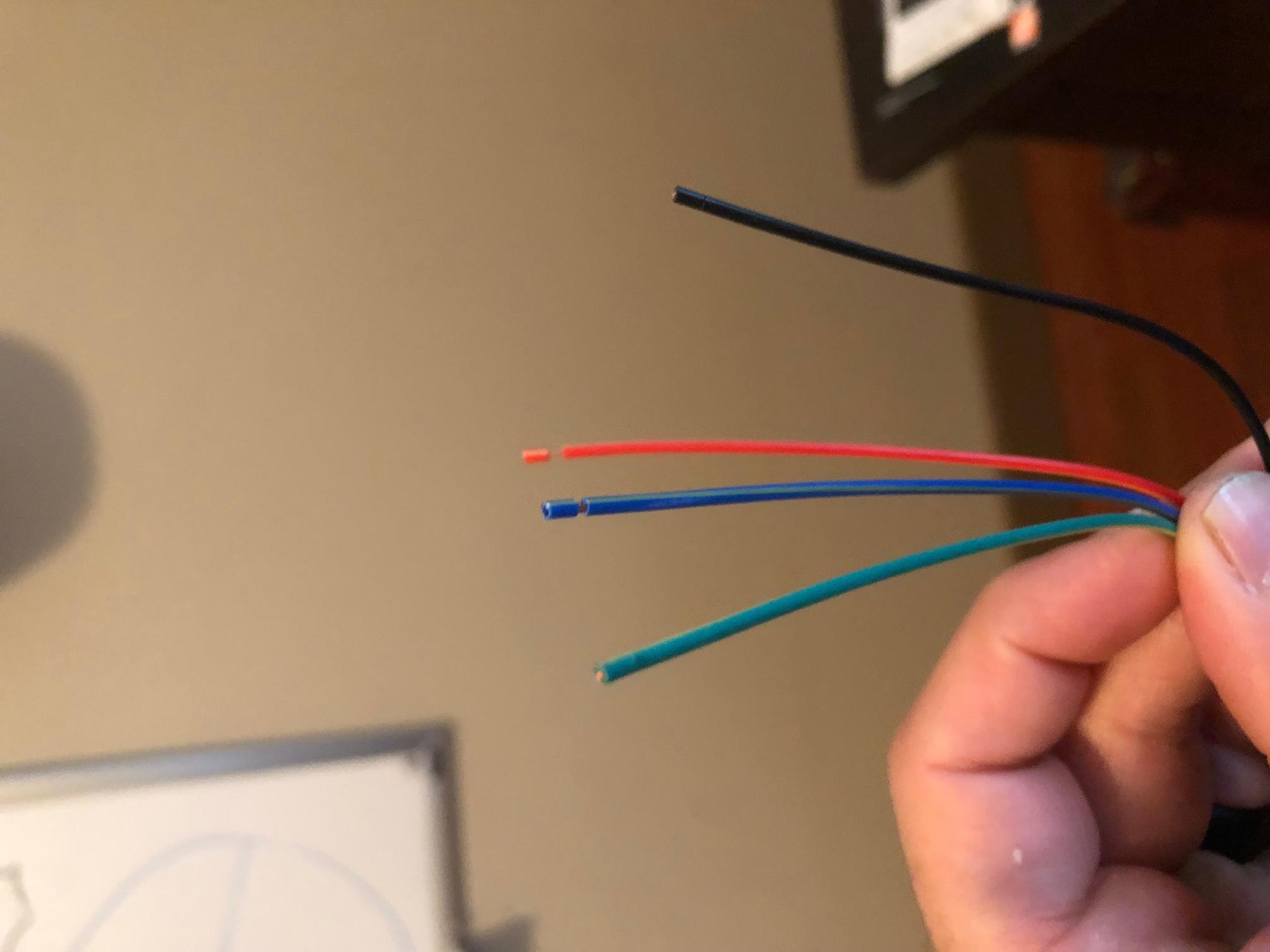

Just completed an install following along with this thread’s knowledge. Everything is working fine, but one thing seems off:
The AOB switch does dim with the dash lights, but the lighting is always on when the ignition is on. The wiper warmer button (which I tapped the green and gray wires) does not illuminate with the headlight controls in the off position. Is this a function of the AOB switch or did I somehow manage to do something wrong?
Ok, lighting should only be on when the light switch is turned on, on the stalk. Prolly have the two of the wire not in the correct location on the switch. I seem to remember some of then having been shipped out like that. Check wire color and location on switch referenced in my diagram. ( I just checked my extra switch wires and they are as indicated on the diagram. )
That wiper warmer switch should only illuminate when you turn your lights on, not when the ignition is turned on.
Then the little light bar indication above the wiper etching on that switch should light when the wiper warmer switch is depressed and go off when depressed again or until it times out.
