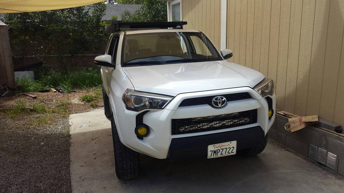

Thanks [MENTION=81322]barryhiram[/MENTION]. If the grille wasn't 100% wedged in place and hopefully never coming out again, I would take it out to get some mount photos.
The concrete angle brackets I got worked perfectly with these two existing bolts in the bumper support to accommodate the 32" bar, both in height and width. I didn't have to drill or cut anything.
Was shocked at how well it worked out.

They are more than high enough coming off the bumper.
http://www.toyota-4runner.org/2307312-post188.html
This post is where I got the idea to use the brackets. He drilled a hole to lower it since he has a limited, but it should give a bit more insight. Maybe they are using the brackets in the wrong orientation?
The height is more than enough.. in fact, in hindsight I would have liked to have lowered mine by maybe an inch or so.

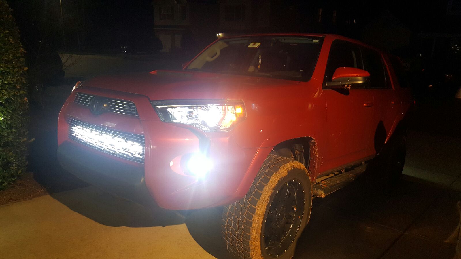

Finally got the 32" Opt7 C2 mounted behind the grill, ended up needing the Rago brackets. Looks pretty nice, and at first I thought the grill would block too much light, but it's plenty bright. I love it...combined with my Opt7 low beams and high beams and the LED Fog/DRL option from the factory...I can see most anything!

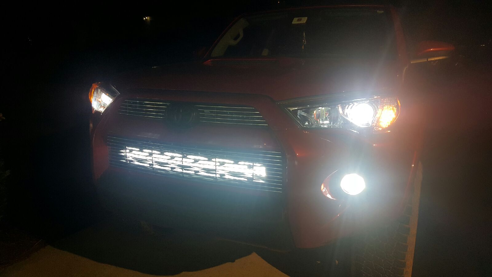

As requested, Light Output Pics Added
Low Beams
Low and High Beams
Full Beams with LED Light Bar
(Keep in mind, output is partially blocked by grill, haven't decided whether to cut it or not!)
Picture after the grill opened up!
Huge Difference!
