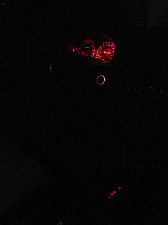

This thread was very helpful, thank you all that gave input. Did mine last night, takes about any hour. I decided to post a pic b/c I didnt see any reds on this forum.
PS_ The light in the glove box seem pretty hard to get to. I can't seem to pull it out from the front, and trying to pop out the receptor from the rear is even harder. Anyone got some tips for that one. It's a 98.
wear a rubber glove while you pull it out. I too had a hard time pulling that sucker out of there and if i remember right this worked for me looks good BTW
