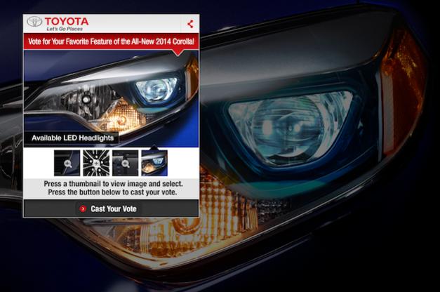

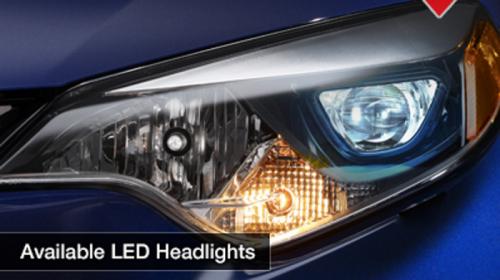

I'm thinking about doing the same thing, but am waiting for the 2014 Corolla to go on sale since it's coming with LED headlights standard and it looks like they might be projectors. I don't know if I can just buy the LED and socket from the Toyota parts counter for a retrofit on my 4Runner or if I have to buy the two Corolla headlight assemblies and scavenge the parts from them.

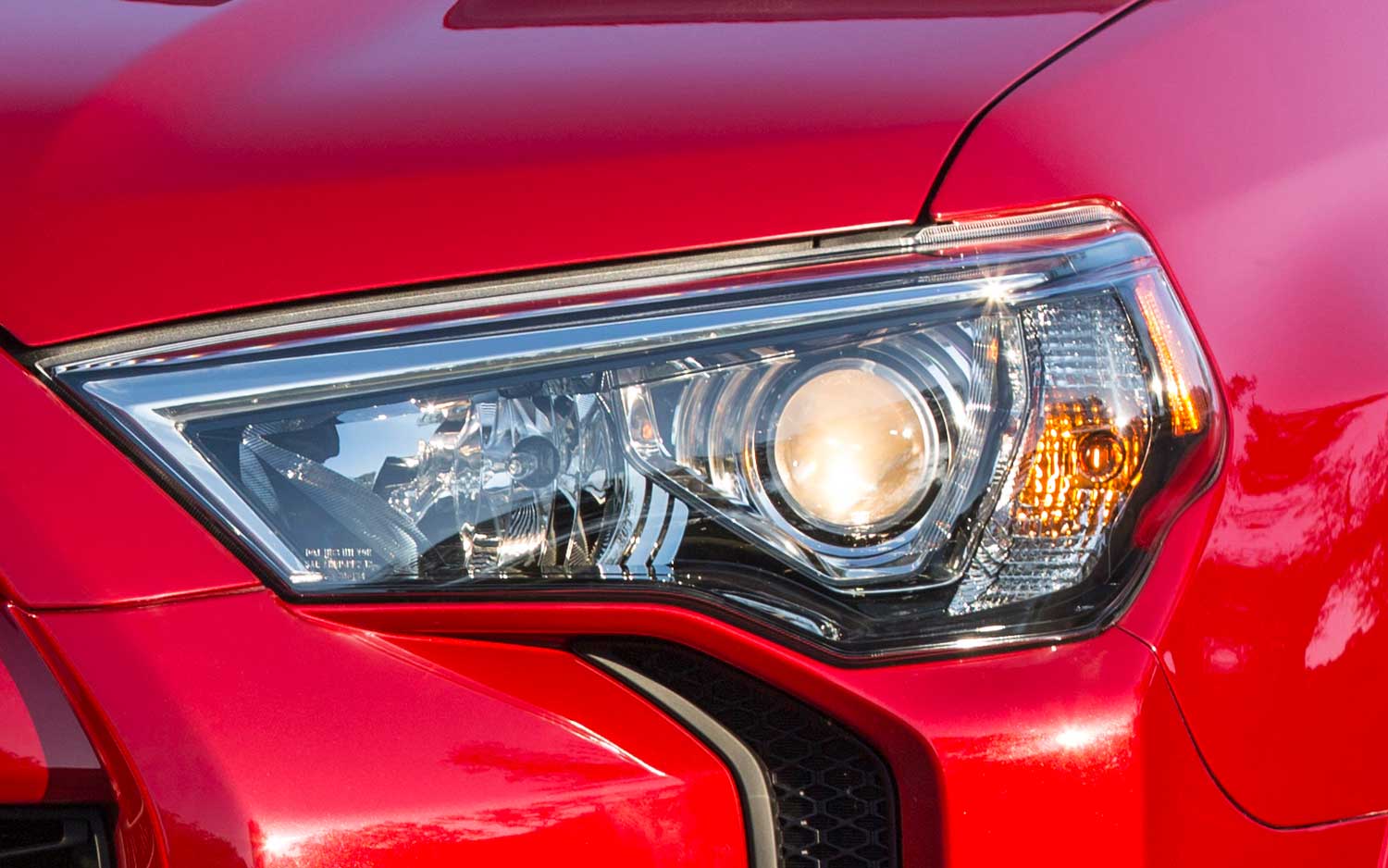

The press release for the 2014 4Runner stated that it's headlights will be "featuring LED lamps", but I don't know if the LED's are for the DRL's, parking lights, marker lights, or the low-beam driving lights. I doubt it's the driving lights because Toyota would have made a bigger deal about it in the press release, which stated: "The headlamps have also changed from halogen to projector beam, with both the headlamps and redesigned rear combination lamps on all 4Runner grades now featuring LED lamps." Does anyone know which part of the headlights on the 2014 4Runner are going to be LED?
