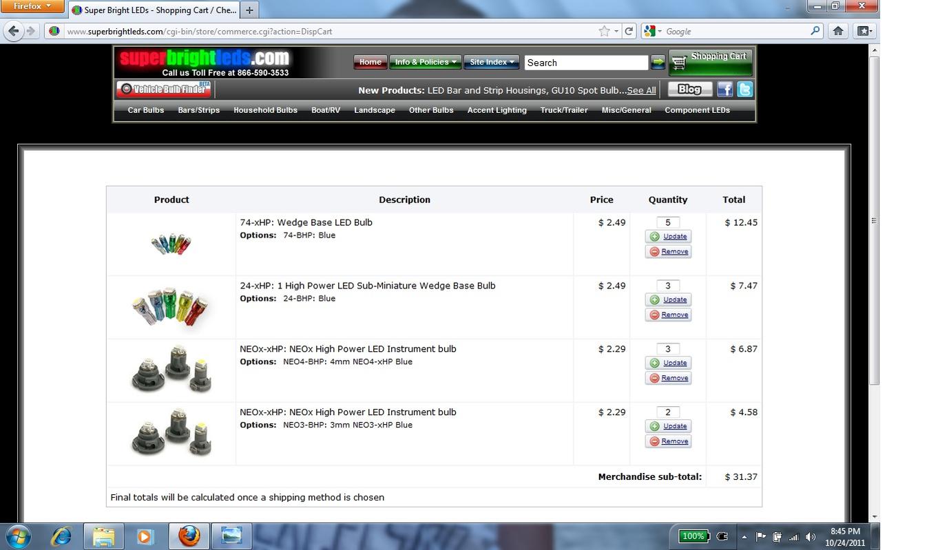

Does this look right????? One of the other post said some thing about 2mm bulbs. I didn't see any 2mm on this site...
Yeah that's right. It's the 3 and 4mm. Sorry I said 2 don't know what I was thinking! make sure you check out the hot spot remover thread. The leds kick up some bright spots on the dash as you can tell in the pic below
