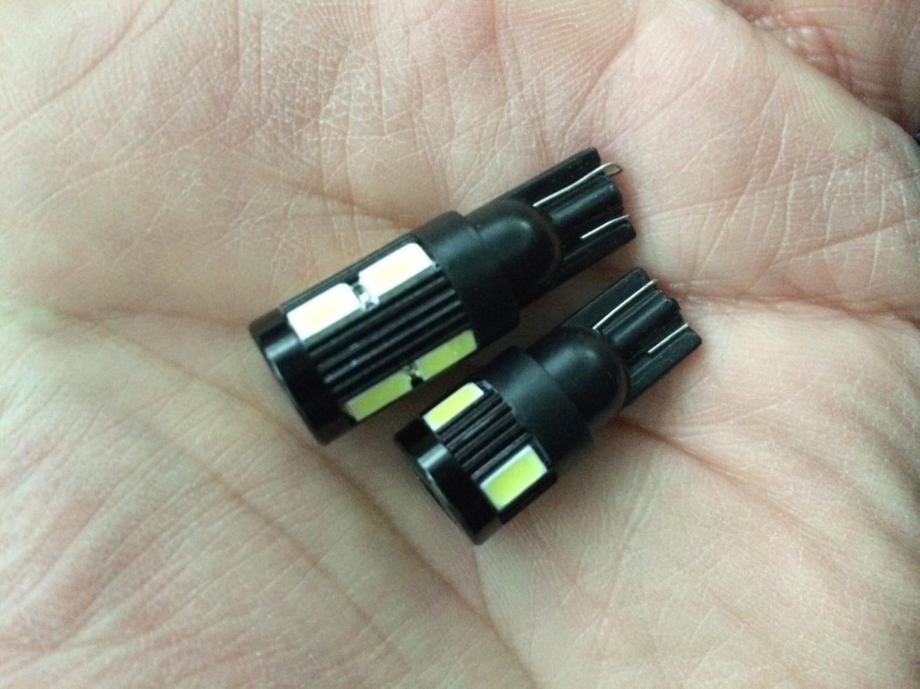

They offered to send more T10s, which they did. See photo below. Originals on the right, replacements on the left. Not the same, eh? I stuck these higher powered units in the map lights, which is a very tight fit. Yep, they're bright, real bright, but I'm sort of liking it. Put two more in the license plate lights. Even tighter fit. Not digging that so much. But I am pretty confident that I have the brightest plate lights in the county. Or country.
So I'm left with enough 5630 T10s to swap them all to the originals. Question is, what cool thing can I do with the handful of extras I have left over? Ideas welcome.

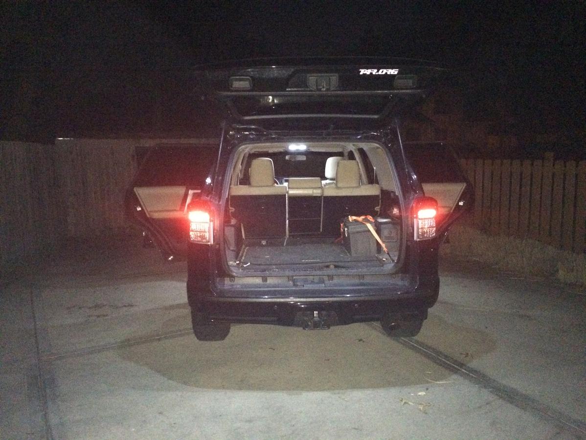

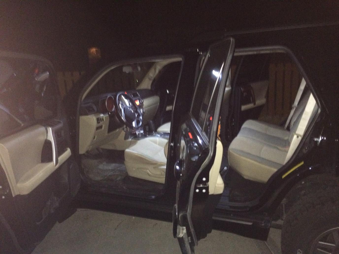

Great easy MOD, and really improves the light in the truck. Cell phone pics but you get the idea. The kit for the 2011 that I got was one T10 short on my order, at 20 bucks I just ordered another kit and now have plenty of extra bulbs.

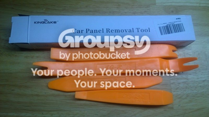

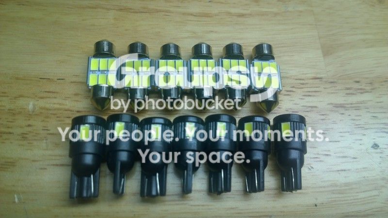

I got my LEDs from Yitamotors. I didn't want to mess with the side mirror flood lights. The plastic trim tool kit i ordered from Amazon for like $6. You really don't need it. A small flathead, letter opener would work.
13 Pcs Deluxe White LED Lights Interior Package Kit 2003 2012 for Toyota 4Runner | eBay
But ran into a problem.
The 13 piece comes with (7)T10s and (6) 31mm
My 2012 4Runner Limited requires:
(10) T10
Vanity x 2
Map x 2
Doors x 4
License Plate x 2
And (3) 31mm
Dome x 1
Trunk x 2
I need 3 more T10 to replace with the 31mm.
I sent them a message and hopefully they will send more T10s. But overall, the install was really easy. I followed the youtube video.
