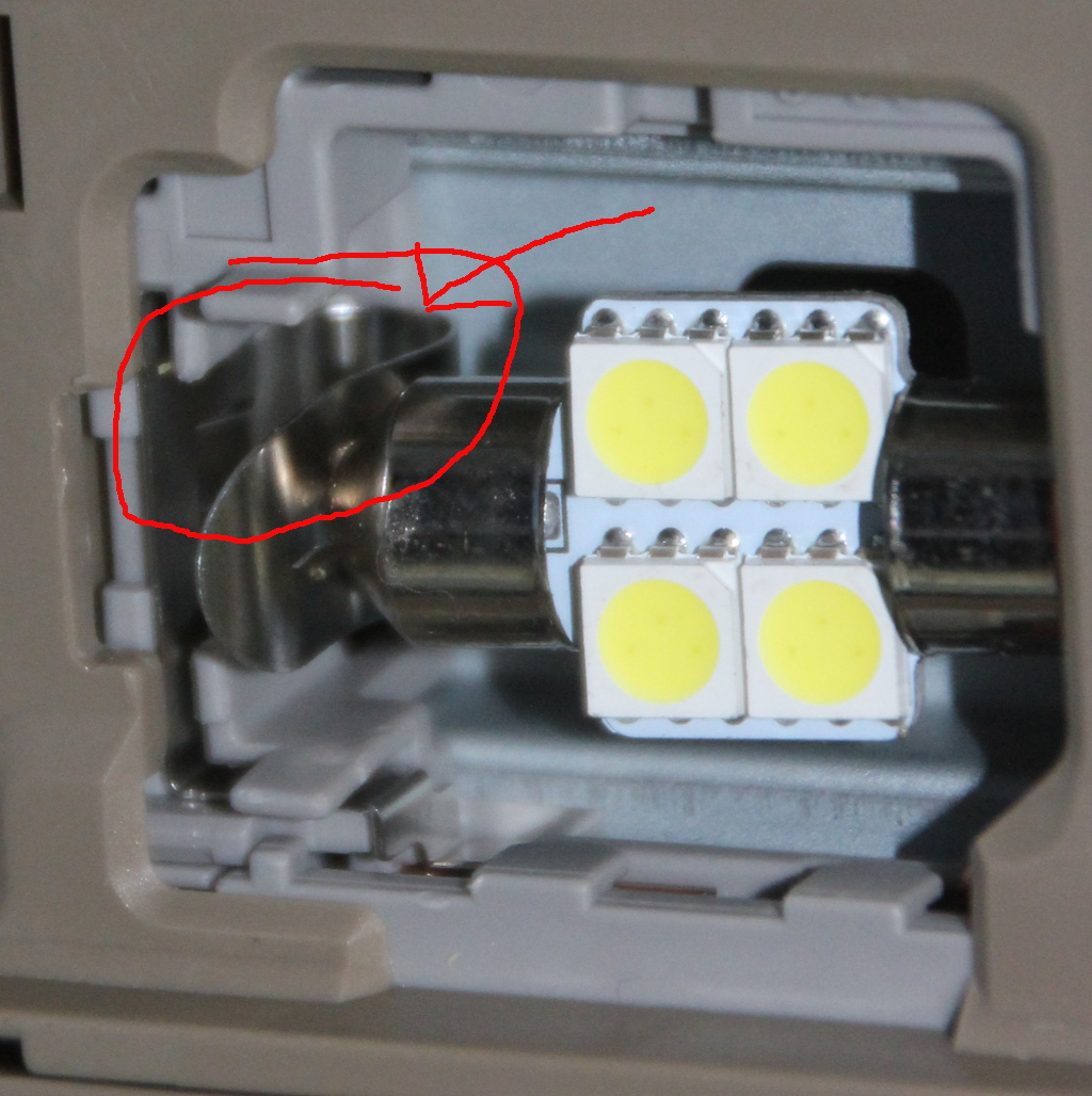

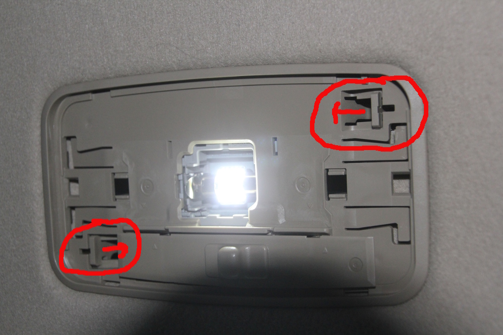

As promised, I took some pictures of the housing to help explain how it is removed and how to fit the larger 31mm festoon LED bulbs.
I've circled the two tabs in red. Slide those in towards the center and the whole housing should get loose. Then it's just a matter of wiggling it out of the headliner. The wire won't let it go far. To re-install, just press it back into the headliner and push the tabs back to the position shown.
Circled in red is the metal spring clip that holds the bulb in place. In this picture, I have the 28mm festoon bulb installed and I had to pull the clip out to get enough tension on the bulb to hold it in place. To fit the larger 31mm bulbs you need to bend it almost flat. I've done this a couple of times now and it doesn't seem to have hurt the clip much. But too many times and you'd probably fatigue the metal and break the clip.

Thanks so much for the pictures! I think I would've ripped out the whole thing without realizing how easy it was to just push those tabs in. I finally got it in after trying again! I ended up bending the metal piece a little to make it fit and that worked. I'll have to do the puddle lights later on when I have some more spare time. That worries me... haha.
