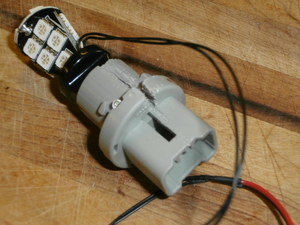

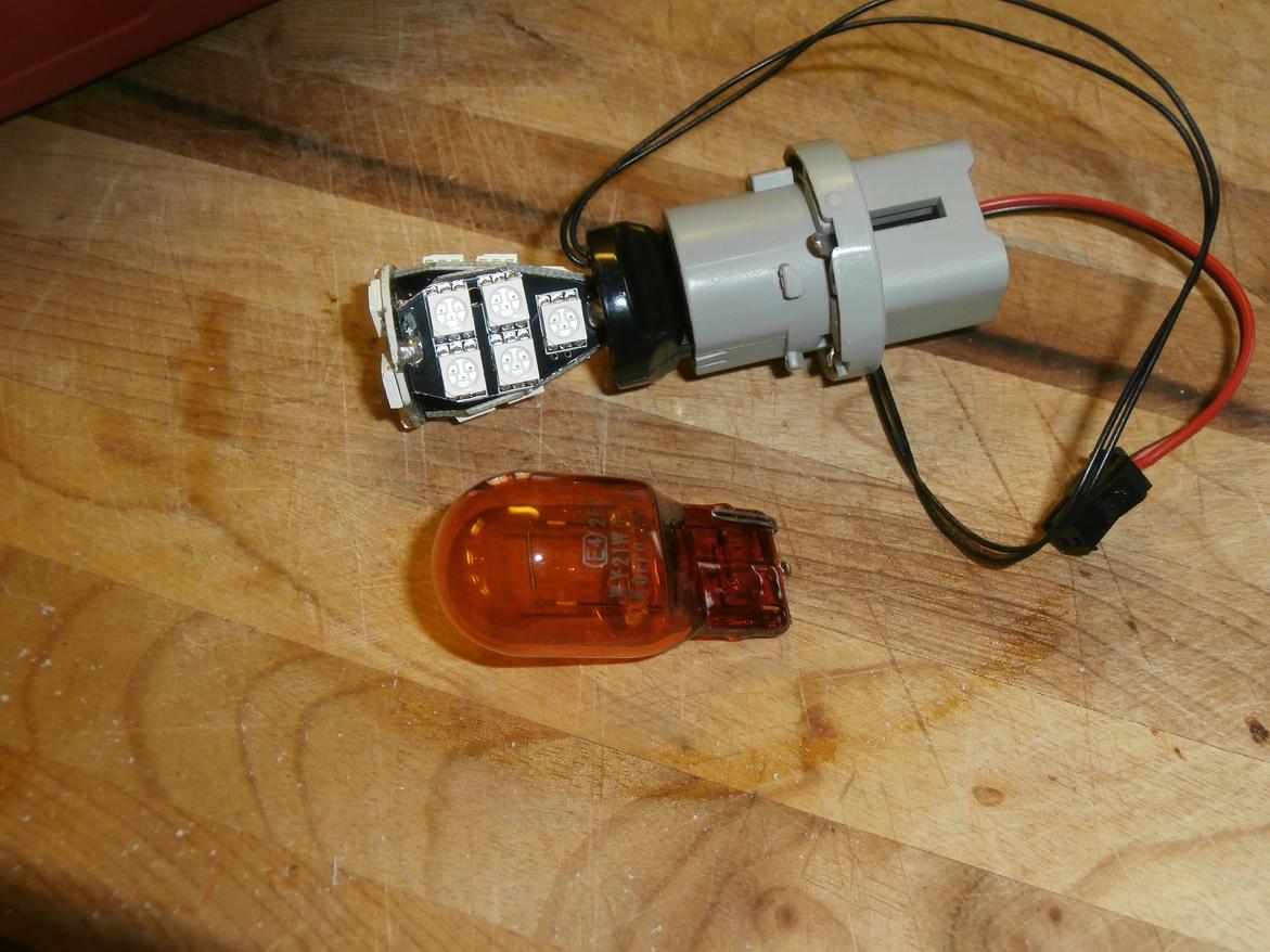

Try these folks. iJDMTOY.com Just be aware that the turn signals come with an external resistor.
The rear brake and backup lights were just plug and play, but I had to fashion a groove in the turn signal socket to allow the wires to the resistor to exit the lamp housing.

It looks like it will. The 4th gen is plug and play so I assume it will be for the 5th gens too. It doesn't look like the body panels or light assembly as a whole was changed, just the insides of it.
