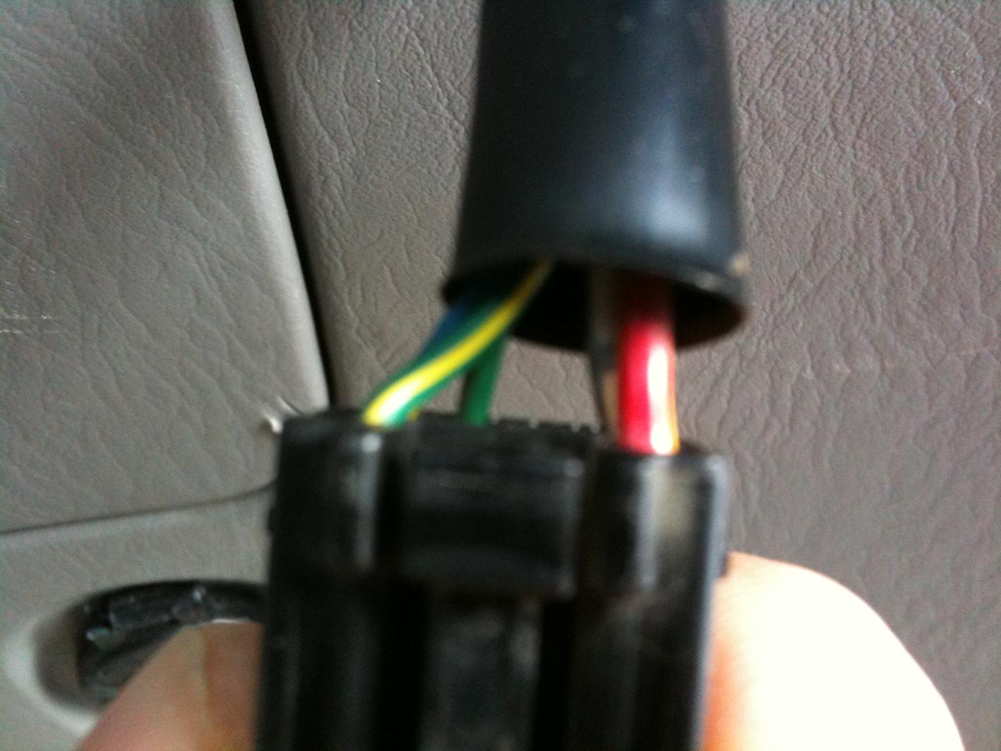

Can anyone help me identify the wires in this pictures?
I'm trying to find the correct wires to splice in a resistor to eliminate the hyper flashing caused by using an LED turn signal.
In the pic (starting in the front/right and going clockwise), there is a red wire, a green wire with a yellow stripe, a blue wire, a solid green wire, and a white wire with a black stripe.
From what I know, I believe the white wire is the ground. Now I'm trying to figure out the turn signal wire. These are the two wires I need to splice the resistor into.
Thanks for your help in advance!!!

Double check that blue wire, Is it blue with yellow stripe? If so, that should be directional for right side - blue/black for left side. Just confirm with a test light.
From the 2003 & 2006 wiring diagrams:
Green should be parking light
White/black is ground
Green/yellow should be brake
Red/yellow should be reverse
The above four should be the same on both sides, the directional will be different colors on each side.

Thanks for your input. I'm waiting for some mounting plates before I finish the mod. I need to install resistors for the turn signal LED light to eliminate the hyper-flashing. I'll let you know how it goes. By the way, which manual were you referencing? I need to get my hands on a repair manual. Would you recommend one? Hayes or another??? Thanks again!
J
Finished!
You were dead on! Blue/Black=Lt. Turn Signal; Blue/Yellow=Rt. Turn Signal. The LED tail light mod. is complete! Pretty simple after figuring out the wiring. Thanks for you help!
