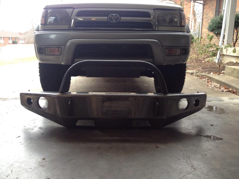

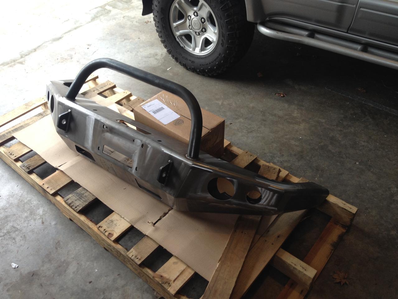

Shrockworks bumper arrived today. I immediately took it to paint. I was going to do it myself with rattle can but it is too cold here to paint. This bumper is beafy and is going to look great. I went with the regular bumper with center hoop and no light guards. I wanted the center hoop but didn't want the one that leans forward. This one matches the lines of the grill and leans slightly back. Stoked.
