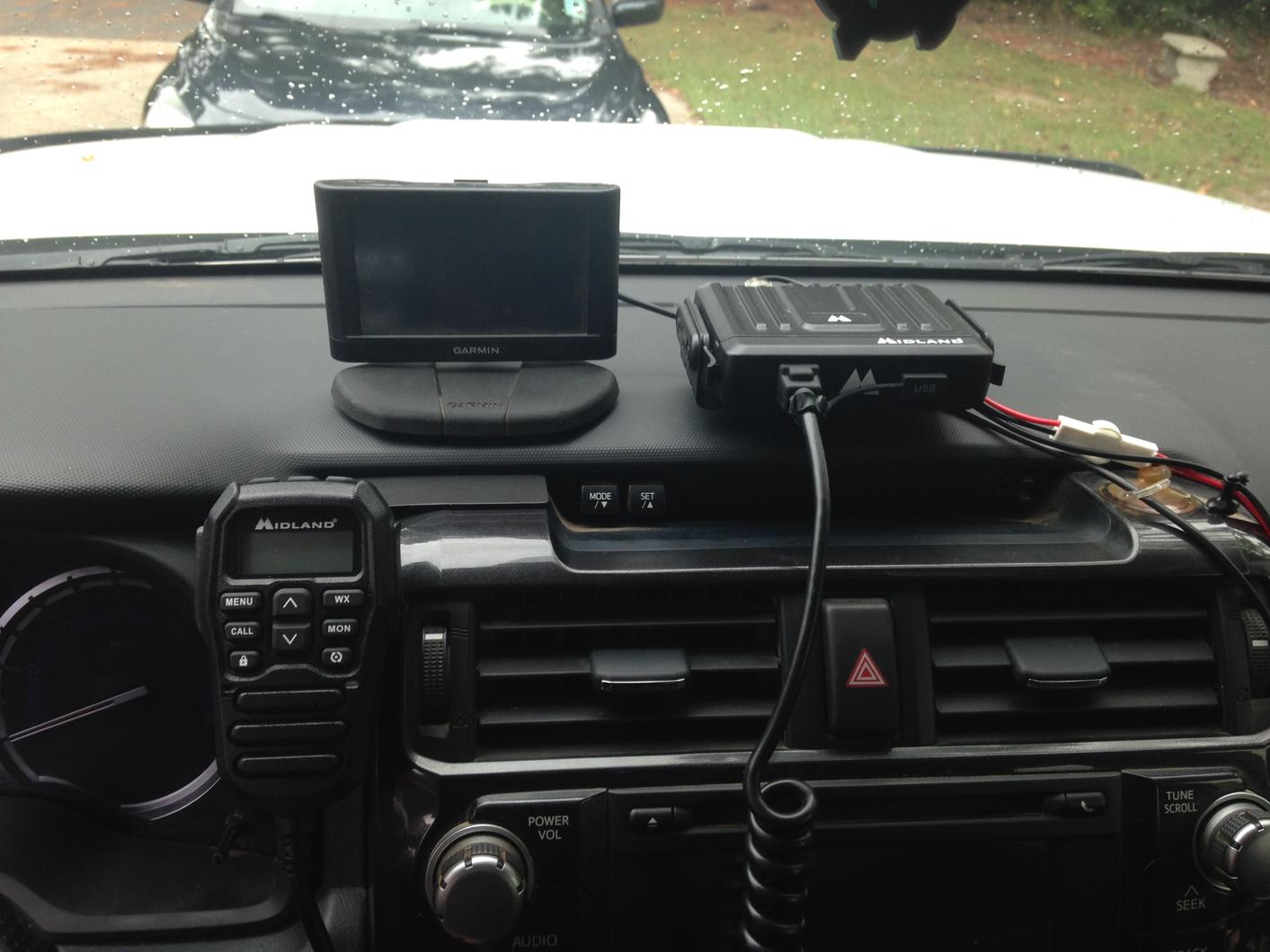

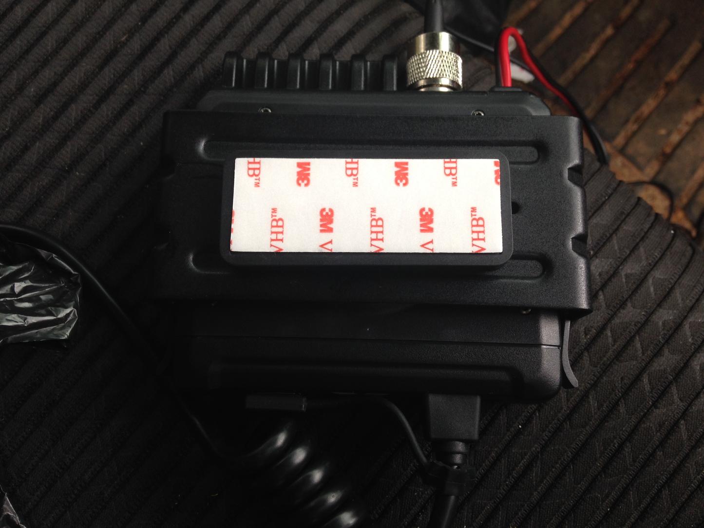

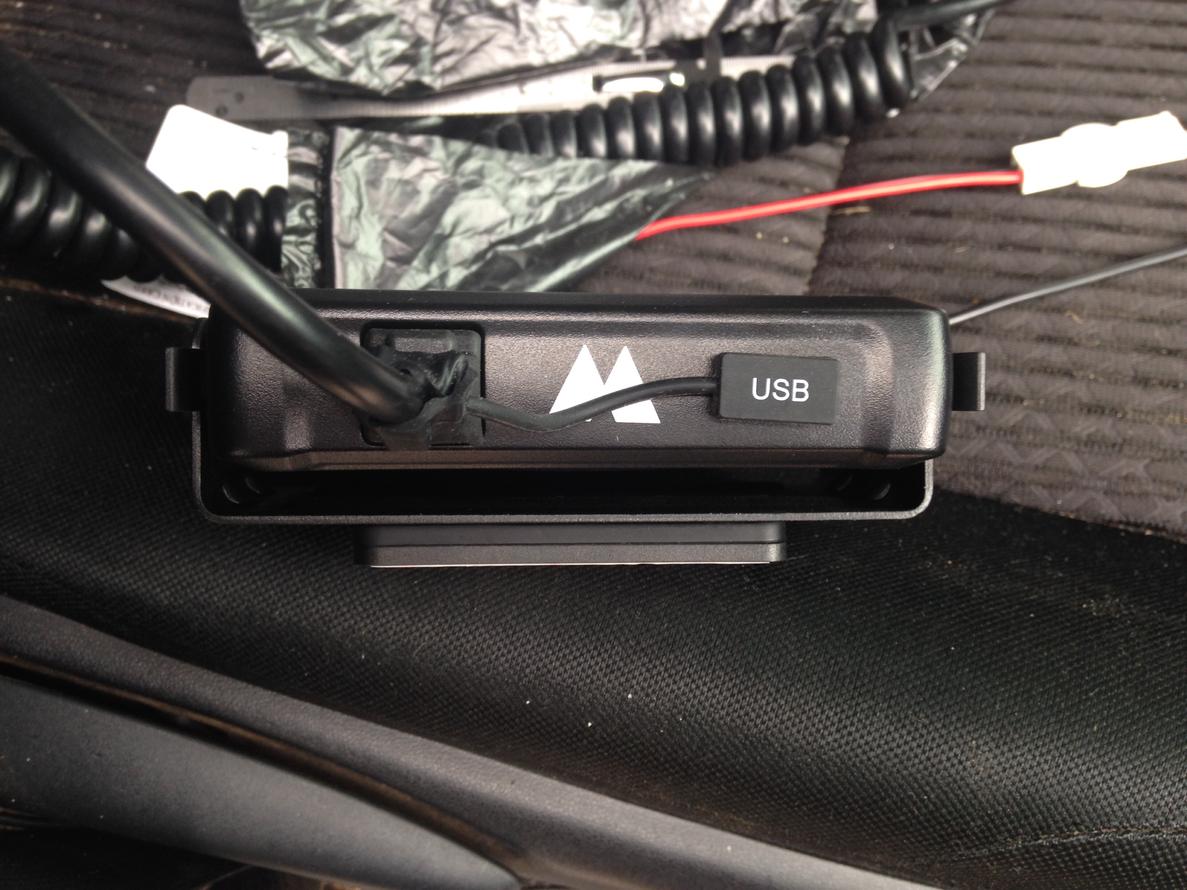

Not specifically a HAM but I used a magnetic phone/tablet mount stuck on top of the dash for my GMRS radio. The radio bracket sticks like glue and I need to put a pretty good pull on it to get it loose. It hasn't shifted on there in the couple months it's been mounted. I was so impressed with the magnets in this little guy I ordered another one and am trying to figure out where to put it.

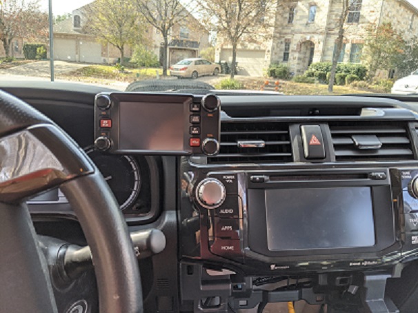

I have a Yaesu FTM-400 mounted under the seat, display overhead and microphone on left of center console. Everything is removable with no damage.

Pics of the mounting bracket on for the faceplate up top?? That looks awesome!
i just bent up and cut the faceplate bracket that came with the radio, just wedge a peice of aluminum in there and the clips should still hold fine assuming your faceplate isn't heavy.
