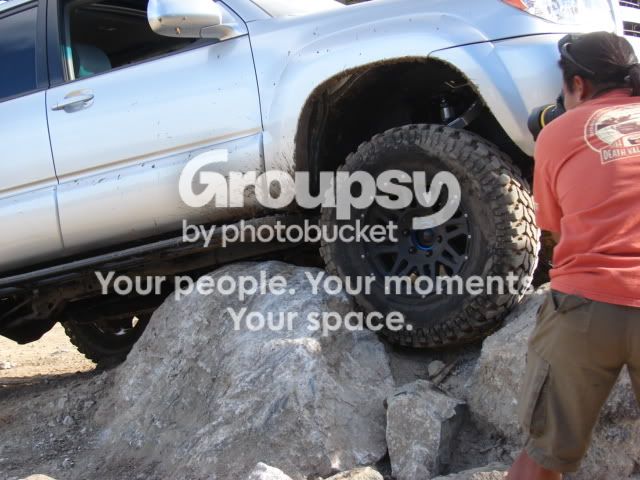

DSC_0663-1.jpg~original
ICON full suspension 3.5" lift with 1.5" Body lift > Firestone Dest. 285/70-17 m/t's :guitar3:

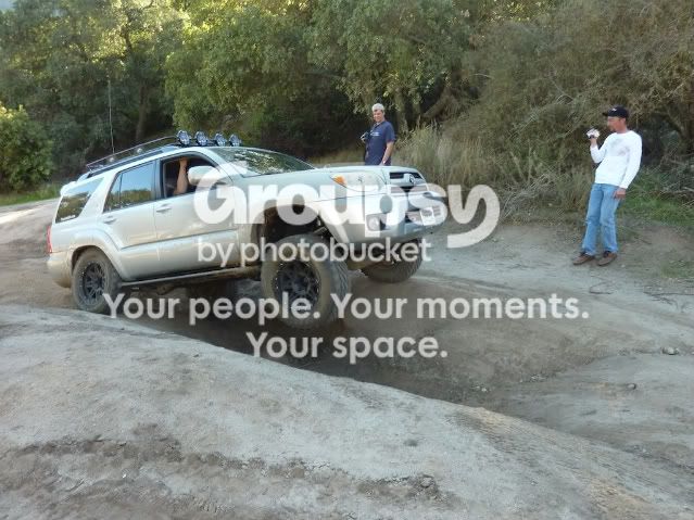

Cornfed 3"/2", Spidertrax 1.25" wheel spacers and Cooper STT 285/70/17 on stock sport wheels -

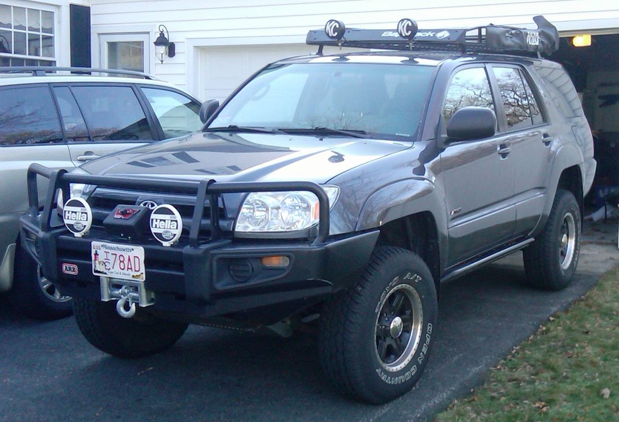

Can I ask how much trimming was required to get the 33s to fit. I'm running a 04 Runner with OME lift, and ARB bumper. Come spring, I'm looking to add a 1" body lift and then jump to a ser of 285-75-16s. Any of you with a similar setup having any rubbing issues?

You wil have very little rubbing if you get the BL. You'll prob have to remove the front mudguards.
Since you already have a ARB bumper no trimming will be required.Possible mudflap removal is all you have to worry about.
The 1" body lift will afford you a little more clearance for the 285's...also since you already have aftermarket wheels the tires shouldn't rub the upper control arms.But always check for clearance to be safe.
BTW:Nice setup.....:cheers:
Thanks for the feedback. I just ordered some front and rear air lockers and 4.88 gears. Once I build the truck fund back up the 33s are a must have.
