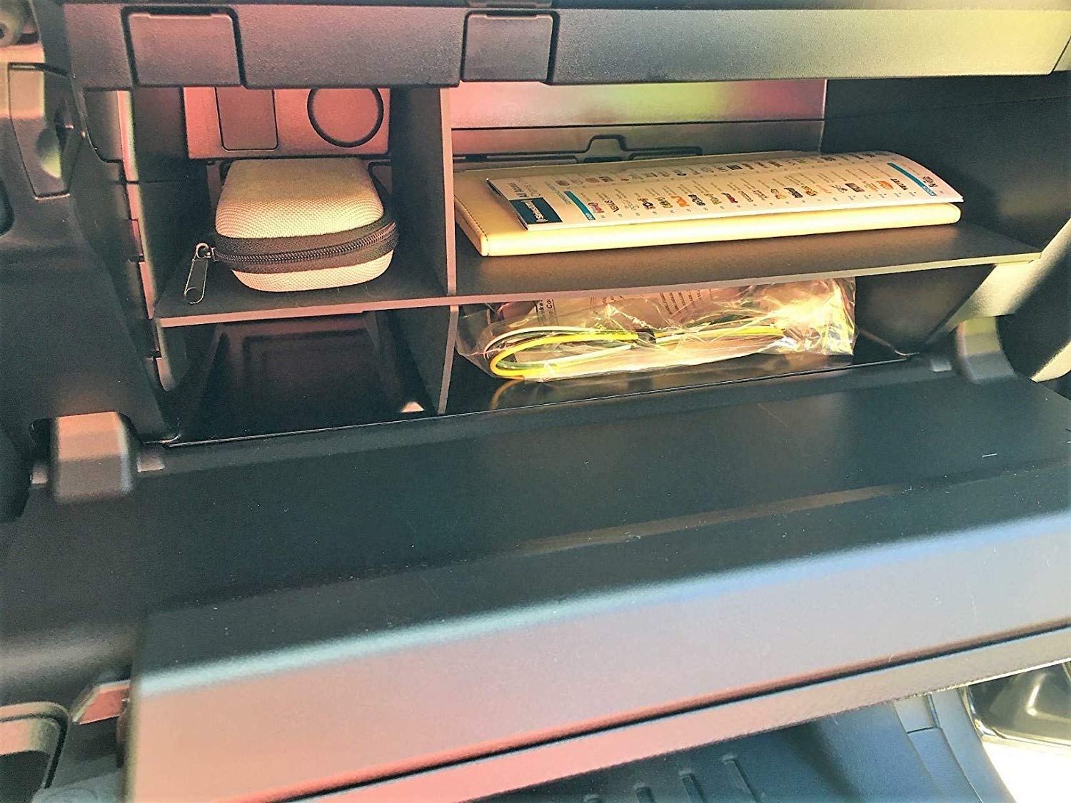

Glove Box Organizer:

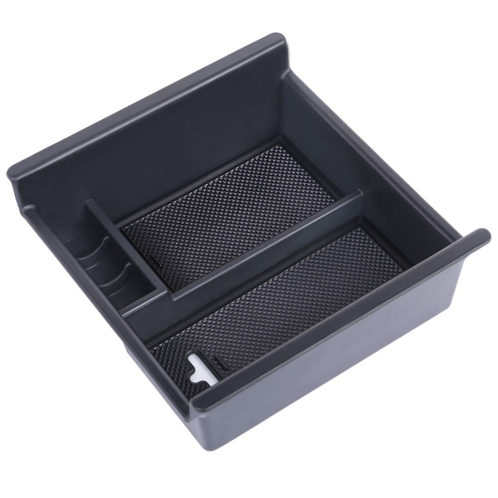

Center console tray:
