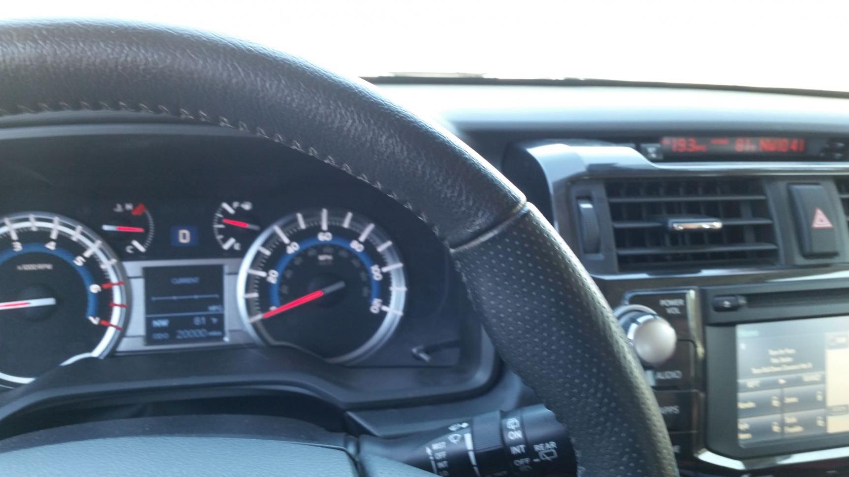

Here is my best interior mod. Upper right hand corner of pic where clock used to be.

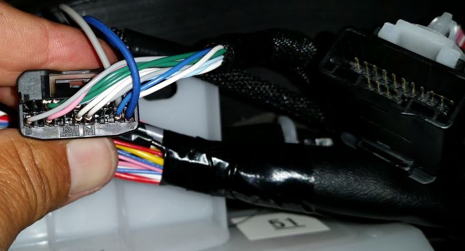

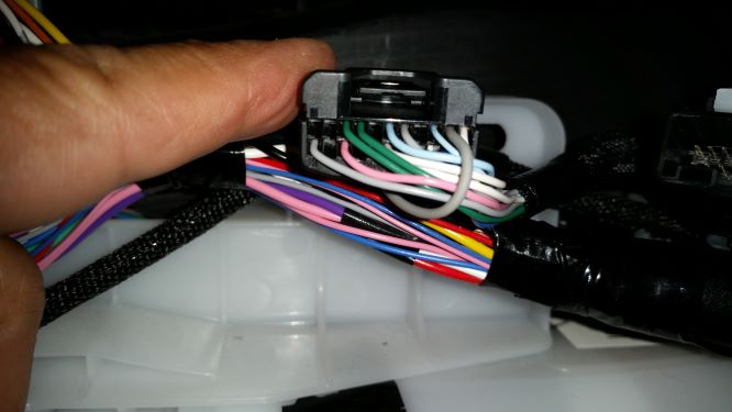

need the pics that correspond to this steps:
18.) Next step involves inserting the blue and grey wires into connector G13. See below to find connector G13
19.) We need to undo the connector terminal locking mechanism on connector G13 to be able to easily insert the two terminal into their respective spots on the connector. Use the small screw drive and gently pry at the locations shown in the photo below. The locking mechanism only comes up a small way, so if it is slightly raised off of the surface like the second photo below, you did it.
20.) Next step is to insert the right color wires and terminals into the correct spots. Go slow here because if you put it in the wrong spot, they are an absolute PITA to get back out, and nine times out of ten, you will break something trying to get them back out. So, again slow and steady wins the race. These terminals are keyed to only go in one way. If you are having resistance inserting it into the connector, rotate it 180* and try again. You will see there is a small tab standing upon the metal part of the connector. This goes into the notch in the opening of the terminal hole in the connector. Match up the location of the wires to the photos below and insert them all the way until you hear a small click. Once the wires are in correctly, you can press down on the connector terminal lock, and insert G13 back into the connector it came out of.
21.) Now all that is left to do is to route the rest of the harness as shown below to meet with the instrument cluster connector.
22.) We can now use the small self sealing silicone tap to "tap" into the already present LIN Bus. You will want to take it slow here because improper tapping will give you a display with little to no info. The harness will already come with this tap on the green wire. You need to slip the LIN Bus wire (see image below) on the instrument cluster connector into the empty slot on the side of the tap. Make sure the LIN Bus wire is fully seated in this slot so that the internal metal tap will be able to come down and make contact with the wire. Once you have this properly in place, press down on the tap with the pliers and make sure it comes down evenly on both sides.
Apologies in advance for the size. I don't recall where I was in the steps when I took these. But I took them to show which slots the wires went into. The wires I am working with are the grey and blue ones that do not "flow" with the cables.
