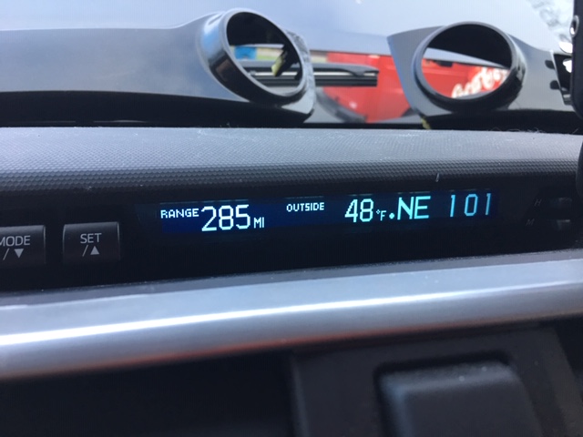

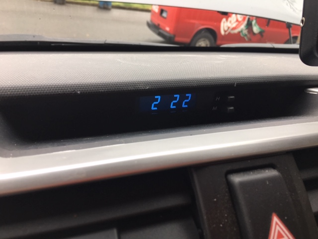

Today i swapped my boring clock in my 2018 to the full display of the 2014 using OLD RED's custom swap harness, I'm happy with it. Also shows instructions on the screen for using crawl control and the settings
this is the thread for the swap
2015+ Accessory Meter Display Mod & Conversion Harness How To - Toyota 4Runner Forum - Largest 4Runner Forum
Where did you end up getting the part? I've seen plenty of the older orange ones but haven't been able to find a blue one...
Yea the blue is near impossible to find, I just bit the bullet and bought it new from online dealer site for $350
2014 BLUE TFT
Part # 83290-35090
Housing stamp “F”
(If I'm remembering correctly) that's because the blue multi-function was only available on the 2014 models. Up until 2013 it was orange, and then they discontinued it entirely with the 2015 models.
Yep, I think that's the deal. I'm going to be patient I see if I can snag one for $40.
