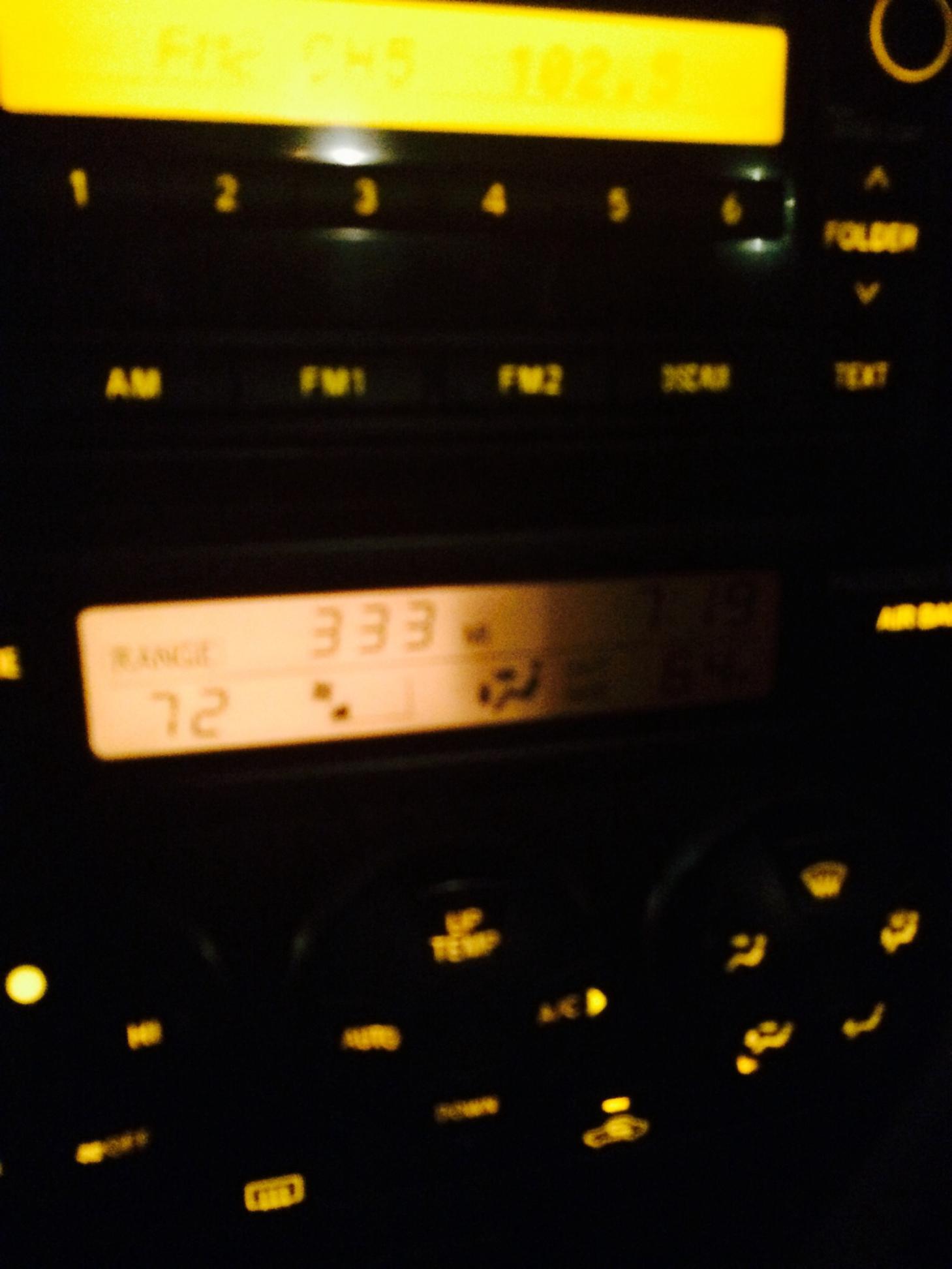

It seems that the lights on the radio panel area seem to fail on a good amount of people. I know mine have! I'm going today to get a replacement bulb and was considering making a work log with pics or even a video to show the process of replacing them! It's fairly easy only about 10-15 job nothing to be scared of though! Here's a pic of what I'm talking about exactly!
Also sorry the image came up huge! I'm on my IPad things are a bit weird!
But as you can see in the picture half of the light on my MPG reader and temp gauge is out and it's a pain at night to see the time and temp outside without getting really close!

I have the exact same thing going on! However, the left side of this gauge is on its way out. The lighting of it comes and goes. I am sure it is not long for this world.

I have only had the hvac bulbs burn out on mine, 5 minute fix. It is 10 years old (135k) and have not had any problems you guys have. Actually know a couple with higher mileage 4th gens that have not had any problems. Still original calipers, but I am sure they will not be problem free for long. Seems many vehicles need calipers when they are well over 100k.

I've changed the dash lights 3 times since I've owned it & I've only owned it 2.25 years. One just fell out recently in a minor fender bender I was in.
For those having any issue with the backlighting on the HVAC control panel need to get a new, updated bulb from Toyota to fix this exact problem. The part # is 90010-09017. This is covered with the release of TSB 3408. It fixed mine perfectly. BTW, it takes 2 of these bulbs.
