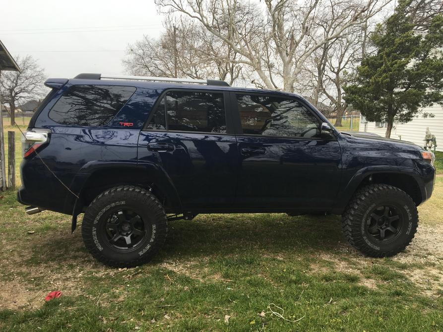

17x9 -12 wrapped in Falken Wildpeak A/T3W 265/70/17
Minimal rubbing at full lock, just a little more minor adjustments & it'll be good. It doesn't bother me that much, I'll probably get around to trimming the bumper & modifying the mud guard over the weekend.
Looks good! I like the gunmetal too!
what lift do you have?
Do the 295's rub?
They do not at all. But yet I had 285s with no lift so I cut to fit at that point but on the body mount I have another 1&1/4 inch of clearance. I have trail team bilstiens off an FJ with the FJ coils plus a 2.5 daystar spacer and 1.5 in spacer In the rear.
Here's a better angle. Thanks btw !
It is higher In the front. I'm in the market for some new rear coils and hopefully have some rake.
