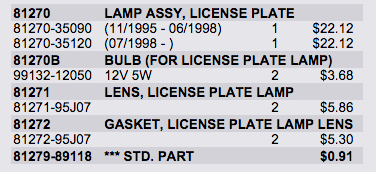

The screws thread through the lenses into the light buckets which mount to tabs in the license plate bezel. You can find both the lenses and buckets in junkyards if you are willing to do the work to retrieve them; however these are often cracked and broken too. Attached are the part numbers I could easily find for my 99's license plate lights/lenses etc.
