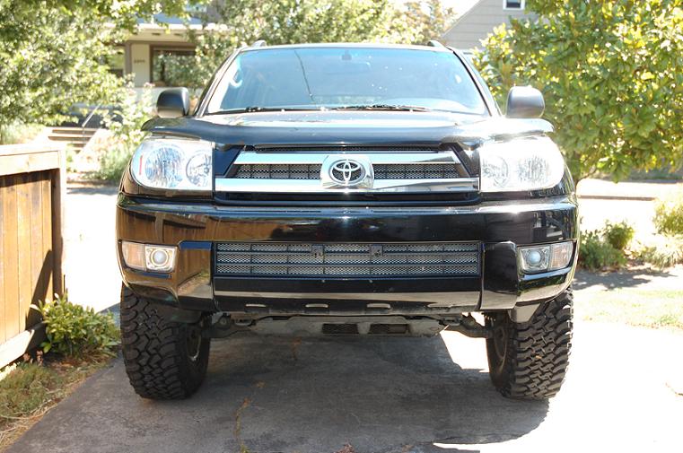

thanks bro i test fit some 285/75/16's today at work, fit nicely, a little snug to the back of the wheel well. here is a pic. i want to run 305's though so ill need some more trimming
sorry for shitty phone pics
285stestfit.jpg~original
here is the closest to it touching so ill def need to shave that plastic off for the wider 305
285stestfit1.jpg~original
wow, that sits a lot higher than it did with the 265's. Or at least it looks like it. You are probably going to have to chop the body mount for those 305's to fit. But it will look good for sure.
bro im 1 step ahead of ya haha and yea its higher, in the pic its just the front driver side installed and it made a big rake to the rear haha, cant wait to get the new tires

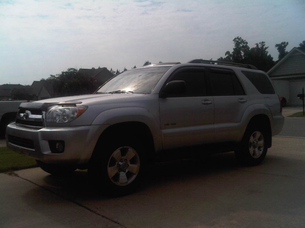

This is my 07 SR5 4Runner before and after photos. I opted for Firestone Destination ATs since this is my drive to work vehicle and most of my time is spent in 15 MPH traffic. They are 285 70 17s.
We are planning a trip in the 4Runner this summer, so road noise during that was a concern for tire choice. These tires are amazingly silent, but still have a nice tread pattern. I'll get 4 more when I wear these out. Love em.
The lift is a 3" Toytec Ultimate with the additional 1" body kit. I have Spidertrax spacers as well. I love the lift. After some light plastic trimming I have zero rubbing short of full flex. It rides smooth, handles fine, as is not too stiff or too bouncy. I believe it is right where it should be and I am an extremely happy customer!
I did not install it myself. A shop in Clute, TX did it for me and they treated me right.
My next mods will be a Shrokworks bumper and bigger brakes. After that a roof rack.
Distant future mods are a winch, then the TRD supercharger, rooftop tent, then maybe some wheels like dreadog's. Those are sweet! Your truck looks righteous dreadog.

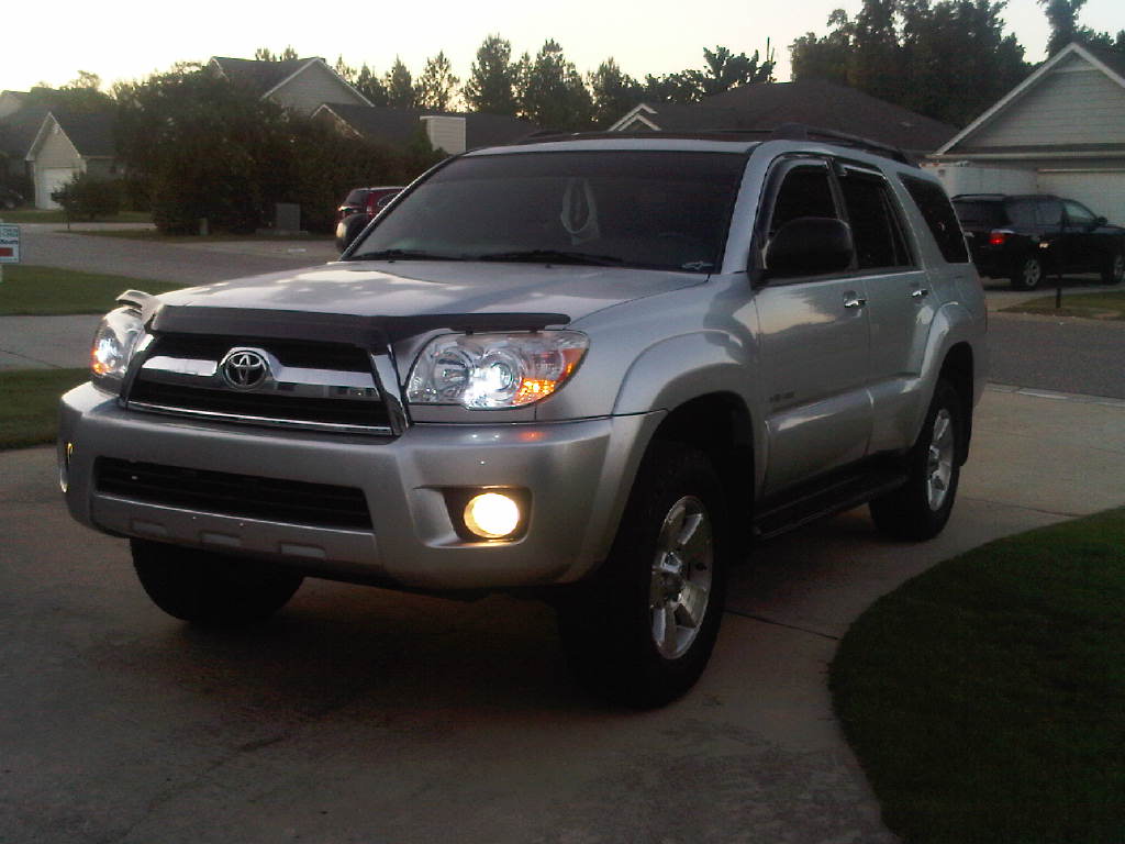

well it's nothing too special but i finally got some spidertraxx on the front a rim/tire combo from a 2000 and got them installed the other day.
my girl did all the work since she had no idea how to change a tire, i told here, well here is a chance to do it 4 times WITH a torque wrench. so far my wheels have not fallen off.
<a href="http://www.flickr.com/photos/36613889@N05/4873908545/" title="New rims and tires on the T4R by motox810, on Flickr"><img src="http://farm5.static.flickr.com/4093/4873908545_83e0d78fbd_z.jpg" width="640" height="480" alt="New rims and tires on the T4R" /></a>
Those 3rd gen wheels looks great on your runner!:thumb3: So when are you going to paint it black? Post some pics soon.
hey man hows it going. i like the rims, just wish i had that 5th one to be complete but when you find your 5th, i'll get my 5th i suppose. not planning on painting it black any time in the future but will be painting the bumper pieces black to match the grill. i had to buy spacers for the front wheels because of the backspacking caused a rub on the caliper but all is well and done right now.
thanks again!

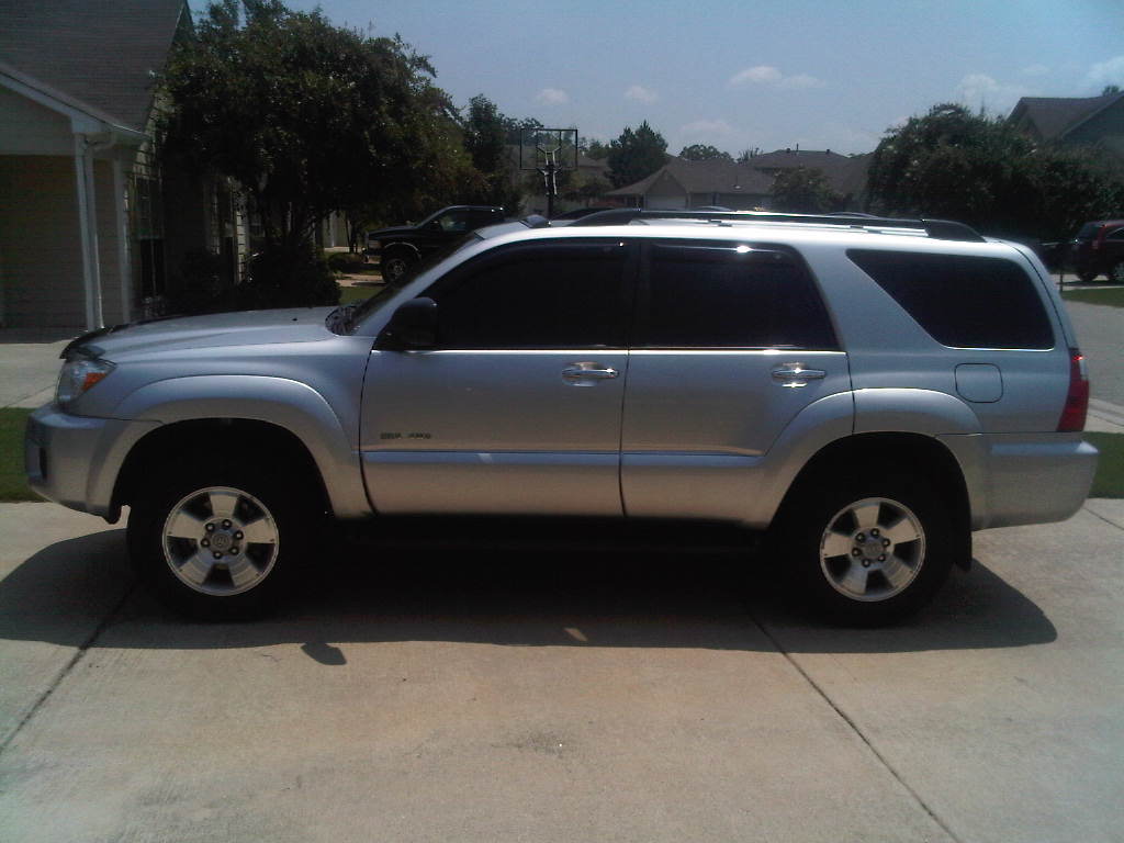

My 08 Runner after Toytech 2 1/2 inch leveling kit, with Dunlop 265"s
and of course, the "ride" didn't get worse, I honestly prefer the "lifted" ride over the stock ride..

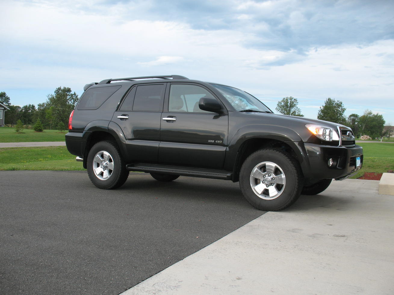

Just wanted to post a pick in here. 07 SR5 4wd full fj set up with bilsteins and a 1/4 spacer in the front and 265/70/17 timberline a/t II tires.

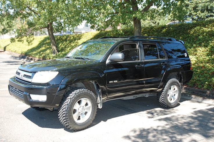

Finally got some tires after 3 months with the "lift" so I can finally post a picture in here
FJ Springs Front & Rear with 1/4" toytec spacer up front
LT265/70R17 BF Goodrich All-Terrain KO
Spidertraxx 1.25" Spacers
I had to push the fender liners forward & remove the front flaps to elimiinate scrubbing
004.jpg~original
003-2.jpg~original
001.jpg~original
GYSA 255/75/17
Spidertraxx
Daystar 2.5/1.5
Aside from some rubbing, it is absolute perfection. For me anyway.
