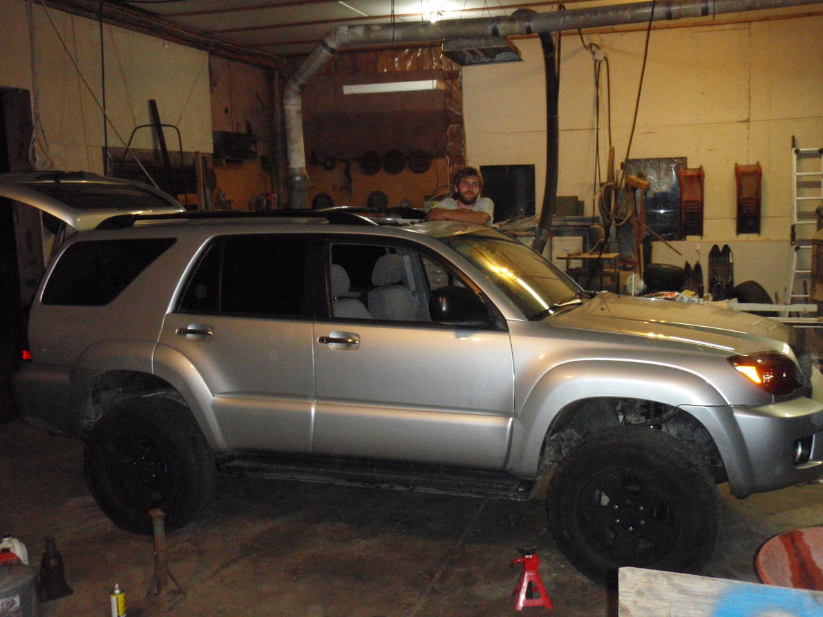

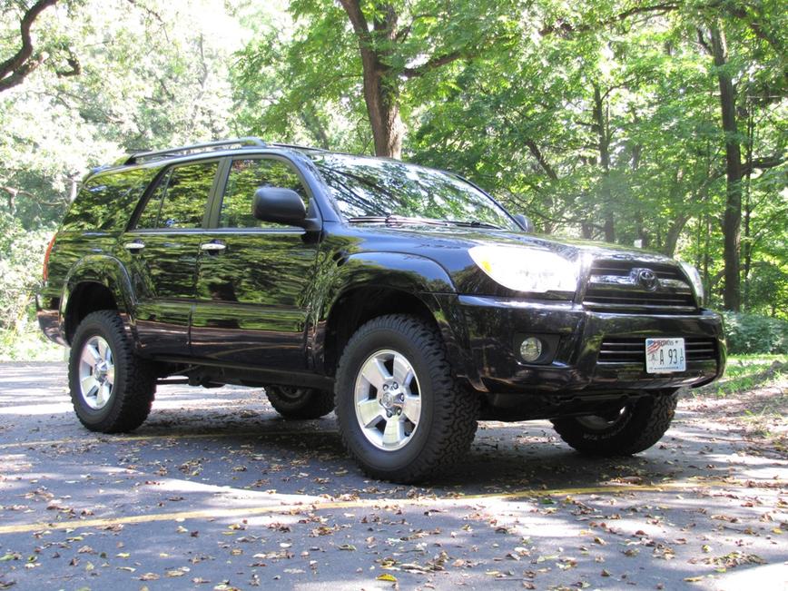

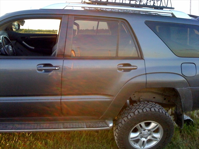

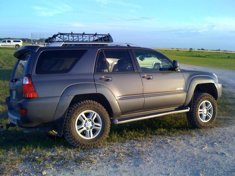

HOJ, your setup inspired me to do my lift except i went with the bilstein kit all around .
you have to move the front fender lining up which requires no trimming.
and then i had to trim off the front mud flap on the inside.
that got rid of the rubbing so none too invasive much huge gains in looks. it's way too RV camper style without the spidertrax pushing it out. it took 10 minutes for me to say heck to the no and ordered the wheel adapters right away.

Looks good, I like the Limited wheels for sure! What size tires are they?

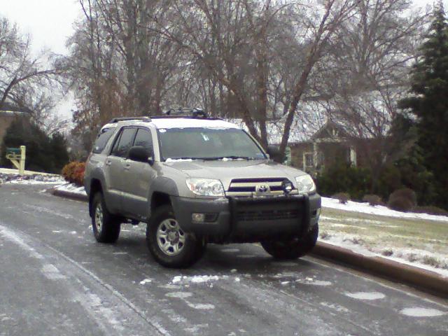

yes!!! we got matching bull bars. havent seen you on here in a while man, where'd you go?
oh and dont mind the cyclop with only one light haha, learned real quick you cant take it thru an auto wash haha good thing those lights were only 30 bucks

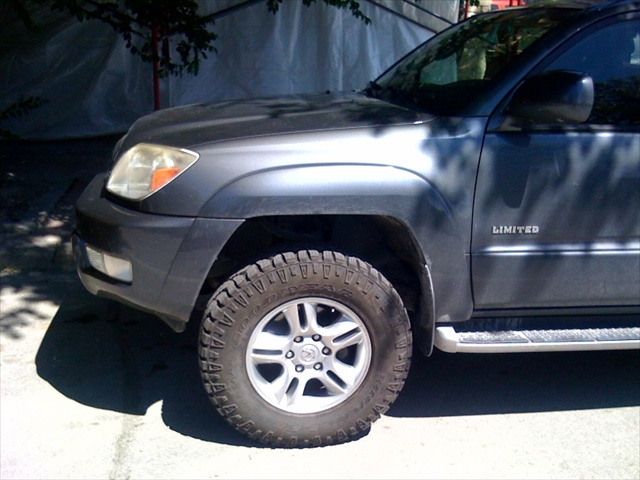

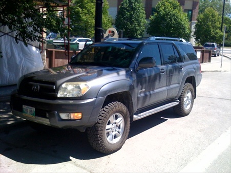

gx rims, duratrack
This thread is awesome. Who has the talent and know-how to create a message at the start of the thread with an index? That would be the perfect final touch.
The street shots have 2.5 daystar, the grass shots have ow 2.0 full kit.
Lexus GX 17" rims. Duratrac 265/70r17.
Grass shot is only about 15 deg of tilt.

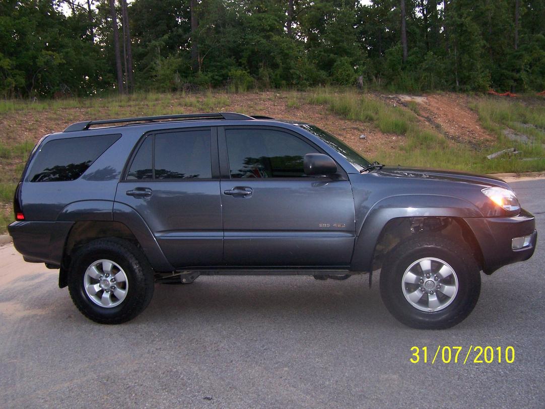

lift....finally
well i finally got my 5100's in after 3 months on back order. wtf bilstine, they need to get that handled asap. Anyway the wait was worth it. i ended up with a
about 37 in from ground to fender in the front and 38in in the back. i have a 1.25 spacer on all 4 corners, wheels are sprayed with flat black . the headlights and tail lights are painted with black and clear mix. over all it looks great and im really happy with how it all turned out.

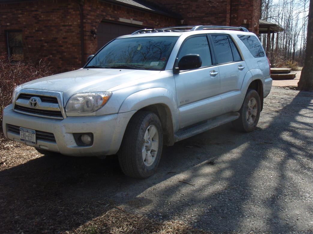

2004 v8 sr5

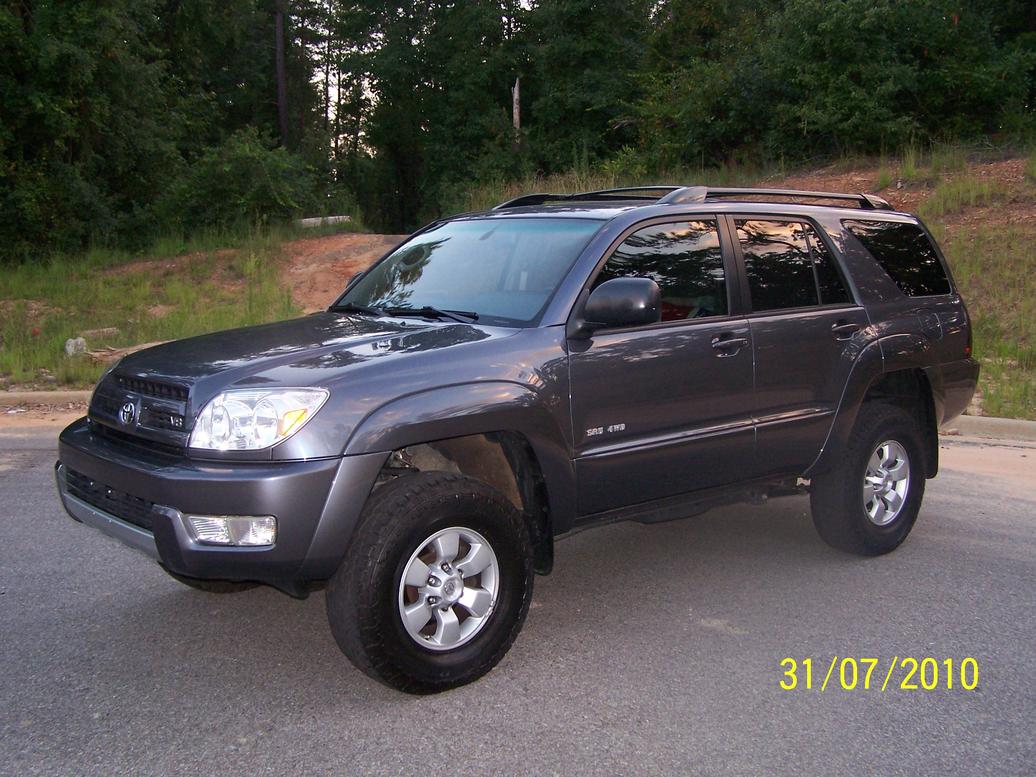

2004 V8 SR5, 265/75/16 Hankook, ?" lift, Glasspack muffler

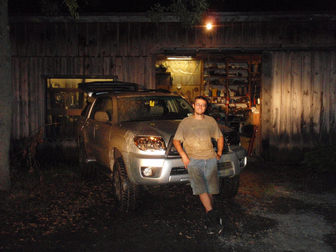

well it's nothing too special but i finally got some spidertraxx on the front a rim/tire combo from a 2000 and got them installed the other day.
my girl did all the work since she had no idea how to change a tire, i told here, well here is a chance to do it 4 times WITH a torque wrench. so far my wheels have not fallen off.

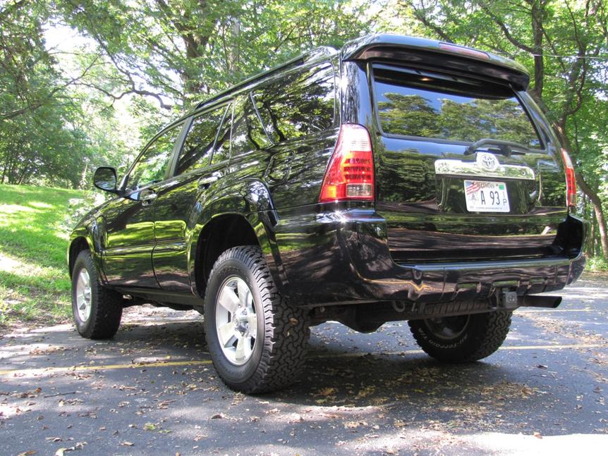

ToyTech, Pro Comp, BFG
ToyTech 3" Spacer Lift, Pro Comp 7098 Wheels, 265/70-17 BFG ATs
