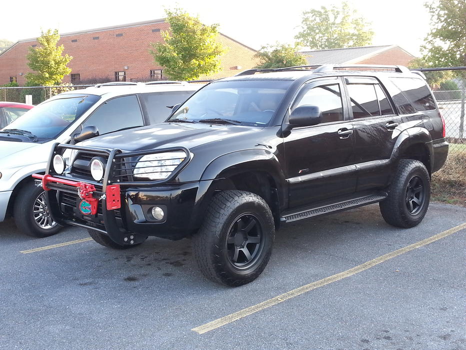

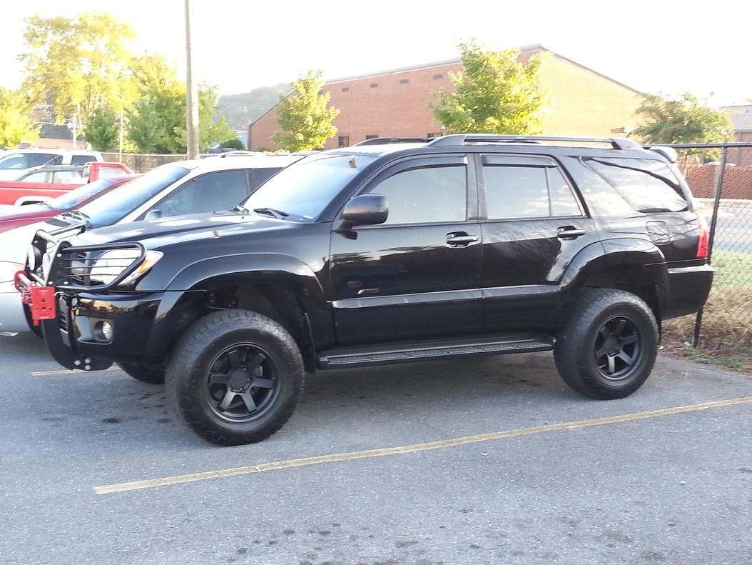

Pretty pumped with my lift today. Huge shout-out to [MENTION=65763]noiwontsmile[/MENTION] for the help (more like I was helping him). Dave at Cornfed was also great to work with!
Forgive my crude before/afters that I made using screen shots.
FJ springs, Bilstein 5100 (1.75 in front), Cornfed 1" rear
Spidertrax
Toyo Open Country AT2 265/70/17
When she first came down I was concerned about reverse rake and measured about 3.25" up front, which seemed way off/too high. It has since quickly settled out nicely, I think the running boards give a slight impression of reverse rake but it is ok and will get better. Haven't measured since.
Pics are from only an hour after the lift.

can i get info on that roof rack , its mounted to your stock rails right?
how much did it cost?
can i mount a led lightbar to it?
It is a Surco Safari Rack I got off of CL. Paid 35, disassembled it, stripped it, reinforced it, coated it with bedliner and installed tie down hooks. I coated some modified pipe brackets and used them with the existing rack. It would definately hold light bars on any/all sides. It is made up with 3/4" square aluminum tubing.

Hey theliman, I'm looking to install the same suspension, spacers and tires you have and was curious how the tire noise and mpg is compared to stock? Are you still happy with the Open Cuntry AT IIs? Would you do anything differently?
Thanks
Thanks
I would not have done anything differently. I think it sits perfect now. I'm in CO and got the tires because they are highly rated for snow. I can't speak much to their performance since I have had them only a few days, but they are very quiet (and I came from a very docile hwy tire).
As for the gas mileage, I was expecting a small drop. What I've seen is more like a drop of 4-5, however, this is using the computer, not hand-calculating. I was able to do roughly 20mpg around town before, now it's about 16 driving as conservatively as I can. When I hit the highway at 60mph, I'm getting 27mpg. So I think it makes sense to see those "city" drops when more of the driving is accelerating, 'cause that's when the size and weight of the tires matters more.
Not thrilled for the drop, but I knew it would happen going into it and I still think it's worth it because it looks AWESOME. And the tires look much better in person. FYI, got for $750 installed at Discount Tire.
