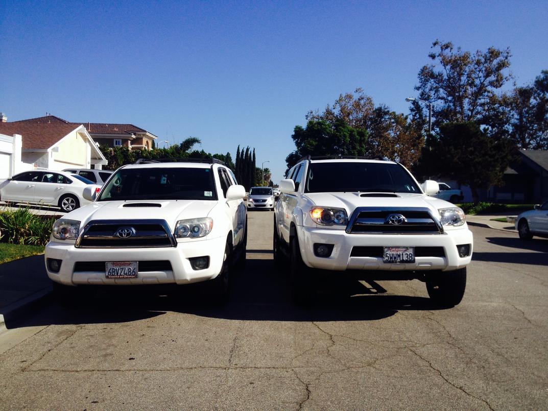

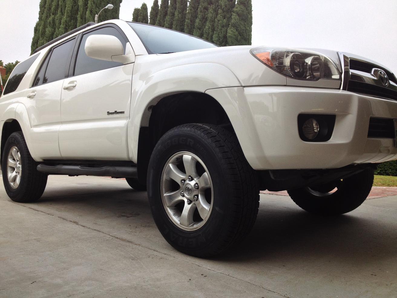

2006 T4R Sport w/ FJ Springs, 5100 @ 1.75", Spidertrax, 265/70R17 General Grabber HTS
Due to overwhelming success that people have had doing the FJ upgrade, I finally bit the bullet and did it myself. Finished the lift this weekend! Took it out and hit the trails with it and i gotta say, my 4Runner has never felt so confident to drive. No rubs, no rattles, no squeaks - its perfect! The FJ upgrade is volumes better than the factory XREAS suspension.
Here is what i did:
- 4x4 FJ Springs front and back
- Factory Tokiko FJ shocks on rear
- Bilstein 5100s up front set to second notch from the top (1.75")
- Spidertrax on all 4 corners
- Upped the tires to 265/70R17 General Grabber HTS (AWESOME All-Season TIRE)

I just did the same set up last week. I've got about 500 miles on it and the ass-end settled a little. I'm likely adding a spacer or an Air-lift kit. How does the rear of yours sit right now?
Congrats on the lift! Its a huge upgrade IMO - The rear of mine is still sitting about 2 inches higher than it does stock, the front is still about 4" higher than stock. Its looking very level. Loving it! As for settling, i beat the crap out of the truck last night on some rocky trails, if its going to do any settling it should have done it after that for sure. I'll keep you posted if i notice any difference in the coming miles.

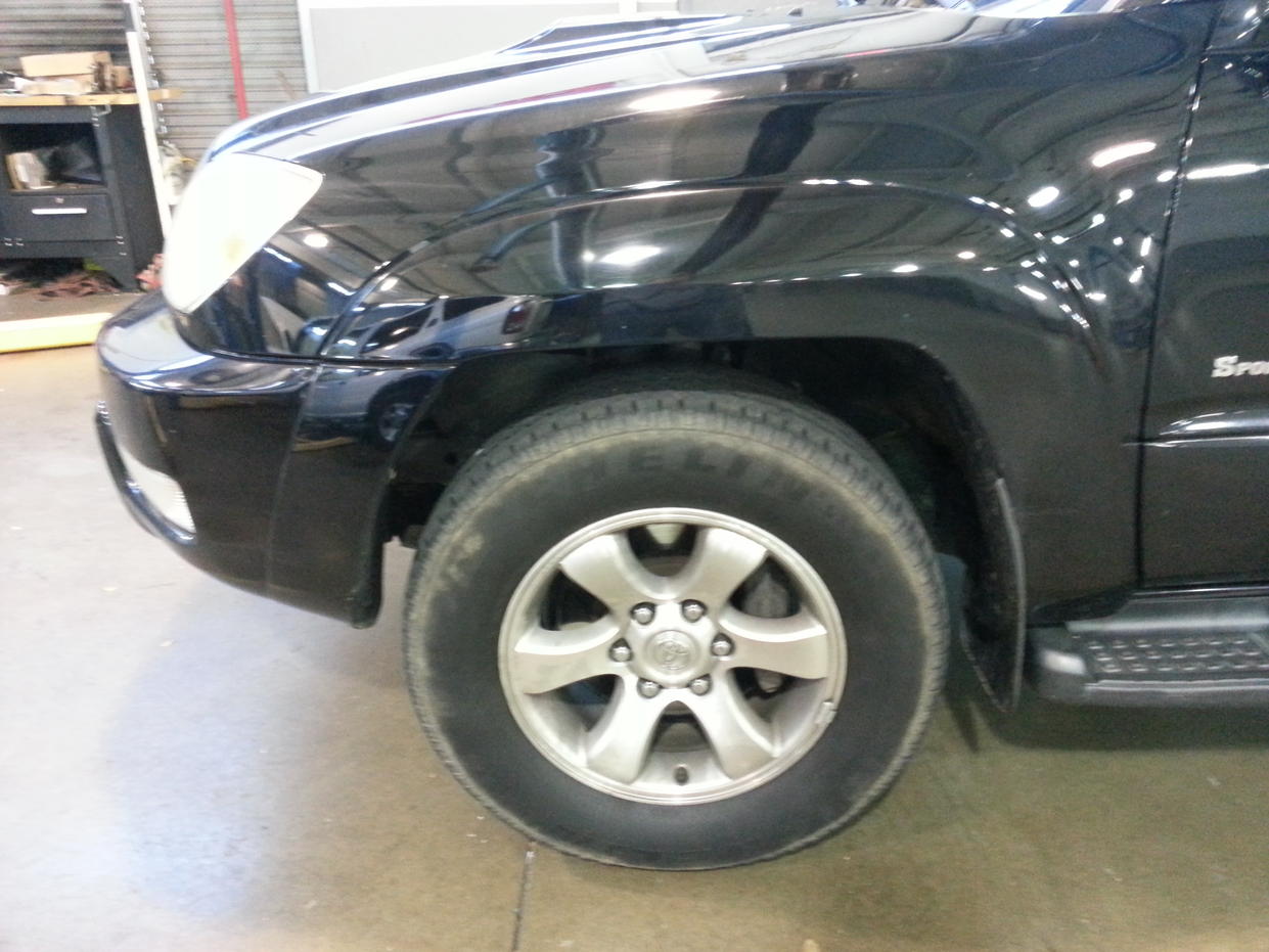

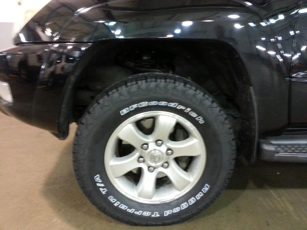

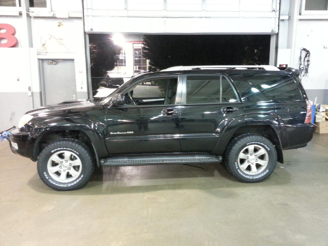

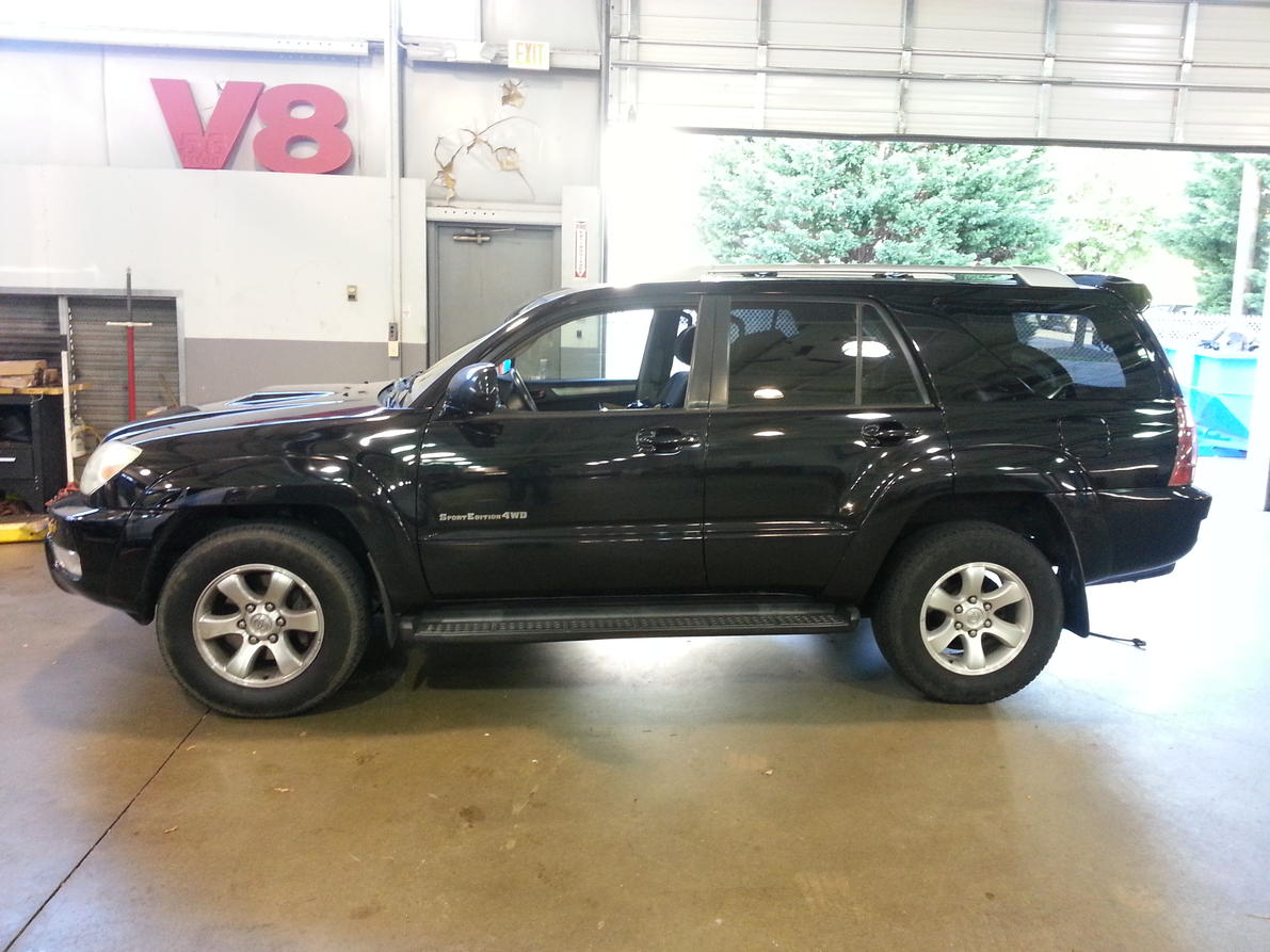

Daystar 2.5 Easy Install Leveling Kit. Stock Rear
This evening I installed the Daystar 2.5 Front Leveling Kit and could not be happier. I was a little concerned about the stud extensions; however, after install I am very confident. Unfortunately, during the install I noted a busted CV boot which I am not looking forward to, but a story for another day. I really appreciate this forum, it allowed me to view and choose the exact kit I wanted. I look forward to more mods in the future and get a lot of ideas from here. Cheers. Eric P
