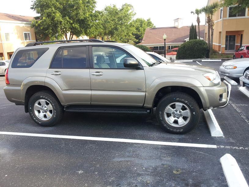

Which lift to use?
Torn if I want to use the Daystar 2.5/1.5 or the Toytec 3". Plan on getting bigger tires a little later, running Pirelli Scorpion ATR 265/70/17 now. Not sure of what the total look would be. Any suggestions?
It would look good with the 265/70/17's and some black wheels, whether it be plastidip or different wheels!
The real question is if you're going to actually wheel it or if you're just lifting for looks. If you're going for looks, do the daystar. If you want performance, do the toytec and 5100's. And take out your sway bar while you're in there :)
I thought about powder coating the inside of the rims and leaving the just the star chrome. I'm looking at putting BFG T/A KO 285/70/17 under it and want to make sure I have enough clearance without cutting to much out. I don't do a lot of off road, but she does she mud from time to time.
I'm looking at putting BFG T/A KO 285/70/17 under it and want to make sure I have enough clearance without cutting to much out...
Good luck with that... most of us have been there, done that - and we all had to lift/chop/cut/pinch/modify to some degree to fit a 285 series tire. It's not hard work getting them to fit, but it does take some modifications to clear everything properly.
Good luck!
Good luck!
I have talked to some other people and rethinking the 285's. I don't really want to have to cut to much into the truck. I see so many amazing set ups on here.. it's hard to decide what to make the final decision. The hunt continues.

I am torn on which lift to use for a little more lift all around. Looking at the Daystar 2.5 front / 1.5 back, or the Toytec 3". I do plan to put bigger tires at a later date and still want to be able to keep a decent ride. Any suggestions would be greatly appreciated.
I see that your signature states that you already have billies 5100's. Just buy superflex coils for the rear and ome 884 coils for the front.--->http://toyteclifts.3dcartstores.com/3-FJ-Lift-w-front-rear-coils_p_157.html
I see that your signature states that you already have billies 5100's. Just buy superflex coils for the rear and ome 884 coils for the front.--->3" FJ Lift w/ front & rear coils
I clicked the link, with the 5100s you wouldn'd need tge spacer for the front would you? With 5100s and 884 springs could you get more than 3 inches of lift? If i went with 2 inches of lift in the back, I'd probably want more than 3 up front.

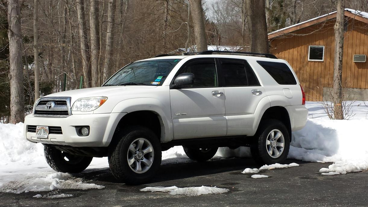

So... this happened: Toytec Ultimate with diff drop and LR UCAs. I left the DS spacer on the drivers side rear and it is sitting pretty level. Better pictures to come after it settles a bit.
