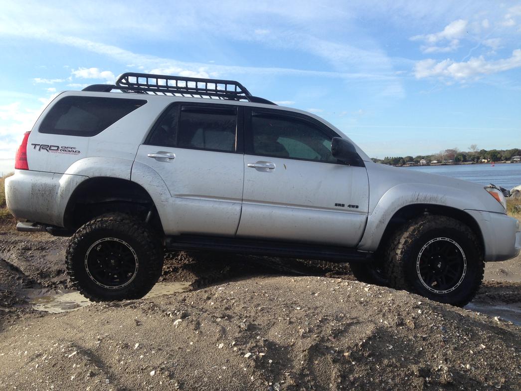

So... this happened: Toytec Ultimate with diff drop and LR UCAs. I left the DS spacer on the drivers side rear and it is sitting pretty level. Better pictures to come after it settles a bit.
It'll be a while but I think this is what I have decided on as well. Which size DS spacer did you put on the rear drivers side? For the front, did you just install them the way toytec sent them? Did you adjust the coilovers at all or the Bilsteins?
DS spacer is the same one for that location on the 2.5/1.5 leveling kit. The coil-over is adjusted slightly on the drivers side to make it level, but not much.

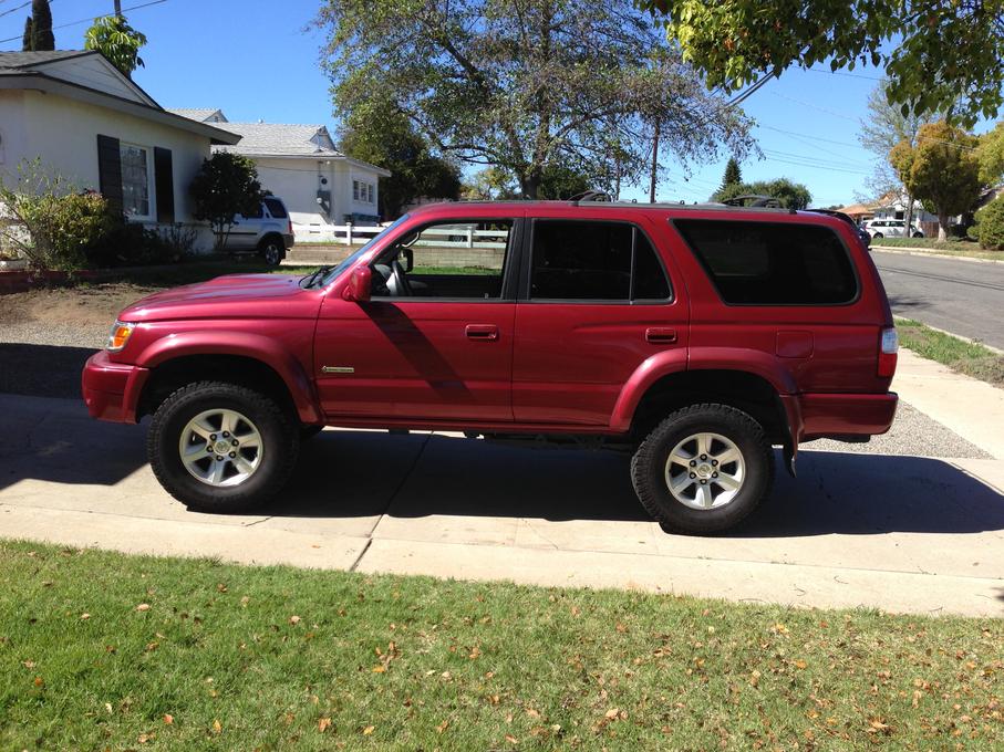

I clicked the link, with the 5100s you wouldn'd need tge spacer for the front would you? With 5100s and 884 springs could you get more than 3 inches of lift? If i went with 2 inches of lift in the back, I'd probably want more than 3 up front.
I don't think you'll need the top plate spacer in the kit with the use of 5100's. If you like you can get the top plat spacer for additional height but you don't need more than 3" lift up front with 2" rear lift, unless you are going for the Pre-runner look. Is yours 2wd or 4wd?
Mack, It rides really well. I havn't had it off-road yet, but it does well on the highway. The steering is a little looser than with the DS kit, which was much tighter than stock.

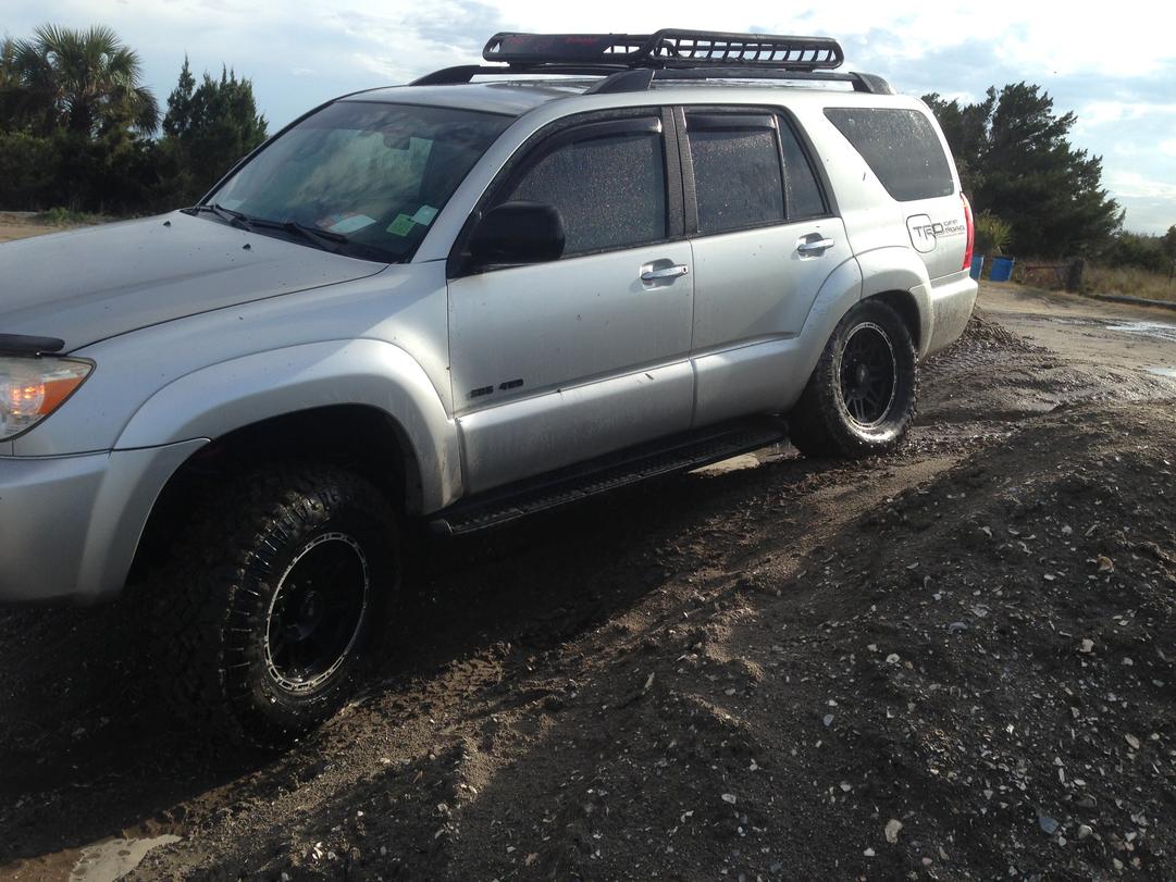

285/70/17 hankook dynapro MT's on MB wheels TKO 17x8.5 -6mm offset

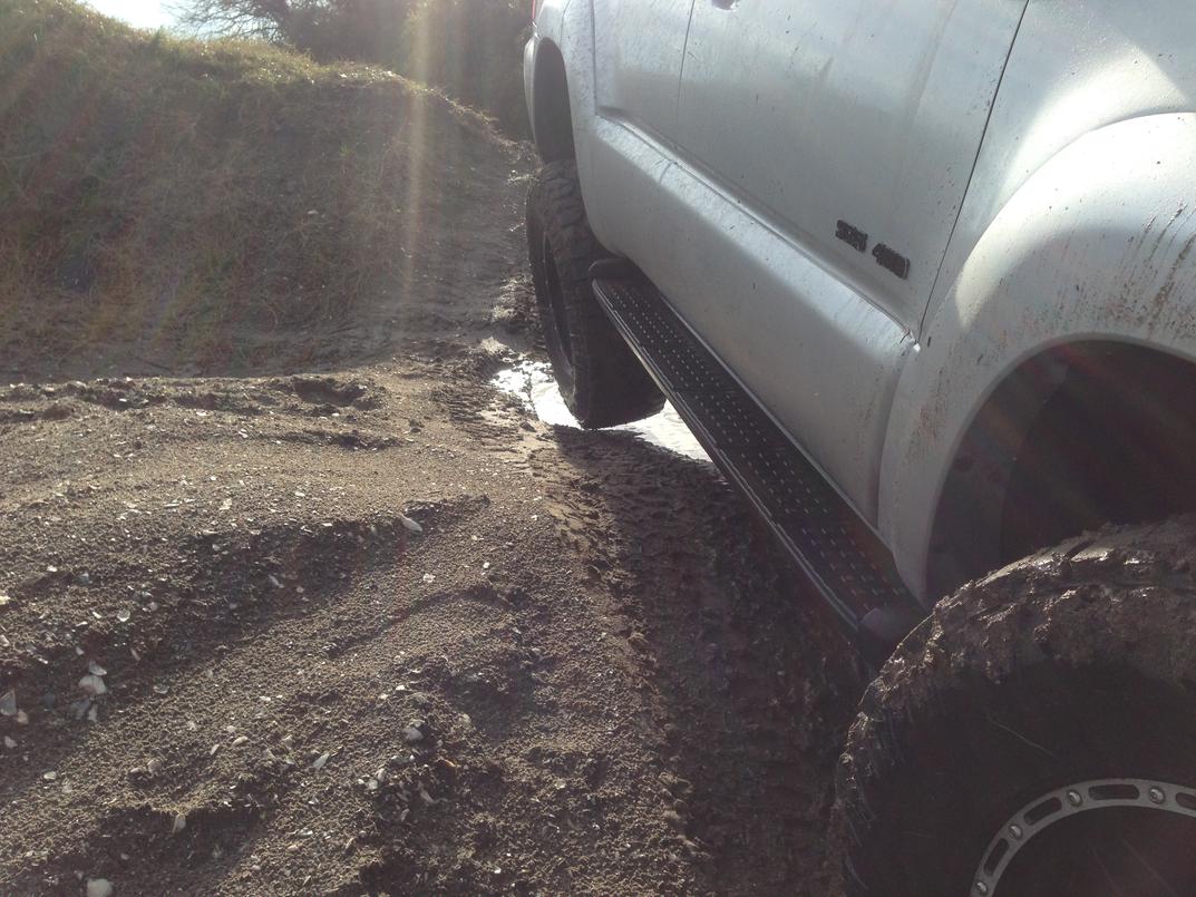

New 285/70/17 GY Duratracs
Took my new tires out for a spin. These tires are nice! I replaced my BFG 275s with these and could not be happier.
Handle well on the road, and really good Off road.

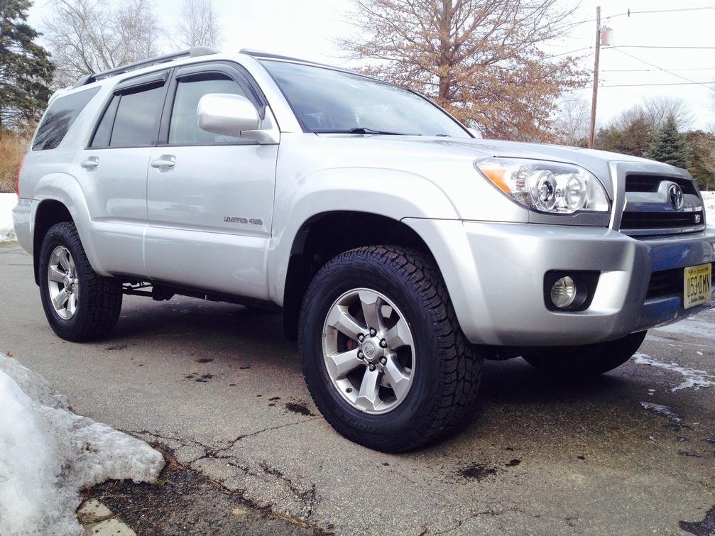

I got my tax refund a few weeks ago. Just simple taxes. I used my refund to upgrade the runner. At 171k miles, the old, beat up xreas had seen better days, as well as the BFG All Terrain LT265/65/18 load E with 89k miles. Out with that, as well as the front springs. I kept the stick air ride because I like how it keeps an even stance even with a heavy load. I installed new Moog 07-09 FJ 4x4 front springs, and the adjustable Bilstein 5100 in the front set at 1.75(second notch from the top).
[MENTION=44866]ARK_SWAMP_RIDER[/MENTION] advised me against using the 5100 shocks in the back with the air springs due to them being longer than stock, so I went with the Bilstein 4600s in the back.
I bought new LT 275/65/18 Cooper Discoverer AT3 load C, and had them installed as well.
My buddy is a mechanic and did the work. In the process, he popped the front driver side cv axle, and installed a new one free of charge.
The old xreas shocks were in bad shape. 3/4 were leaking from the top, and the back two covers were rusted off.
Overall, the ride is a little stiffer than before. I didn't know how much stiffer the moogs were, but I'm happy with the result. The runner now sits nearly level from front to back in terms of ground to wheel well. The front is around 36/36.5"(driver side/passenger side), and the back is around 36.75". I know the front will probably settle a little, but not sure how long that takes. I've driven about 100 or so miles so far since the change on Friday.
