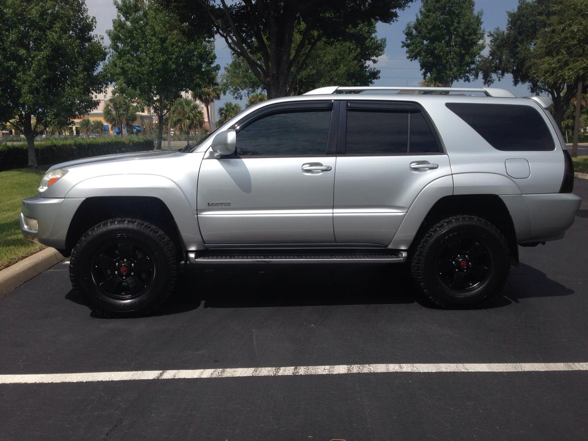

I can finally post on here!
Setup:
- Daystar KT09115BK
- 18" Ultra Gauntlets
- Cooper Discoverer A/T3 265/65R18
So the TRD center cap fit without any problem from the dust cap for the front wheels?
No problem at all... they just pop right in. These are the Toyota-specific wheels that became available earlier this year. Dustin at FN Wheels hooked up the Toyota crowd with some awesome hub-centric wheels with centers that are specifically machined to accept the TRD center caps.

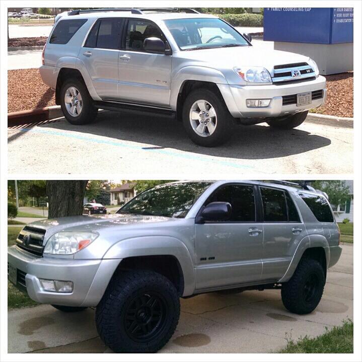

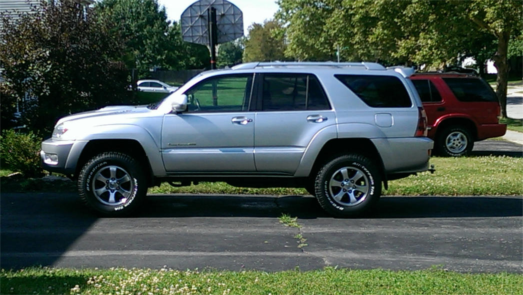

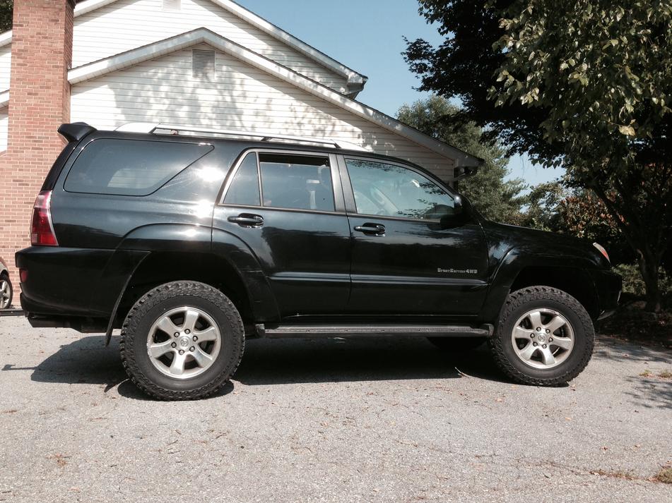

My Lift/ Tire combo
Thanks to this forum for all the help in me completing this; I lurk. Took a long time to get the info I wanted, hope this helps.
Lift:
Bilstein 5100 all around
Front coils OME 885, set at "0" or stock position on struts.
Icon/toytec/ eibach 2" rears (confirmed by the toytec folks that they are all the same coil).
Firestone air bags.
Tires:
LT 255/75/17
Cooper S/T Maxx
Pre-lift:all measurements from ground to fender, stock size rubber (~135k mi. X-REAS)
FD:33 1/8 FP: 33 3/8 RD: 35 5/16 RP: 35 5/8
Post lift, stock rubber
FD: 36 5/16 FP: 36 9/16 RD: 38 11/16 RP: 38 3/4
Post lift, after some driving and new tires:
FD: 37 1/8 FP: 37 1/2 RD: 39 1/16 RP: 39 1/2
Love the results. Took it off road a little bit, feels more truck-like. On road, slightly stiffer than stock. Tires are new so don't have a lot of experience with them yet, but I like them so far. No too loud on the road at highway speeds.
Airbags give about 1/4-1/2 in lift, but really are great for when pulling a trailer.

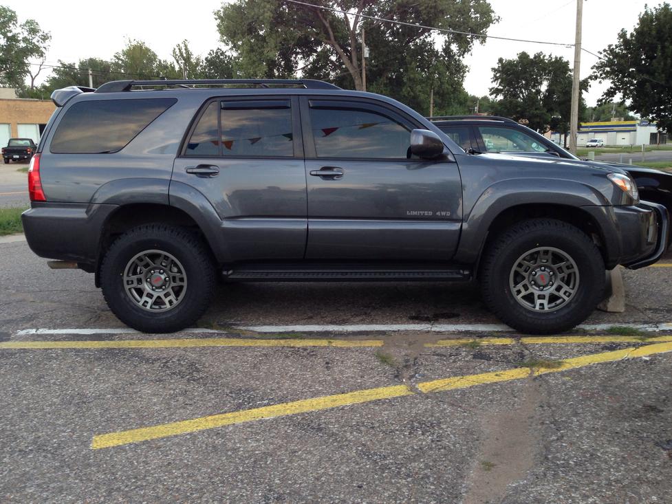

2.5F/1R with Airlift 1000, 285/70/17 Yokohama Geolandar AT/S, TRD Trail FJ Wheels, no spacers, no body chop, just some trimming, no rubbing as of yet.

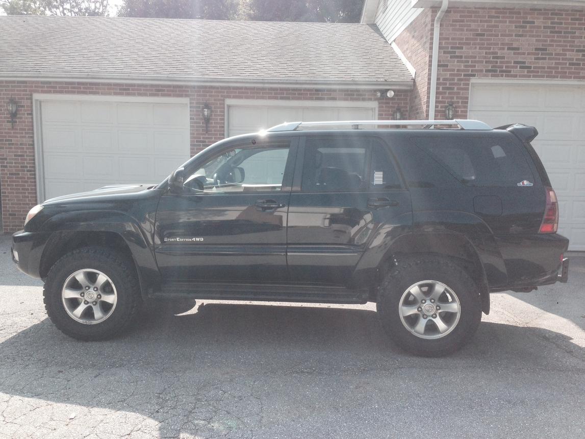

I need some help. I knew the fit would be tight with stock rims but looks like I need rims with an offset. Rubbing he frame when turning into parking spaces. Any recommendations?
BFG AT 285 70R17
I may be looking at selling my current stock limited wheels so I can buy wheels with a -6 or -10 offset. 17x7.5 powder coated black. If anyone is interested let me know.

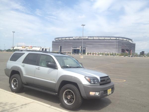

re:
Finally I can post on this thread.
While not as flashy as others I like it.
2004 V6 Sport - 265/70/17s BFG ATs & the Daystar 2.5/1.5.
Spidertrax Spacers.

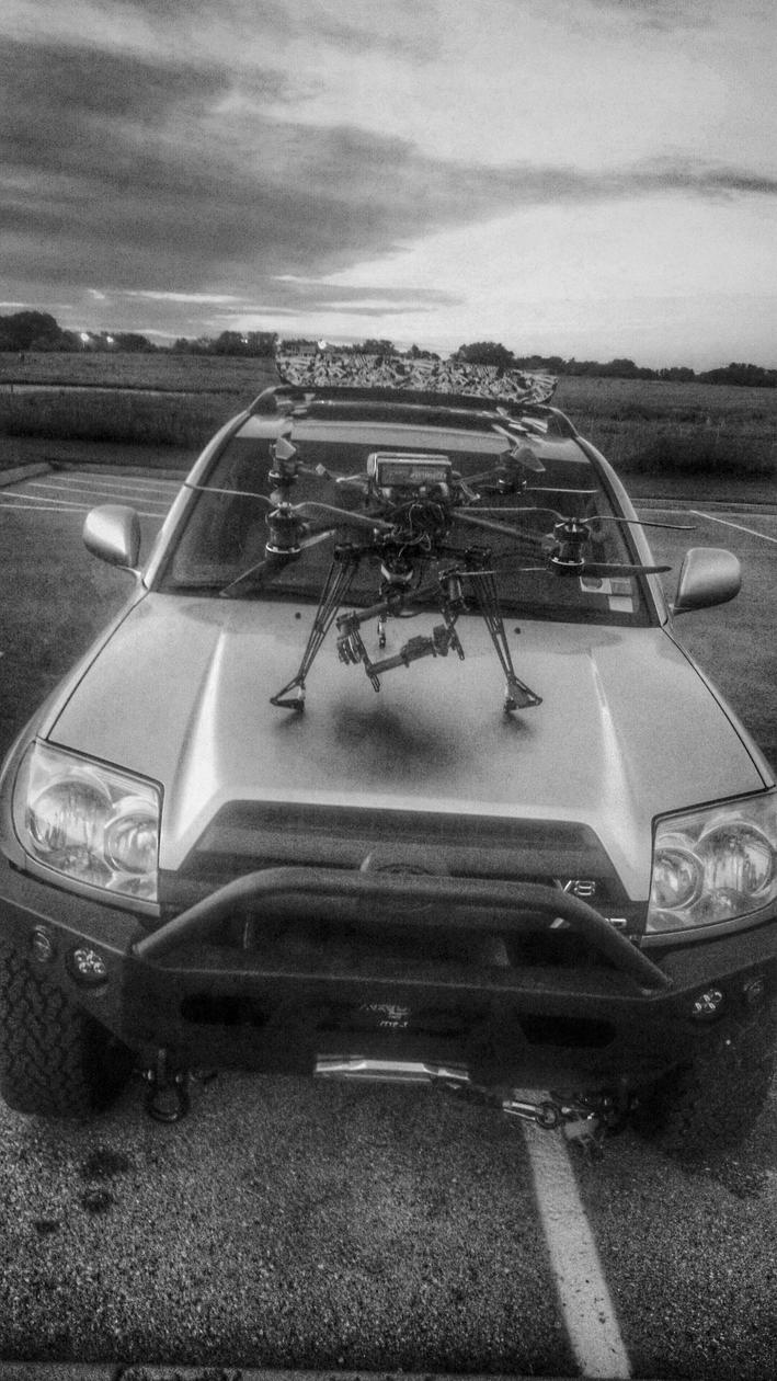

Thanks I got bilsteins 5100 with 886 in front and superflex in rear. I'm thinking getting bigger tires and a body lift.
I just added the roll roof rack with custom fairing and personal drone if you are lost in the woods.
cheers

Damn how much did that drone cost?!?
