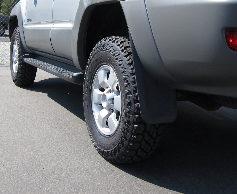

Finally got my 255/75/17 Duratracs. Made my own load bars, and removed mud flaps.. thanx for all the help to those who gave me some knowledge on the 255s..

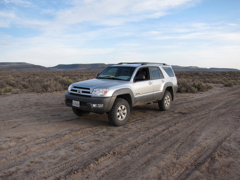

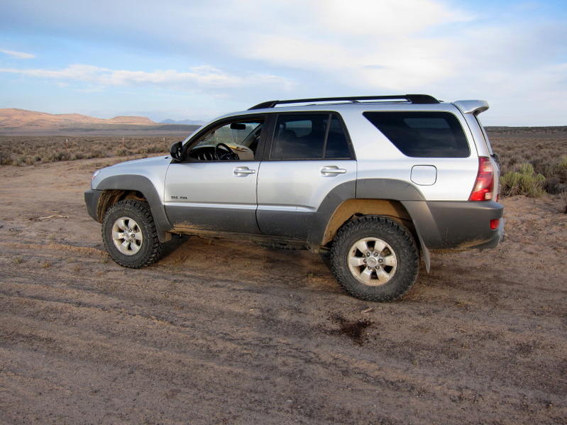

I'm finally getting my 03 ready for off road. I went with the Biltsteins all around with the front set at 2.5 and 2 inch Toytec Super Flex in the rear. Still has the rake but I'm good with it. I put 4 new 236/85/16 (32's) Cooper St Maxx tires on and headed for the Nevada desert after taking the floorboards off. I'm very happy with the set up now. Handles great and looks a lot better than stock.

I'm finally getting my 05 ready for off road. I went with the Biltsteins all around with the front set at 2.5 and 2 inch Toytec Super Flex in the rear. Still has the rake but I'm good with it. I put 4 new 236/85/16 (32's) Cooper St Maxx tires on and headed for the Nevada desert after taking the floorboards off. I'm very happy with the set up now. Handles great and looks a lot better than stock.
That's an interesting tire size.
Where do you put your feet without floorboards?
Do you like the ST Maxx?
Well......maybe not floorboards...runningboards work? LOL!
I've got about 1200 miles on the tires now and so far, so good. The tire guy tried to talk me out of them. He said Cooper has changed their compound and I may not get very good mileage out of them. I just liked them and thought with the weight of the truck being light and the tires 10 ply with 3 ply sidewalls, I'd get 25,000 or so out of them.
I ran them through deep mud and rocks for about 250 miles out in the desert and did not spin a wheel. They're quite enough for me on the highway. I like 'em so far.
