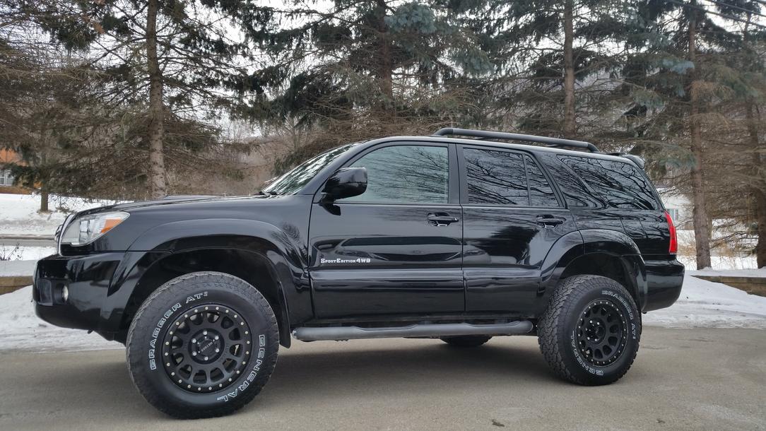

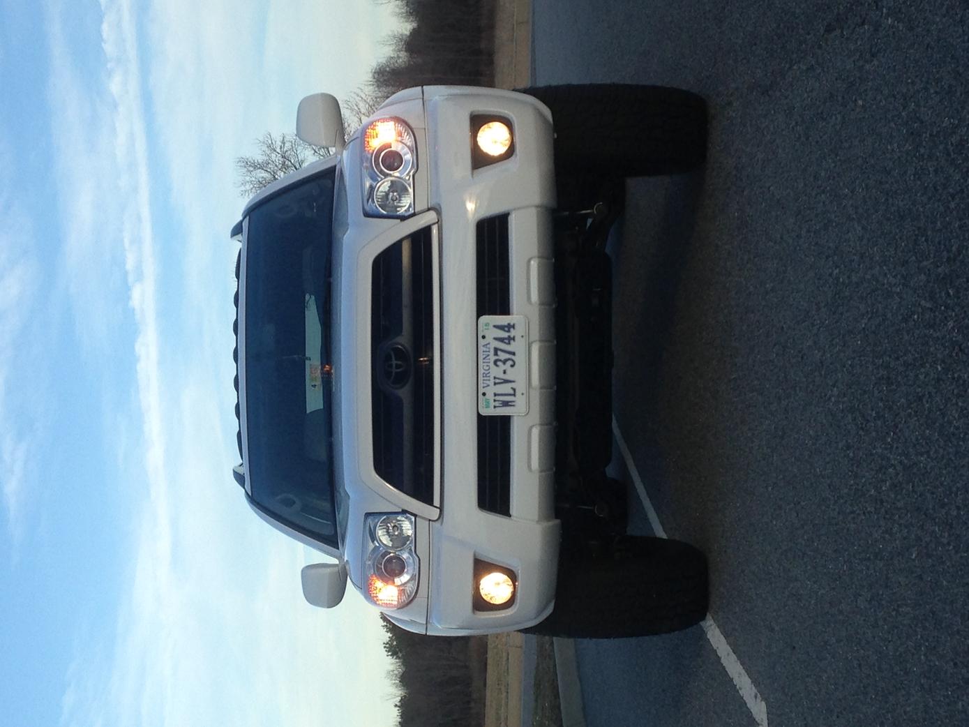

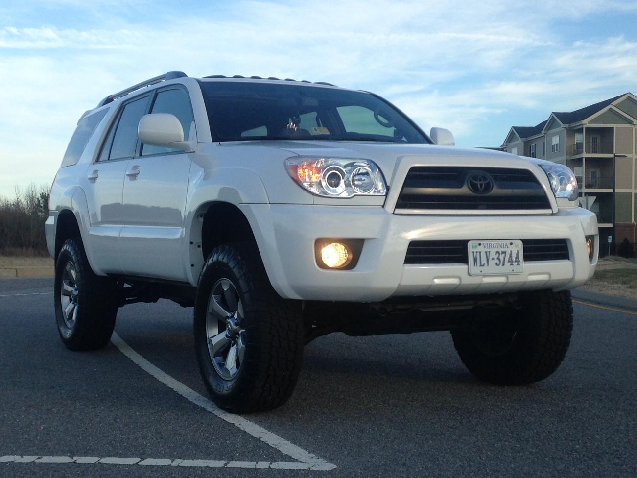

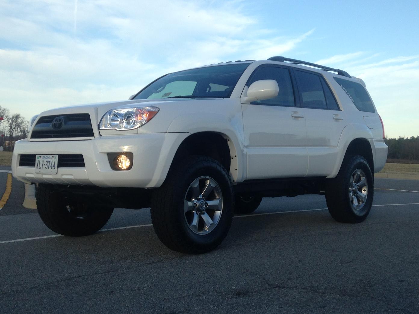

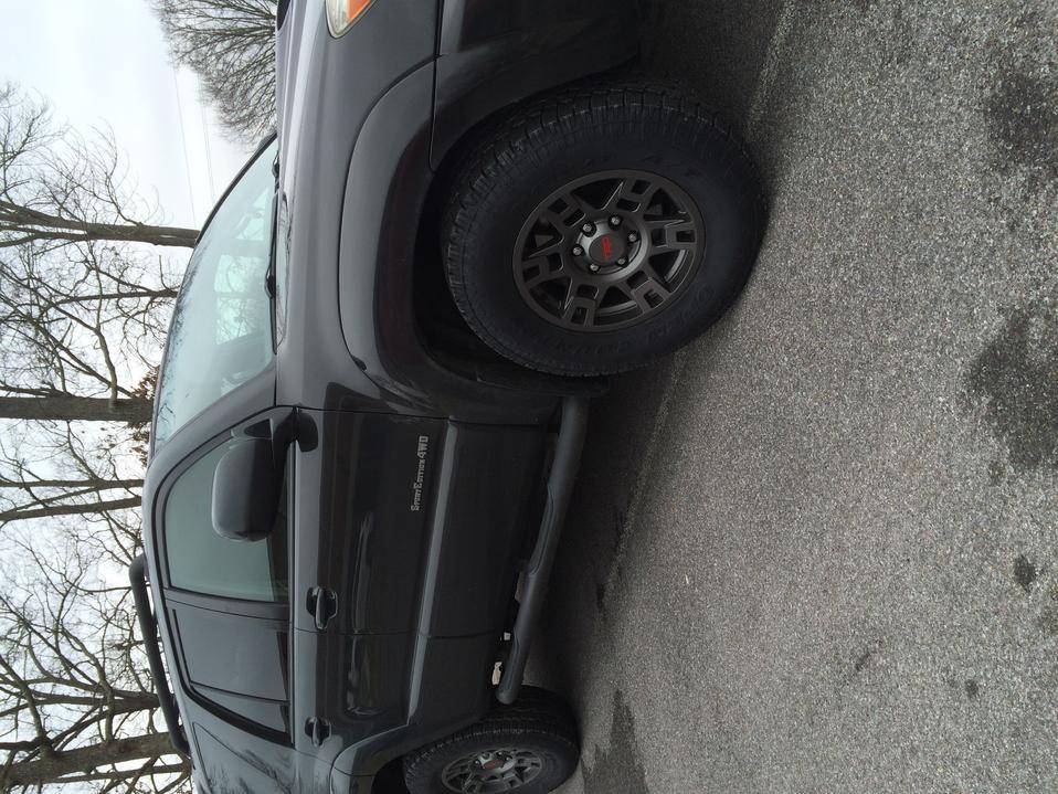

2007 Sport w/ TRD PRO wheels
TRD PRO wheels with Toyo Open Country A/T II 265/70/17
Description in signature, Any questions just ask!

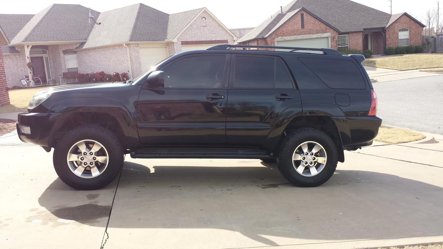

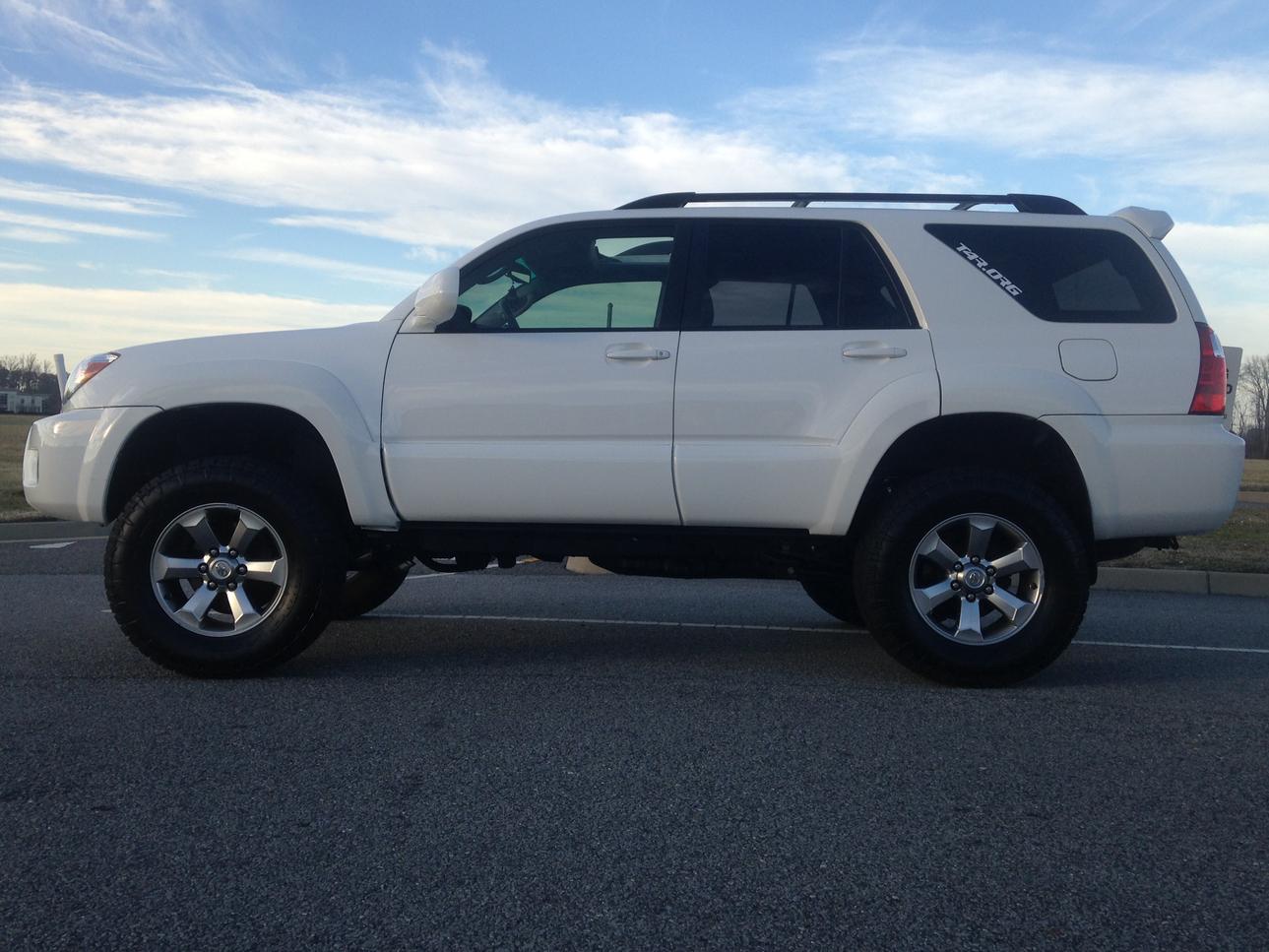

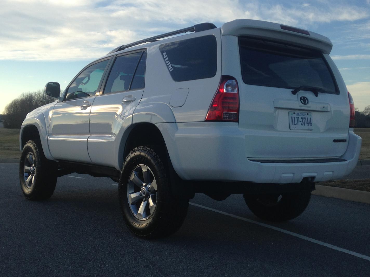

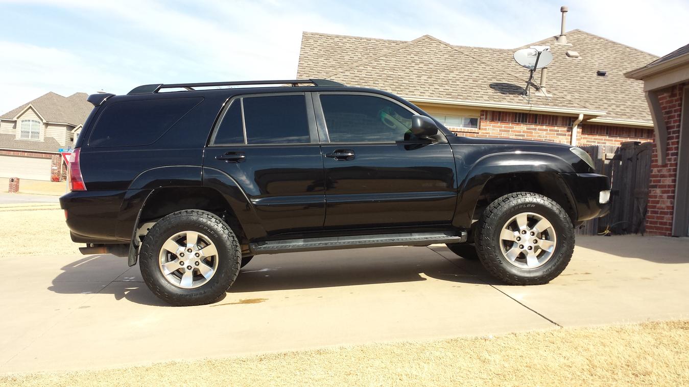

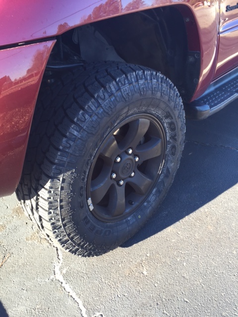

Got new tires installed today. Toyo Open Country AT2, LT: 265/70/17

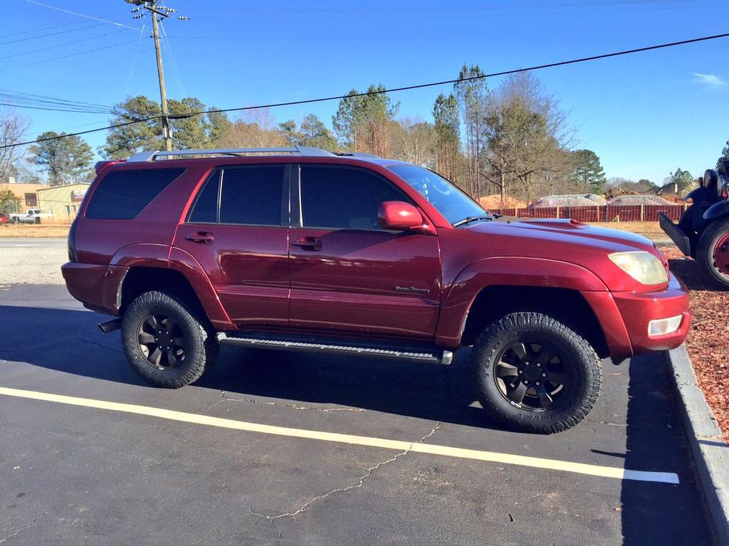

Here it is Doozi, thank you for the suggestion. I did end up with the cheaper tires, GENERAL GRABBER AT2. I like the look a lot.
