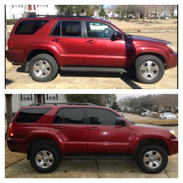

1400$, 8hrs, and 1 unhappy wife later... Lifted!
2006 SR5, V6, 4x4
3 inch Toyotec complete suspension lift in front
3 inch Rough Country springs and shocks from an FJ Cruiser in rear
16 inch DC2's and 285/75 16 General Grabber AT2 tires
I know it sounds a bit goofy to mix brands, but I was working on a tight budget. I was unsure at first, but when I finally got it all together, I was really pleased with the height, how level and sturdy everything is. There is no noticeable difference in stiffness and reaction.
I wonder if most of these parts are made by the same people and just stamp different names in them.

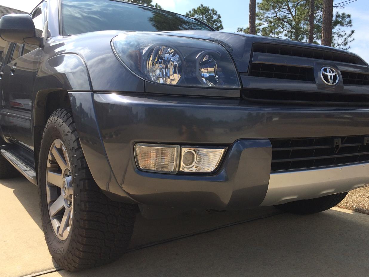

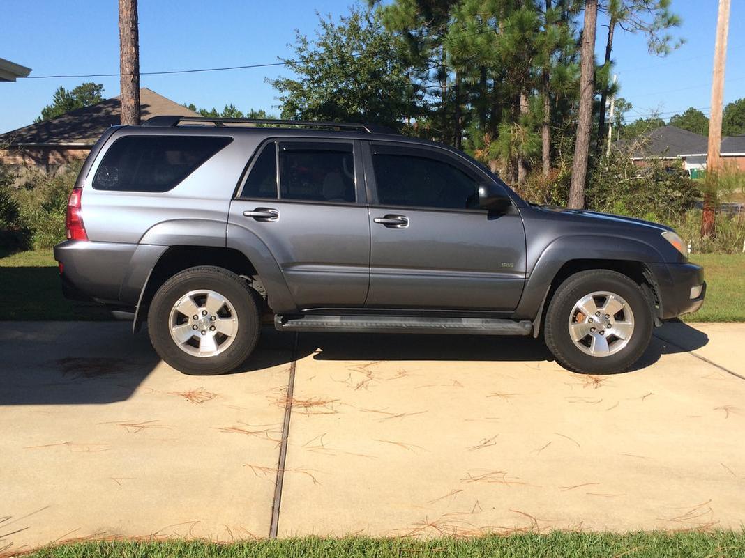

Wheels
Got a real good deal on a brand new set off of a 2015 4Runner, just added some new Terra Grapplers. Next mod is going to be all new Bilstein shocks and ride height adjustables up front to level it off.

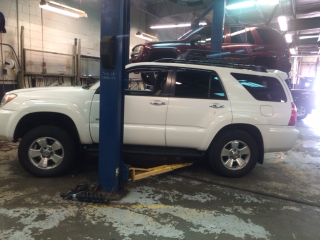

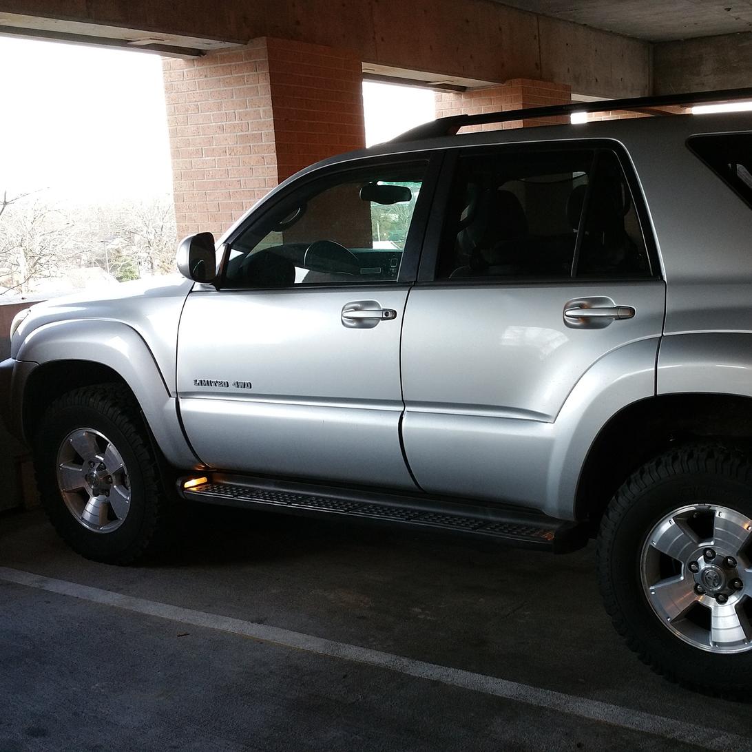

Not the best picture, but this is my month-old (ish) 2006 Limited V8 4x4. I traded in a rusted 04 V8 that I bought in Cleveland for this Southern one with no rust. I had them take my tires and wheels off (BFG A/T 265/70/17), and I bought Bilstien 5100s all around and a Daystar rear 1.5" spacer and had it installed here in Little Rock two days ago. ARK_SWAMP_RIDER was kind enough to offer his help to install this, as did llennium, but my schedule plus a back injury ended up squashing those plans. Huge thanks to them for even offering, though. There's good people on this board. I'd slowly like to build this up, but I'm happy with it thus way for now.

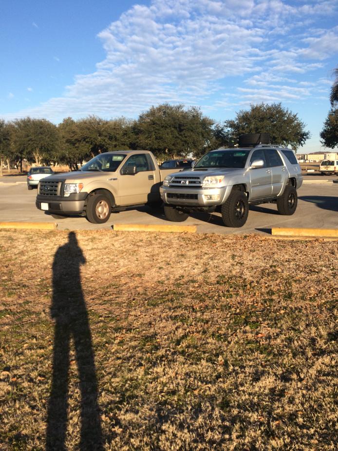

My toy...
Suspension
Front: Icon/MetalTech 2.5 coilovers and Total Chaos UCAs
Rear: MetalTech 3" HD Springs, Icon 2.0 shocks
Plus: Roger Brown 1.5" body lift
Wheels
SCS SR-8
Size: 17 x 8.5
Bolt Pattern: 6 x 5.5
Hubcentric: Yes
Backspacing: 4.30”
Offset: -10mm
Tires
295/70r17 Nitto Terra Grappler G2s
Next to stock F-150

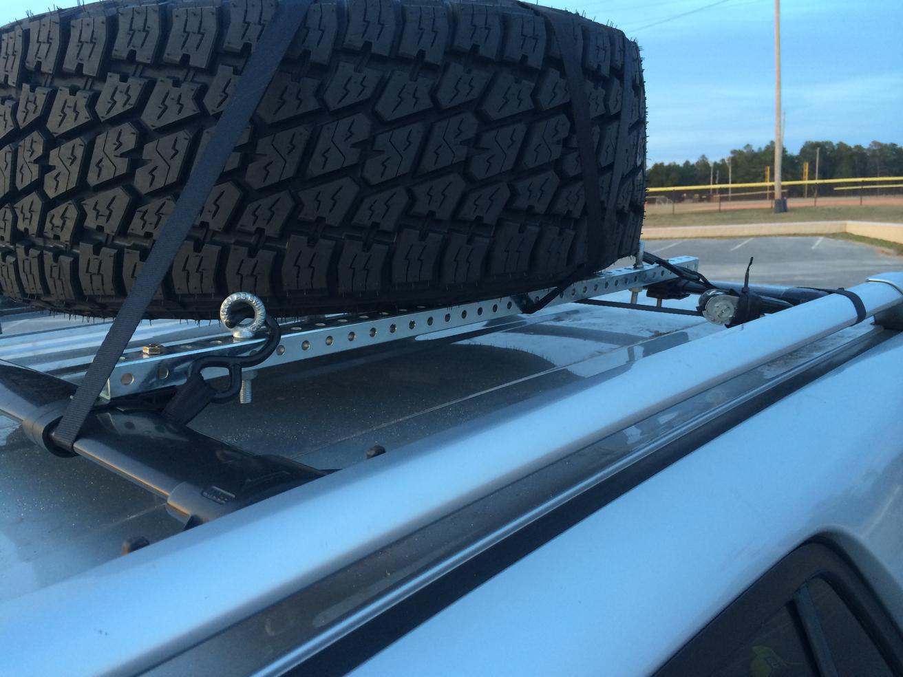

I love those wheels, really sweet. No problems with the spare over the roof rack? Was thinking of doing the same for a run soon.

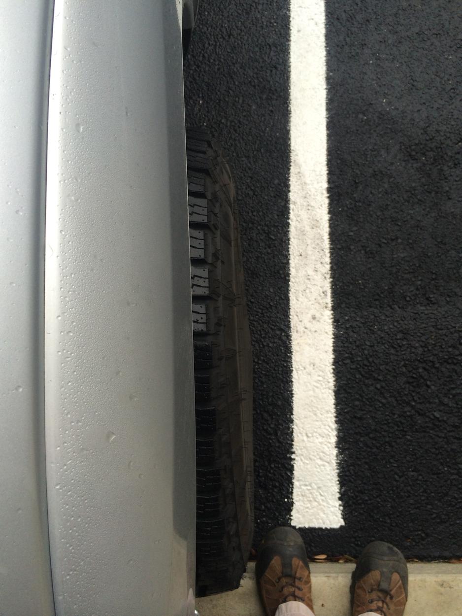

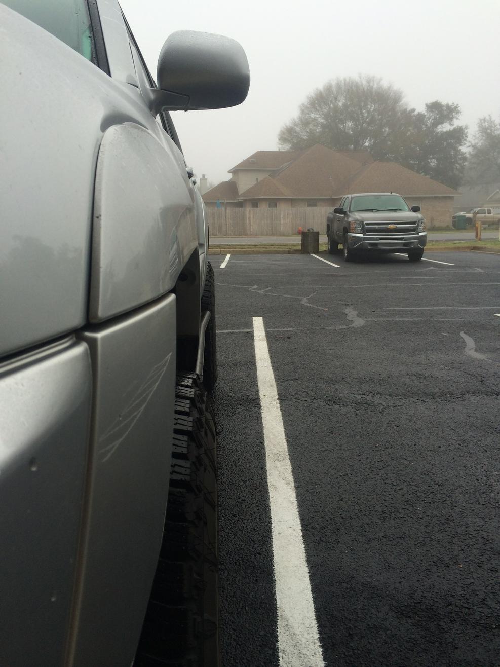

Can you show me a side shot that show how far the tires stick out? I think that is the same offset look I am going for and you have close to the same size tires as me too! ;)
Theo85: The stock roof rack isn't really made for that kind of weight (for long). I had mine up there for about a week, but it was making all kinds of noise and clearly not being held well. So: I built a "ghetto" roof rack with spare parts and some Yakima mighty mounts (Don't worry, more straps and a cable lock were added- before it goes anywhere, the truck is rolling). :)
This is a temporary fix as well. To be honest: it's loud and acts like a sail in a good wind. I've got a rear bumper in the works, but need a place to keep that stuff til then.
However, for a short run, I'd say go for it.

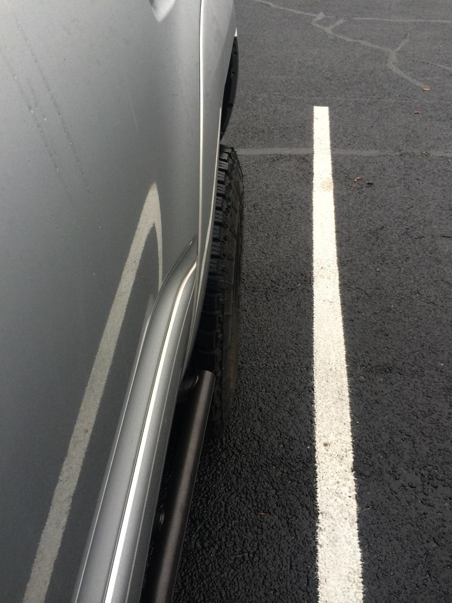

T-Man: hope these help:
Looking down the side:
Down from top of front fender:
Downish from rear:
They don't stick out but a tiny bit from the sliders, and the sliders are tucked tight enough that I need to bend them down a tiny bit to save paint on the bottom of the rear doors.

Perfect! Thanks man, appreciate it!
