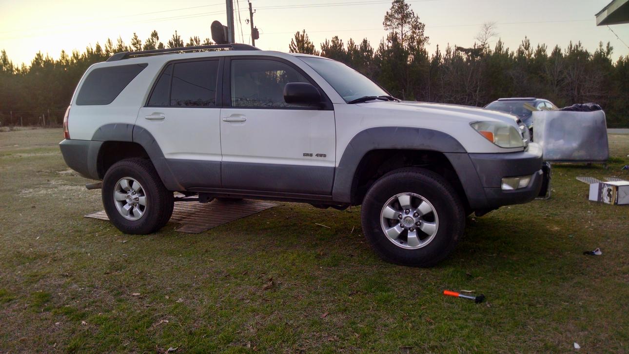

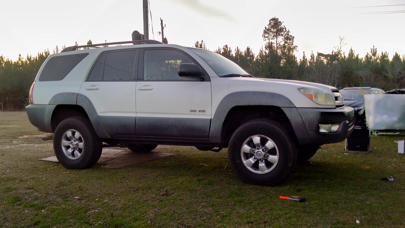

Bought my T4R roughly a month ago. Finally got the Daystar kit in. Alignment shop says I need lower control arm bushings. Hate to re-tear it apart. Took 4 hours solo.
Tires go on after the alignment is sorted out. Should be this weekend. Trying to decide on 265 or 285.. I just hate to loose the v8 power. Its my first v8 lol
Any tips or good links for control arm bushing replacement?

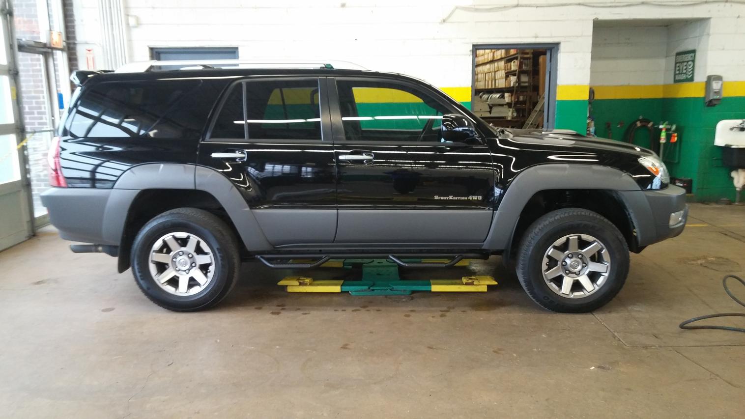

Daystar Lift-budget boost
So I just installed Daystar 1" Budget boost lift and had the truck aligned. Im looking to install a set of 1.25 spidertrax .......
do I need to re-align the truck after the spidertrax install??
JM
Looking good man! Very clean. You do not need to re-align the vehicle after spidertrax as you are not messing with the suspension at all.
